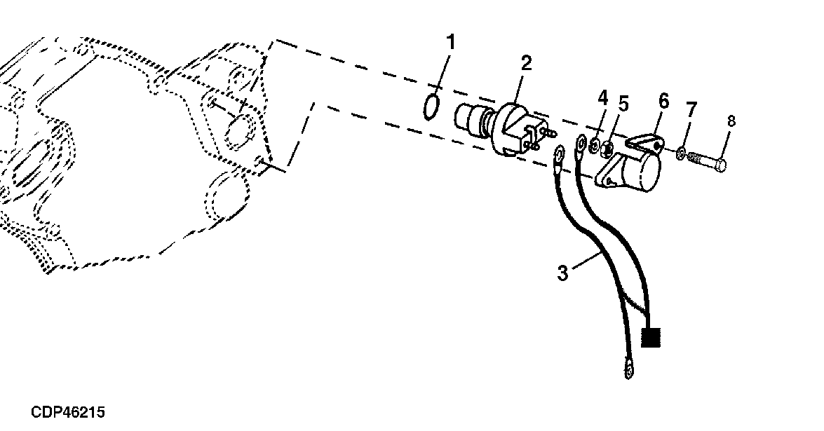

I traced the wiring as far as I could without starting to remove the hood and other stuff. I seen no damaged wiring, so I pulled off the spade connector that goes to the "W" terminal on the alternator. I think this feeds the tach. I then pulled Fuse 9 and put a 10 amp fuse into fuse 8 (the only size I had left to work with) and just moved the key switch between acc and ign just to see if it would hold. It did, so I started the tractor up.... and it did with the 10 amp fuse in place. Now I am begining to wonder if the wire with a spade connector on that was plugged into the "W" terminal belongs there.
   / John Deere MFWD 2355 Cab - Blown fuse issue #8
This is the sender(parts key #2) for speed-hour meter on engine timing gear cover.

Thanks Jim, but I am not sure I understand what you are trying to show me. Can the sender for the hour meter be causing my problem? Oh, maybe the black looking thing on the wire is the spade connector I spoke of above?

I traced the wiring as far as I could without starting to remove the hood and other stuff. I seen no damaged wiring, so I pulled off the spade connector that goes to the "W" terminal on the alternator. I think this feeds the tach..
This statement of yours "feeds the tach" is the reason I posted the parts photo of the speed-hour meter sensor and I think it's not your tractors problem. One thing I remember from studying JD utility cab tractor service manual wiring diagrams way back when I was a dealer service manager is the wiring diagrams resembles a ""spider web"!!!!!!!!!
