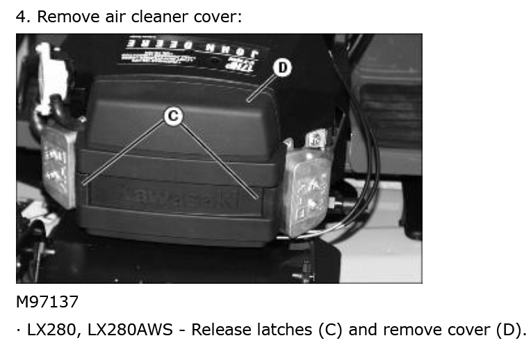

I just picked up a John Deere LX280 for my sister. It is -2F so I couldn't look for long, but how do you remove the air filter cover?
   / John Deere LX280 - How to remove air filter cover #2
I believe there cam over type clips that hold the cover on.
Thanks
This pic shows the two cam over type clips that hold the air filter cover on. Kind of hard to see with the hood flipped up but kind of blocking vision. Easy to remove, but the clips kept falling off when trying to put back on. Finally got it.
