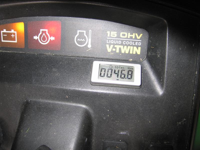

I have one and think it's a great machine. Well built, good engine, solid deck. It's a water cooled engine which is why I bought it. The one downside to the water cooled engine is that the way the pump is mounted, if the water seal leaks...the coolant ends up in the oil. When I bought mine, I took it all apart to clean and inspect everything and put in a new water pump, adjusted the valves, tune up and replaced the axle seals on the the hydro. Also installed an hour meter since they don't come with one. I have the 44" mulching deck which is built like a tank.

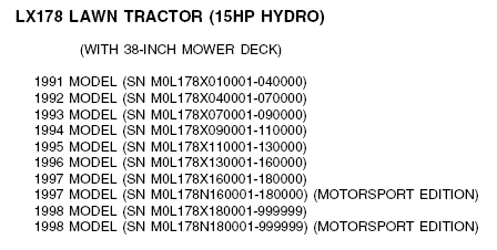

That price sounds high to me. The 178s are in demand considering some the current JD offerings below the X series. If it's in great shape I would grab it but for around $1500 or less. You can get the year off the serial number...see attachment. As for hours...who knows...I have no idea why an hour meter wasn't standard. Good luck.

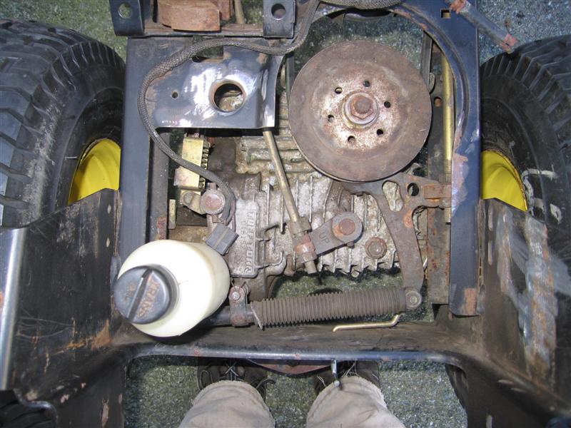

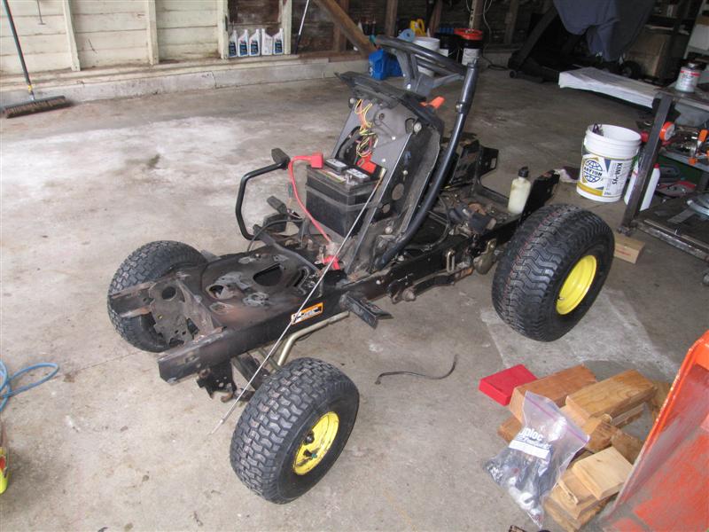

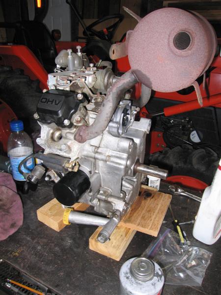

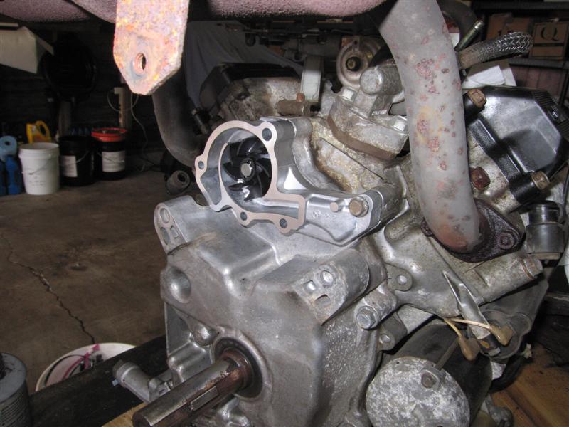

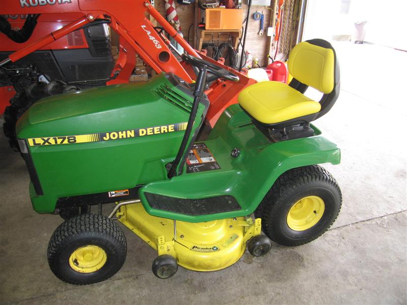

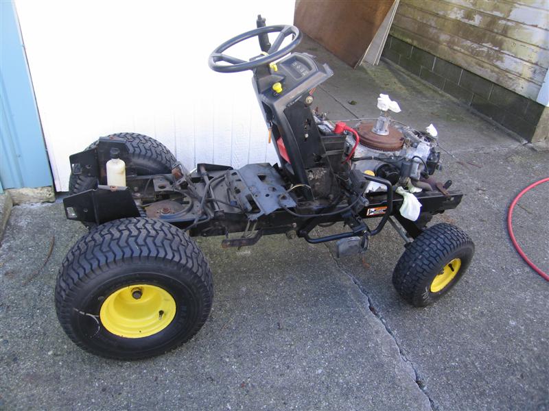

My LX178 is a 94 model. Here are some photos of what it looks like underneath. In one picture you can see the new water pump I was talking about. The frame is pretty stout too. I replaced the original seat with a newer style seat. It's more comfortable and breaths better but some people have said they don't last as long because they are more cheaply made...I believe them now that I compare the new seat to the old more closely...the vinyl material of the new seat is very thin compared to the old. Oh well.
The only problem I had when I was disassembling the whole project was removing the pulley from the engine shaft which drives the transmission belt. The pulley was seized on the shaft and my puller bent the heck out of the pulley getting it off. New pulley was about $20 and I made sure to anti-seize that piece real well. Other than that, it comes apart easy, is easy to work on, easy to get parts, easy to use. I'm a satisfied customer...and that doesn't happen very often to me. Most products I buy these day...even after researching them thoroughly...usually disappoint me in some manner.
