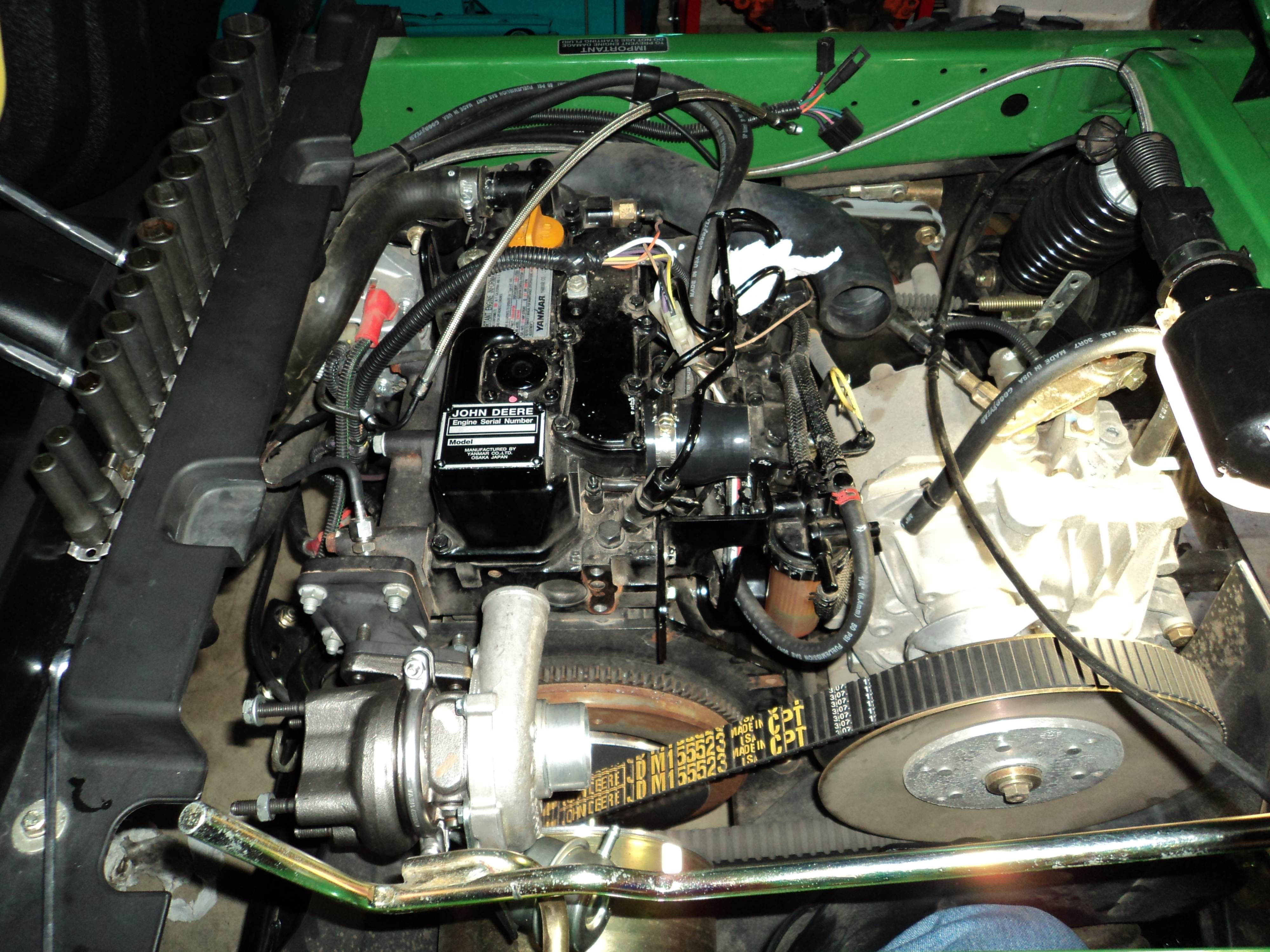

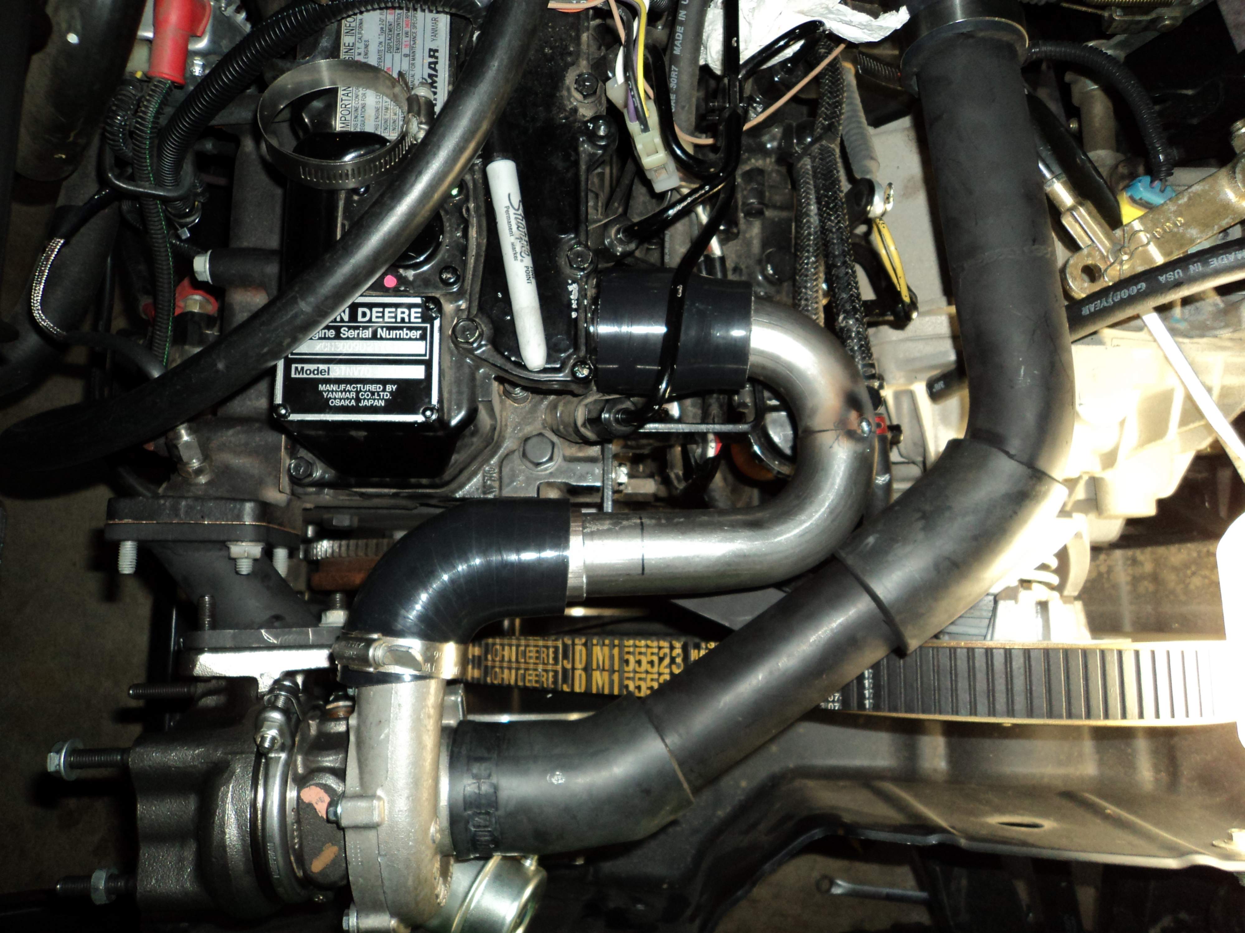

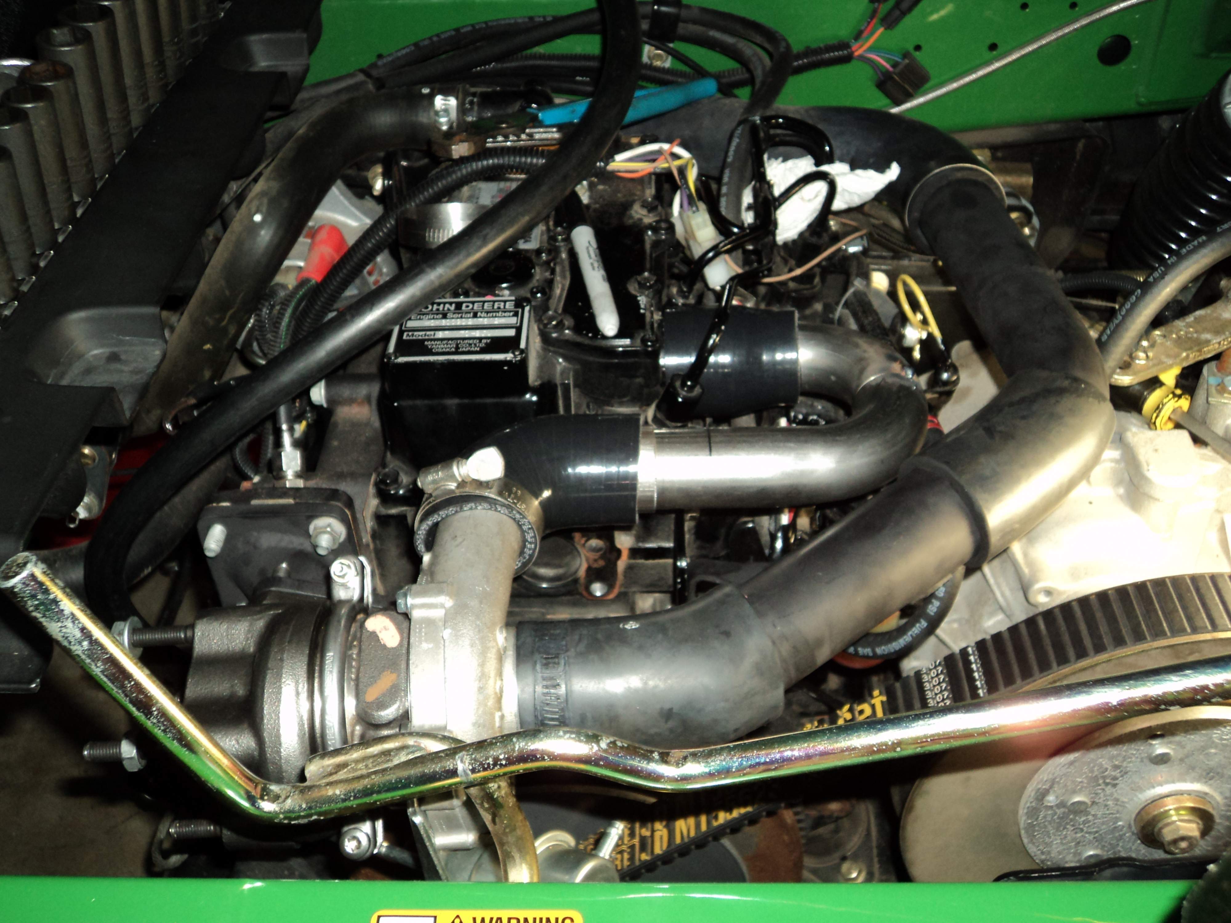

thought i'd share my project thats almost completed!

We've done a lot of 3 cylinder turbo work, would be curious to see how much boost you get.
Just looking at the turbo I think I have the answer.

big krank; i've talked to you before about some input wiht pumps i think it was. anyway the charger's a gt12 and i dunno wat my boost is, no gauge yet. i'll be installing that tomorrow when i get a fitting im waiting on. tonight i only poked it lightly around the yard and never jammed the throttle full so i haven't loaded it up yet to it's full potential; PLUS ill be needing to play with the fuel adjustment and rpm still...it JUST fired tonight. what do you suspect my boost to be?
   / john deere gator xuv 850D TURBOCHARGED #5
If it's a GT12 you may get a couple pounds, I thought it looked bigger and you would get zero. Hard to get any more w/o engine mods. You can tighten the wastegate up as it is set mostly for a gas engine.

That was my goal, not too much, I've heard from folks doin the same thing of gettin 7-10+...mu goals to be safe around Turkish side. Well find out tonight wen I gauge it. Seems to constantly spool!!
got my gauge installed; a bit lower than i expected by im not complaining, my goal wasn't to be a boost machine! sitting at 5 lbs. max comfortably. gotta feeling it's partly due to a rubbed down compressor wheel as the turbo was smoked when i bought it and i didn't buy a new compressor wheel when i rebuilt it; either way im happy with a low 5 psi! seems to plow through snow a lot better too, more guts and pulls nicely through the deep stuff!
