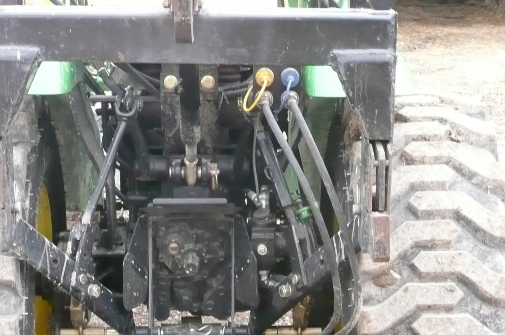

I got the mechanical diverter valve option on my 2720.
For those that have it, is there anything special on how to use it, other than just pulling it in & out.
The problem I am having is that it sticks & will not move unless I turn the knob a 1/2 to full turn. After I turn the knob, the rod moves in & out freely.

On the John Deere Sub Compact Tractors, the mower deck raises & lowers with the 3 point hitch. They have an option of adding an independent hydraulic lift for the mower deck. The lines for the independent lift connect the bucket control hydraulic outlets. If you have the loader on the tractor the same time as the mower, you have to swap lines to use the bucket or the or the mower. The diverter valve allows adding 2 more outlets to the bucket control side of the loader valve. The lines for the bucket & mower can be connected at the same time. The deverter valve switches the flow of oil between the mower & the bucket.

For me, I dont have a mower deck, I use my diverter valve for rear outlets for my pull type box scraper. Before the valve kit, I had the re-router kit. Four mounts on the rear and hoses that run up and plug into where the loader plugs in. Everytime I wanted to use the rear outlets, I had to remove the loader. Now, I leave the loader on, and flip the valve and that powers two of the four outlets on the rear. The other two, I just have the hoses tied up under the tractor.
Two are for raise/lower the scraper and the other two tilt.

Yes, there is a push/pull lever by your right heal. push it in and you have raise/lower of loader, pull out and you have rear outlets (on mine).

I have the diverter valve installed on my 2320 for the independent lift.
I noticed it was hard to engage and disengage when new but has since became easier with 60 hrs of use.
I normally work it a few times every time I run the unit to losses up the seals.
Also, it appears that if you have a high pressure differential in the lines, it may be harder to engage/disengage.
Try lowering your loader bucket or MMM when switching the diverter to relieve some of the pressure or idle down the throttle.
After a few cycles, it should loosen up to allow full, effortless functionality at all times.
