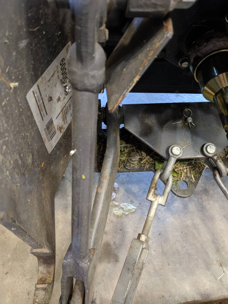

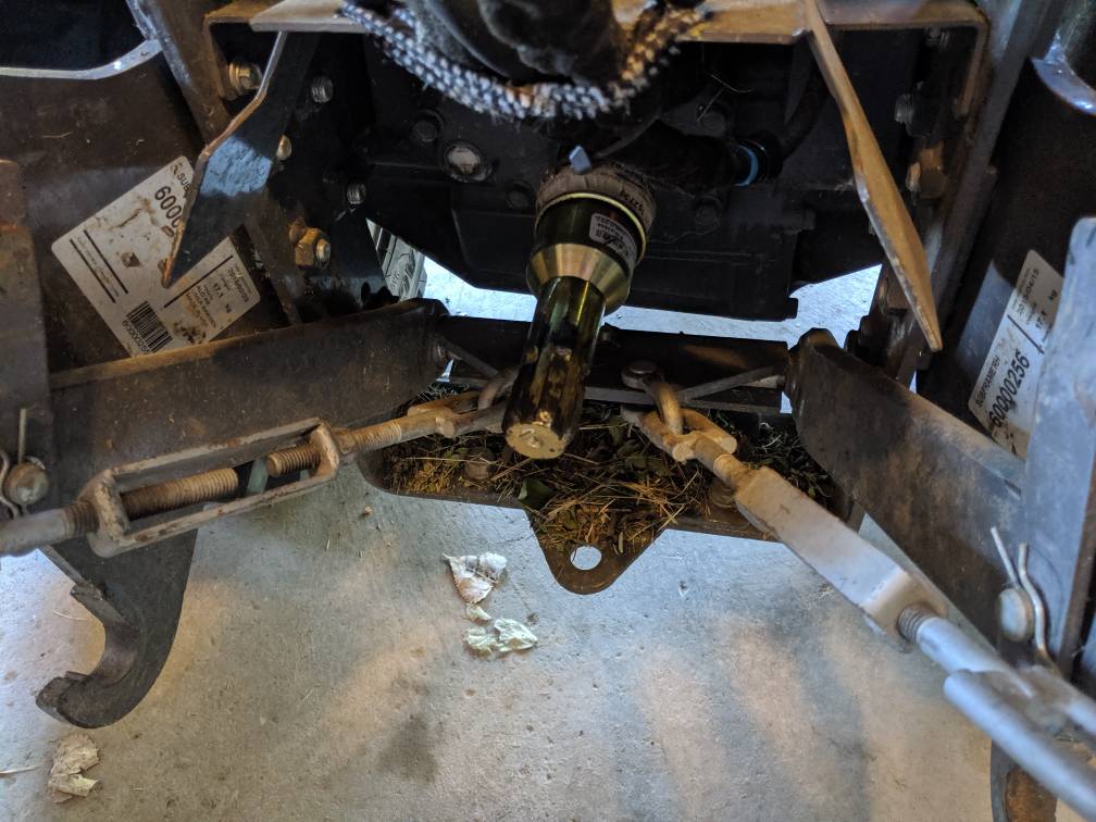

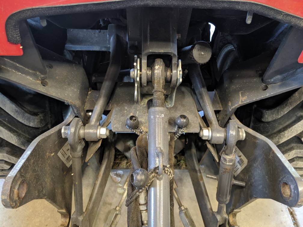

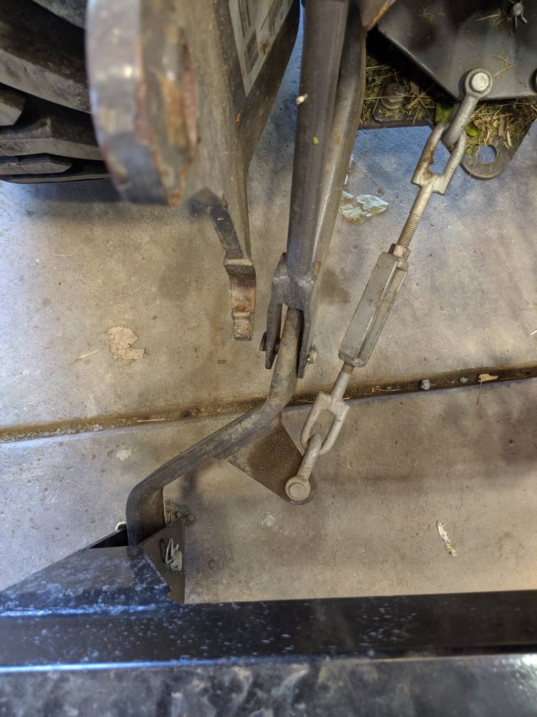

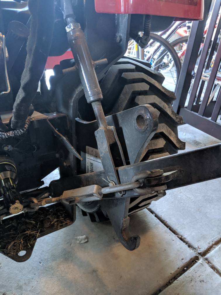

I've reads some threads on here about using a JD 5' 127 brush hog or equivalent on a GC 1710,light duty use,just picked one up,my Massey has a FEL,BH so I have never used the 3 point,any idea what lenth arms or links to use for the brush hog,need to go buy some.Thanks

I actually use a JD 5' Gyramor 205 on a GC1710 for more than just mowing grass... I've taken down 2 and 3" tree/saplings. If your referring to the 3pt arms/linkage it should have been included with the purchase of the tractor. Massey Ferguson/AGCO ships them with each TLB machine. Mine was folded up between the backhoe and the tractor upon delivery.

I bought it used,its 2 years old,no arms came with it

Here are pictures. I would strongly recommend speaking to the seller and seeing if they have the arms or speaking to a dealer. The setup is a lot more than just the arms with turnbuckles and particular bends to get around your backhoe plates and still function. That said it's about 14 1/2" from tractor pin center to the first sharp bend, about 6 3/4" bend to bend and about 3" final bend to center of the end ball. Top-link is a standard Cat1 limited top-link. The hard part will be the turnbuckle plate and the buckles in the right spot. All told it's pretty tight quarters once you run you PTO shaft in there. IMG_20190905_175153.jpgIMG_20190905_175200.jpgIMG_20190905_175205.jpgIMG_20190905_175210.jpgIMG_20190905_175426.jpgIMG_20190905_175430.jpgIMG_20190905_175436.jpg
   / John Deere brush hog on my GC 1710
Oh,wow,I thought they were just like a large tractor,just a couple adjustible bars,thats a whole different deal,thanks for the picks,I'm a welder fabicator,my buddy has same tractor,maybe I"ll borrow his and copy,thanks a bunch
