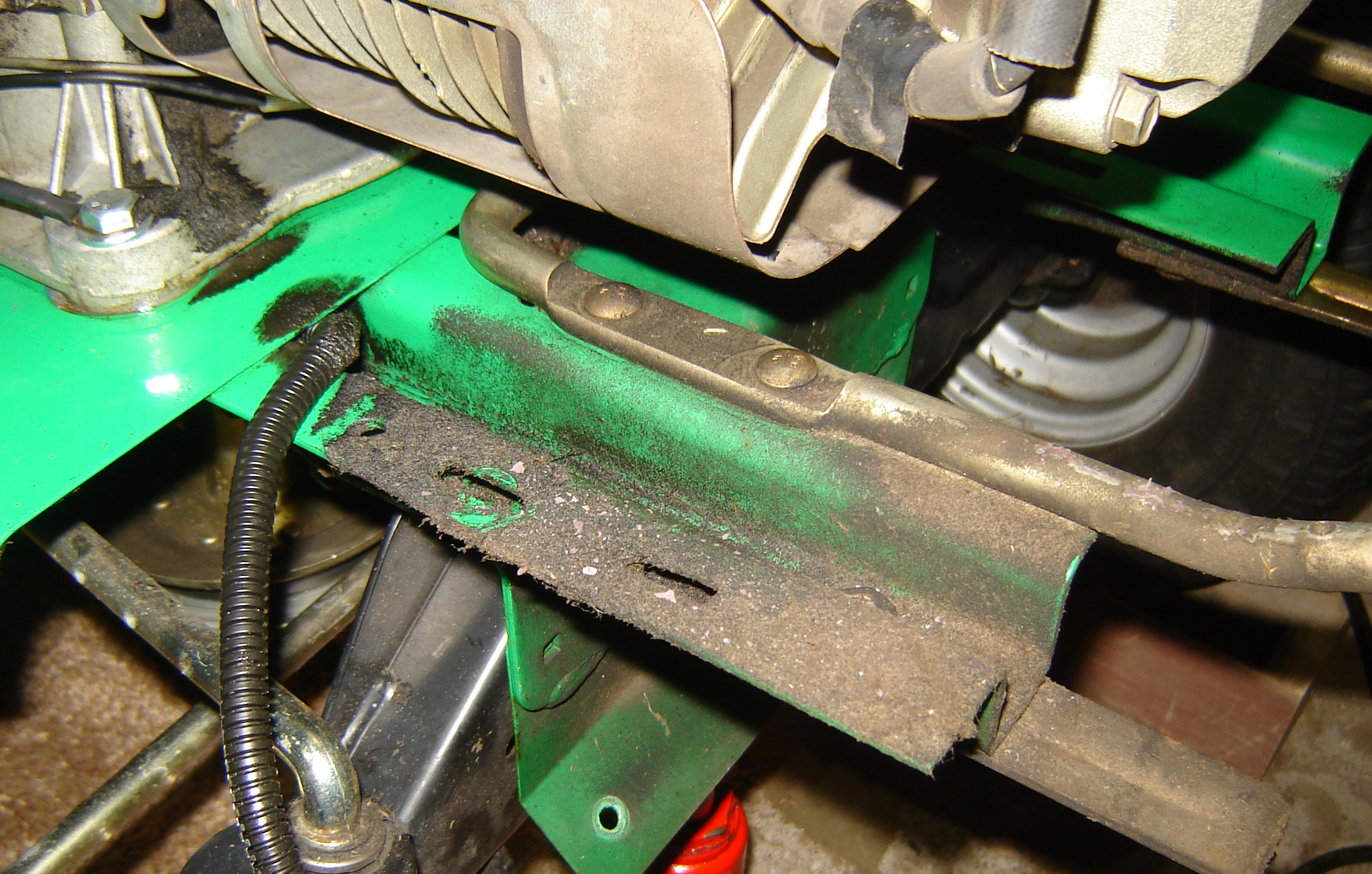

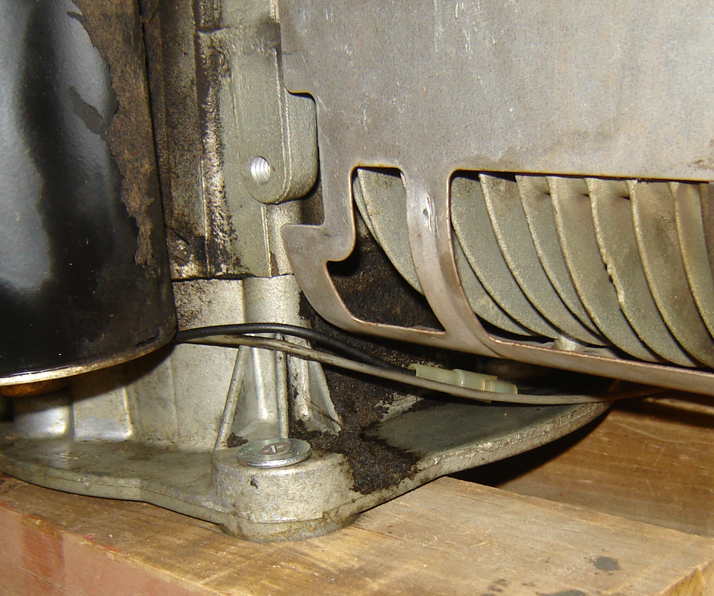

So, I have made some progress. I removed the engine and have moved it down into my basement workshop so that I can more easily work on it. This allowed me to move the tractor back into my storage shed so that now I can get both cars in the garage. So I have looked the engine over pretty well and I think that it looks like the oil has been coming from the right front of the engine sump (right front as your sitting on the tractor), at least that seems to be where most of the oil is on the engine and the tractor frame (see pictures, keep in mind that these pictures were taken after I had cleaned much of the oil off).
I think the oil was maybe getting down into the frame of the tractor and seeping through that frame member (it's kind of U shaped) and then dripping onto the belts and that's what has caused all the oil getting under the tractor. It doesn't really look like to me that the main seal is leaking. I don't have a picture of the underside of the engine, but it looks pretty clean to me (for a 22 year old tractor). Also, the area of the tractor where the engine sits is fairly clean as well.
So maybe all I need to do is replace the sump gasket? Any thoughts? Is there anything else I should be looking at? Anything else that I should replace while I have easy access to the engine?

So you have a pattern of oil above the sump as well. Air cooled engines can be tricky that way. Even your leak from your drain and dipstick tubes can migrate to places you didn't think could. If you feel that the sump gasket is leaking, you need to know if the sump bolts had come loose. If they had, it makes these difficult to reseal and stay that way. Many of these did that.
