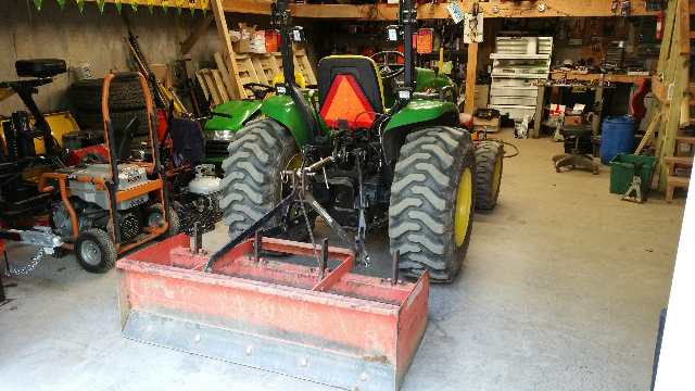

I used the JD black paint on my 4300 and it looks great.

I used the JD black paint on my 4300 and it looks great. TY25609
