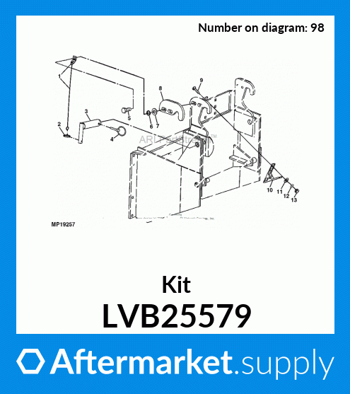

I have a JD 4510 that I want to hookup a BH48 Back Hoe, my rear brackets (those that bolt to axels, bolt up fine). The front bracket JD LVA11361 won't bolt up because the holes ( on the bracket are spaced to far apart). Is the a spicific bracket for my 4510 Utility Tractor? Y john Deere Dealer told me I have the correct bracket but it dosen't fit my tractor. Appriciate any help on this....and thanks

Perhaps you could provide some pictures. You might have to modify your brackets.

loggin, many thanks for your response. In more research, my BH48 Back Hoe came off a 5105 Tractor. All the brackets are completely different as well as how they mount up. To make my BH48 Unit work on my 4510 Utility Tractor i am going to have to find bracket LVB25579 that will hook up to my axel brackets (plates) LVB25568. In searching internet the LVB25579 is not to be found, unless someone has one laying around. Anyone that has the LVB25579 I'd like to buy it. Many thanks for all your suggestions/help.

After more research here’s what I need ( John Deere dosent have part).
I need a Weldment Bracket LVB25579 that is attached to JD48 back hoe, this bracket hook up to my 4510 Tractor. After extensive search JD has discontinued this bracket, so I need one that is used. The drawing in the post showed what bracket looks like.
I’ll pay top price & freight for this bracket.
