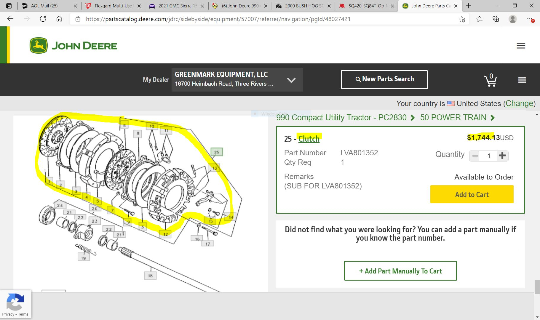

I have a 2004 JD 990. I am the second owner and have had it for about 13 years. I put about 2 hours a month on it mowing a 1 acre pasture and putting out (3) hay rolls every few weeks, it's total hours are 650+/_. About 7 years ago I had a mobile guy come out and replace something regarding the clutch, I want to say a pressure plate and throw out bearing? Fast forward to last week I started to notice that the transmission wasn't engaging until the clutch pedal was almost all the way up. I had it hauled to a local JD shop and it was able to get onto the trailer under it's own power but weakly.
The diagnostic summary reads "drive only engages in A range, on concrete, at idle, at the end of the clutch pedal range. In other ranges it would move but slip". This was my experience but I was able to get it to move in any gear range and it was more reliable in reverse. Furthermore they said "attempted to adjust clutch linkage however it appears to be at the end of it's adjustment" and "upon complete inspection anchor point for clutch pedal spring is almost rusted through". It's Florida...everything rusts.
The suggested solution is "split tractor, remove/replace clutch, throw out bearings and related components".
So far I am sorta of okay with the diagnostic summary, stuff breaks or wears out, but the estimated cost is almost $4,500.00 I feel is a little much when people I know are paying 1K less for larger, non JD tractors. I was able to get them to reissue an estimate that broke down the parts and the estimated hours to complete the job. I have few questions I hope some of you here might be able to answer.
1) Is $4K + a bit pricey for this job?
2) The estimated hours required is 17.5 hours at $105 per hour. Does this seem like alot of hours? It usally takes this shop to get your tractor back to you after 3 weeks have passed.
3) The clutch is priced at $1,744+, I am assuming this is direct from John Deere and sold as OEM, but wouldn't Yanmar parts also be considered OEM since my tractor has a Yanmar plate?. I see the same clutch offered from online sellers, as new aftermarket parts (though no aftermarket manufacturer name is listed in the ads) for a much as 1/3 the price. Is there a catch? Is there an issue buying New Aftermarket replacement for $500 +shipping? Is there an after market manufacturer that has a good reputation for quality parts?

I don’t know anything about a 990 but based upon the general size of the tractor I can’t see it taking a pro 17 hours and can’t wrap my head around the clutch costing $1,700. I put a clutch in my 950 for a few hundred bucks. Can’t say what I had in the way of time as it was part of an engine overhaul. I would say 8-10 hours for these smaller tractors. Maybe I’m wrong though.

It does sound like the clutch is worn out, since it can not be adjusted.
$1744 is list price for both traction clutch and PTO clutch and covers/plates shown.
I do not know if these are routinely replaced or must be replaced.
There will be other parts needed too.
Labor hours seem about twice what I would guess.
