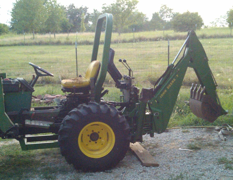

Can you add a mid mount mower (6') to a JD 955 equipped with loader AND backhoe. One for sale with a loader (JD 70A) and backhoe (JD 7) plus a parts tractor that has the mid mount mower and 3 point hitch but no loader or backhoe mounted. Can they be combined? Wish I had photo's but a friend is buying the combo and I'm not familiar with the way the deere backhoe mounts.

What I want to know, and am unable to go look at myself, is whether the BACKHOE FRAME allows the mower to be used. I do know that the loader frame is not an issue, that is easily found in online literature, but as for the backhoe frame ......... I even know what can be done on later model John Deere and Kubota models (mostly no)
Can't even find an example for sale that has a loader-backhoe-mower combo. So, my question remains.

BTW - I finally found one locally, with the backhoe, that I could take a peek at (but only from a distance). Unless the side supports come off with the backhoe I don't see that a mid mount mower would clear them. I could be wrong, but wish someone would confirm that. :-(

If it helps any at all. I had a woods backhoe with sub-frame on the 755 and 855 and that didn't interfere with the mid mount mower hardware. You had to drop the backhoe to install the mower but for 99% of backhoe work you wouldn't want a mower hanging there anyway.

I grabbed a couple of images off this site so you can see what I think the problem might be. Unless the mower mounts lower than I think I don't see enough clearance under the frame. It may well be a mute point, since it seems that the purchase is going to be made in a few weeks. Guess I will find out then, assuming he can get a deal on the parts tractor. He has already made an offer for the 955 with hoe and is just waiting to have time to pick it up. Plans to try to get both if he can confirm that the mower will fit - might just try it on the spot.
