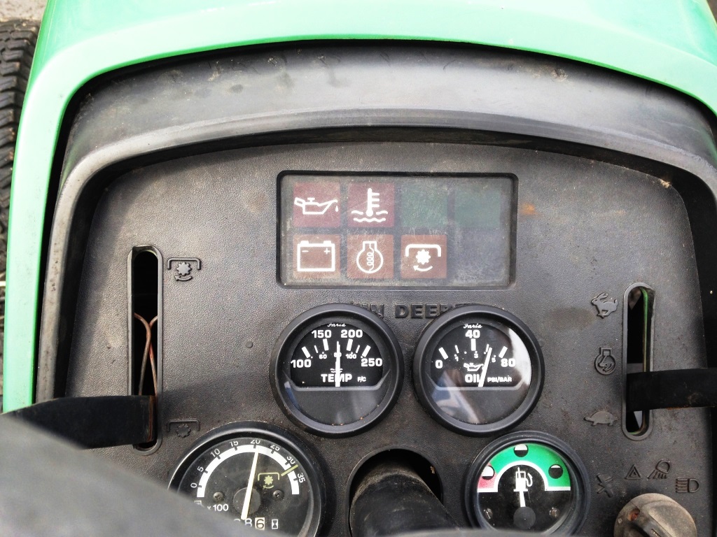

My latest project was installing these gauges in my 955. They are Faria Marine gauges.
I am very happy how they turned out.

How did you conect the gauges? Did you use new sending units in place of the old one or could the old ones work with gauges? I haven't looked at my 855 to see how much work it would be but I think this is a great idea. I don't like the idea of using a light that could be out to tell me something is wrong.

How did you connect the gauges? Did you use new sending units in place of the old one or could the old ones work with gauges? I haven't looked at my 855 to see how much work it would be but I think this is a great idea. I don't like the idea of using a light that could be out to tell me something is wrong.
I used new sending units. the oil sending unit was quite big, so I used the oil port towards the front of the motor. The water temp sender went in to the right of the original one. I will post pics today to show you where.
So, my idiot lights are still connected.

I want to do a similar gauge install on my 955. Is there plenty of space to install the 2" gauges or did you have to displace things behind the dash? where exactly did you mount your sending units? Thanks
