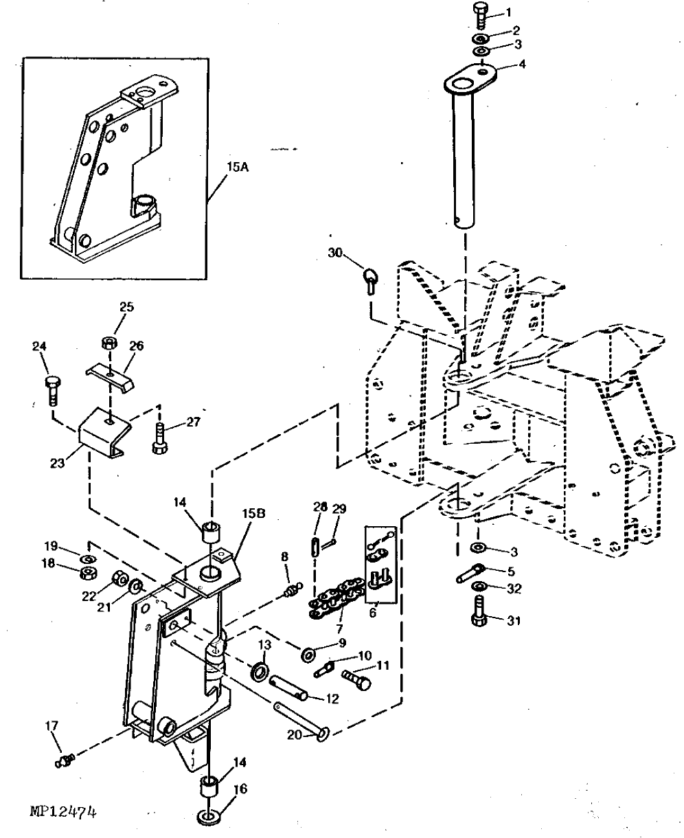

   / John Deere 8A backhoe #8
The swing frame has replaceable bushings in it. Looks like the early models had a 2" bushing which was then increased to 3" with later serial numbers:
The lower boom has no bushings, just a replaceable pin.

Parts book got here this afternoon. Looks like the swing boom will be easier than the lower boom. Looking at the lower boom this afternoon. Think I'll end up air arcing off the 2 outer mount points at the welds, make new ones, weld on one side at a time to maintain alignment. Welding up the bores on these small holes ( 1 3/8" ) would have not been much fun. I'll run a reamer through the inner 1/4" bigger, bush back to size with hardened bushings. Should last longer than I do with some grease every once and awhile. Swing boom should be less than a days work. Think I got a good deal on this one because it had been used hard without any sign of grease used. Should end up being more than worth the time invested. Thanks,

   / John Deere 8A backhoe #10
You might get lucky and find that you just need to replace the swing & boom pins. At least the swing frame has replaceable bushings. It's possible that due to the BH being built without replaceable boom bushings the pins, not being hardened are very worn. You'll find out as soon as you take it apart. If the pin bores are worn, again I'd have it bored to press in some HD bushings. 1.625" is a standard size and you'll find a good selection of replacement bushings available. I'd suggest you look at Meritor E-5446 bushings (used in kit #R200267). These are part of a truck king pin replacement kit @ 1.625" I.D. and they will take a beating. Here's a link to a DMR bushing catalog with some info you might find helpful:
