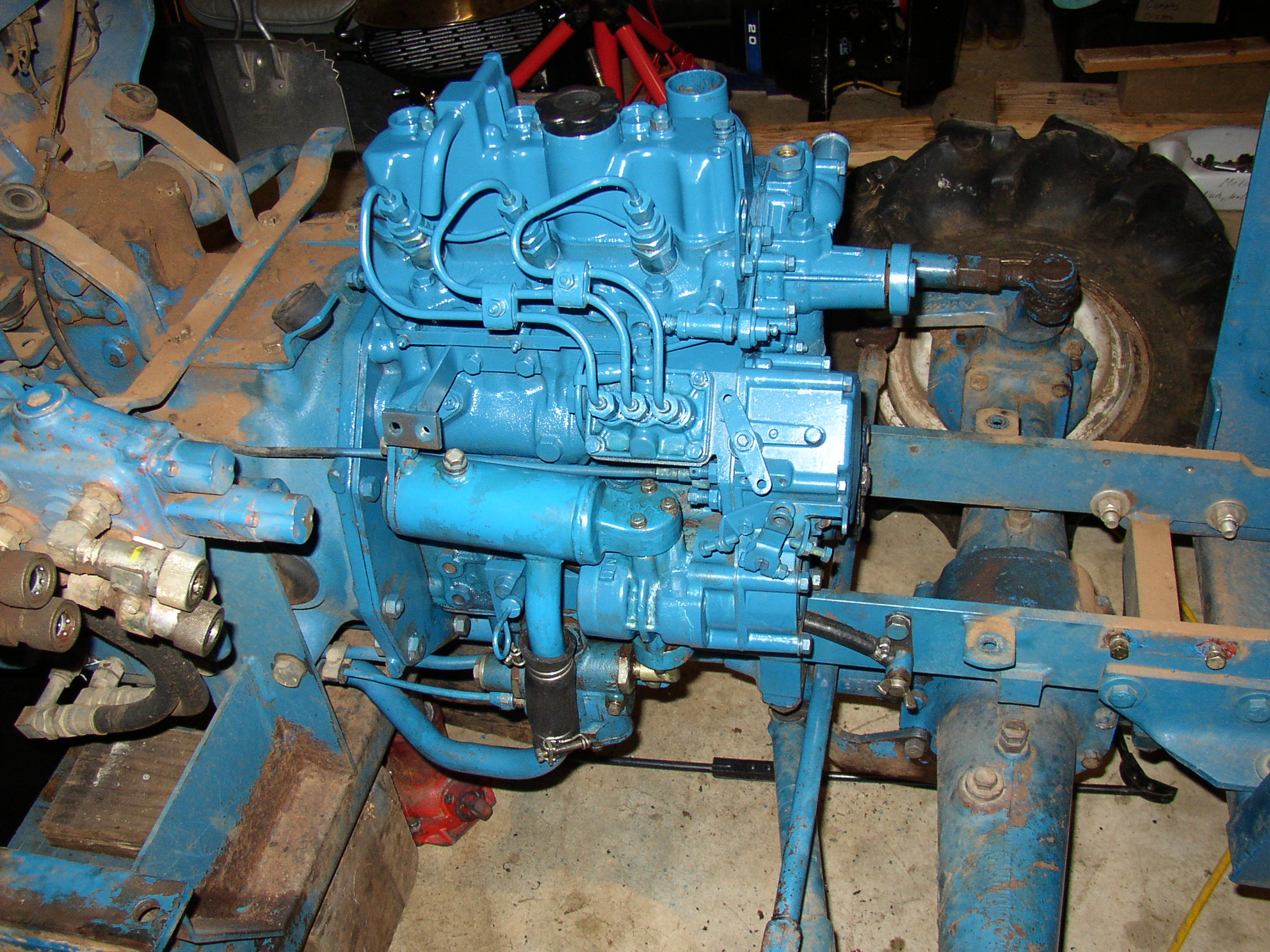

When I bought my Ford 1310 back in 1997 it had very similar, but lesser degree excessive blow by and the engine ran fine, no oil / coolant was getting mixed at all and oil consumption was not excessive.
Since the tractor was new to me I had nothing to compare with as far as engine loss of power, so I ran it for 9 years like that without knowing better but the "blow by" was slowly increasing.
Long story short:
After I removed the cylinder head in 2006 I discovered blown head gasket, but the odd thing was there was no leakage externally or into the cooling system!
Instead it was blowing most of the middle cylinder "compression" into the crankcase through opening in the block where the push-rods are.
So in essence it was likely firing only on two (maybe 2 1/2 ??) cylinders and the middle cylinder was mostly just pumping air and some fuel down into the crankcase, which caused the excessive breathing from the vent tube!
I cleaned up everything, installed new proper head gasket and now 15 years later the engine still purrs like new (1000 hours on now) and never needs addition of engine oil.
Hardly any noticeable breathing from the vent tube.
Wish I had photo of the blown head gasket, but this is all I have:
