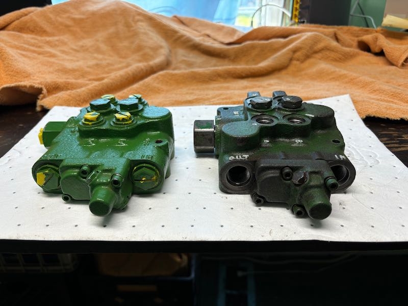

You guys helped me put p/s on this tractor in 2020, I hope you folks can help me with the SCV valve.
The SCV on my tractor is made by Dukes Fluid Power, #1627 AN, JD original part #RE 19910, revised # AM 107083. With Power beyond (PB)
This valve was used on 850, 950, 1050. Dukes sold to Sauer, who sold to Danfoss, then sold to QCC. I have been searching for some time for a replacement, new or used, QCC sent one to me, but the "in" and "out" ports were 1/4" instead of 1/2", also the ends on the spool valve were different, and the PB was Different. They said that was the best they could do, as the part was obsolete. They were very helpful, and graciously took it back.

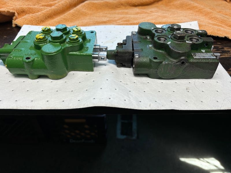

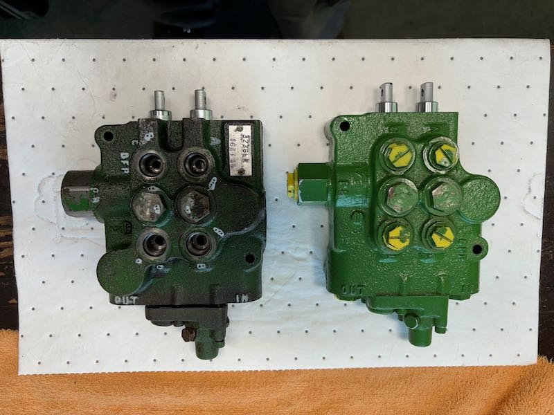

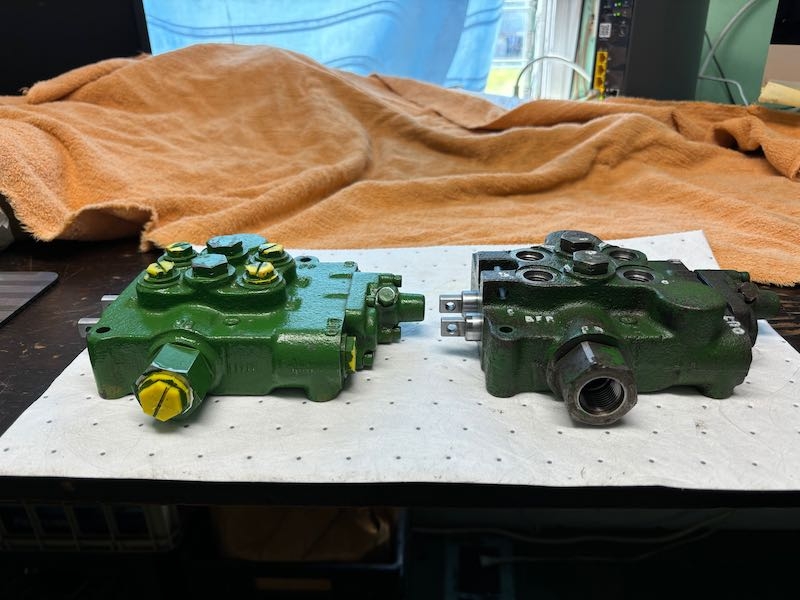

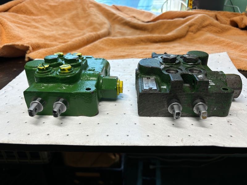

I have located a (nos) Dukes 1627 FY, does anyone know the difference between 1627 AN, and 1627 FY.
The differences I see:
#1- On mine, there is additional casting material near the outlet port. Could it be a bypass passage for the float position?
#2 - On mine, on the spool end, there are 2 cast bosses with a hole drolled thru, next to ports "A" and "C", these holes are not used in my application.
#3 - On mine, there is additional casting material under the data plate. The data plate on the new valve is on the other side.
Thanks for your time, and any help would be greatly appreciated, also any salvage yards I can call.
Thanks, Mike

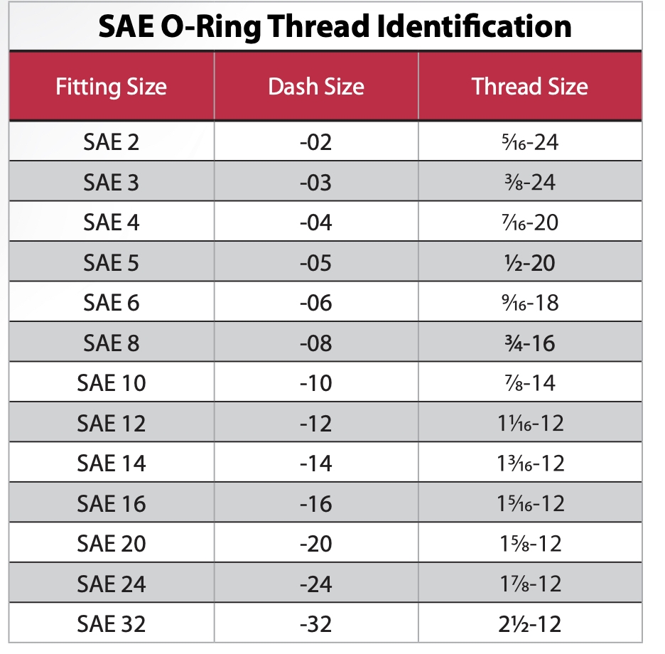

From the looks of our photos, your old loader control one use SAE O-Ring Threads.
The measurements you took for thread type & size don't seem right. Best check them again.
I'd guess your IN & OUT use #10 SAE O-Ring (7/8x14 parallel thread)
And the cylinder work ports probably #8 which is 3/4x16.
All SAE O-Ring is parallel thread. NOT plumbing pipe tapered threads.
BTW, If you find the Control valve you want and the port threads are not right, you can always use hydraulic thread adapters. Adapters add a little bulk, but not much, and sometimes have handy features like swivels. They aren't expensive, and are made to adapt between most every hydraulic thread and fitting that exists.

Hi Scotty,
Thanks for your reply. My old valve was unusable due to internal rust in the check valve housing opposite the end with the exposed spools. the springs and check balls are badly pitted. I have not been able to locate how water is getting into the system. All the shifter boots and seals appear to be in good condition.
The only new valve I could find was from QCC. This valve is obsolete and NLA. They tried to match it with what they had.
Please read my original post again.
The purpose of the post was to find out the difference between the AN and the FY before I committed to buying the 1627 FY, because there are some physical and visual differences.
Fortunately for me the owner of the NOS. valve was willing to let try it, and return it if it didn't work.
Long story short, it did work, and it does have the float detent.
Thanks for your reply and input.
