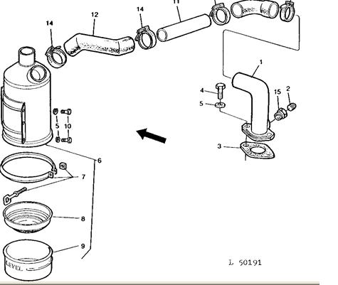

Mar 23, 2011 / John Deere 820 oil in air filter #1 S slotoro New member Joined Apr 21, 2009 Messages 21 Location Arnaudville Louisiana Tractor Kubota L4240 I just acquired a John Deere 820 tractor. There is a cup on the bottom of the air filter that had oil in it. There is even a marking on it that says "Oil Level" Can anyone tell me what this is for?

Mar 23, 2011 / John Deere 820 oil in air filter #2 B beenthere Super Star Member Joined Aug 16, 2001 Messages 18,519 Location Southern Wisconsin, USA Tractor JD_4x2_Gator, JD_4300, JD_425, JD_455 AWS, added JD_455, JD_110, JD_X485(sold) I believe that is to bubble the incoming air through the oil bath to collect dust, etc. That is the air filter. This the 820 compact, not the big 820 2-cyl diesel? Attachments 820_air_filter.JPG 24.5 KB · Views: 400

Mar 23, 2011 / John Deere 820 oil in air filter #3 A art Super Member Joined Apr 10, 2000 Messages 6,798 Location central New York Tractor all makes and models Older cars as well as tractors had oil bath air cleaners!!
Mar 23, 2011 / John Deere 820 oil in air filter #4 J jenkinsph Super Star Member Joined Feb 27, 2008 Messages 12,567 Location somewhere usa Tractor Deere 110tlb, 4520, x749, L130 I guess some of us are getting old? Just not used to all the new whippersnapper newfangled dry type air filters.
