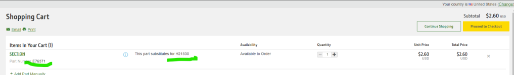

John Deere 800 Swather Sickle Sections, can't find a cross reference for the part number I have on the machine. H-21530 on the sections and E-48093 rock guards. I can find the guards no problem, but the sections, not so much. I don't have to have John Deere sections, but I would like American made. Just looking for a part/parts number to buy via eBay, I've had really good luck in the past buying NOS sections. (IH, Herschel, New Holland) Also, if any of you have any recommendations of serration type to use for hay. All of the sections have been sharpened waaaaaay past usefulness with no evidence of serration type. This machine, kind of an odd size (9ft) was used for cutting mint. Yes, the leafy green herb known as mint. Who would have thought?
