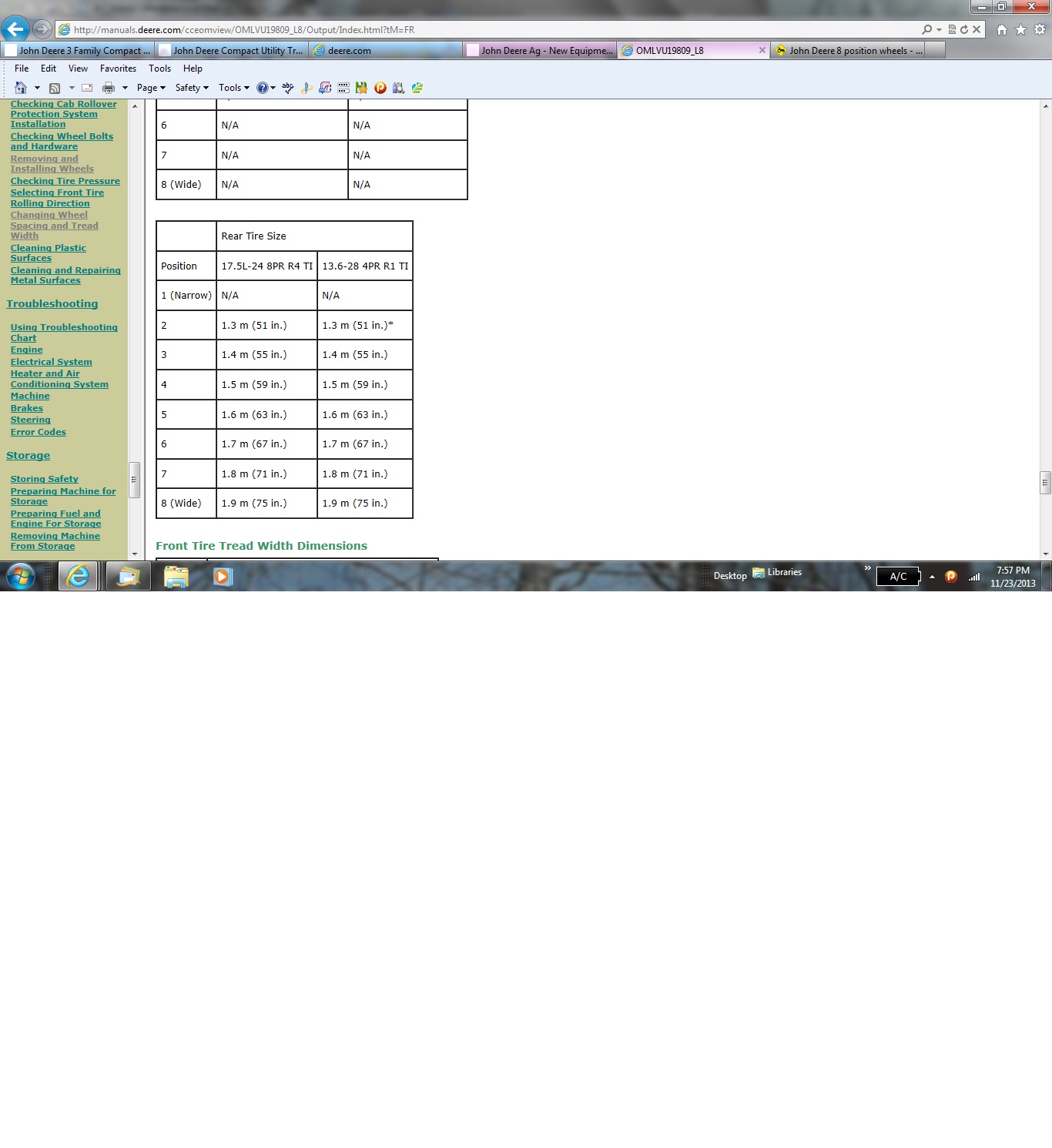

I'm looking at a JD 3520 tractor . I presently have a JD 1020.
I'm on hilly ground and need wide spacing and I would like to know if the 3520 comes standard with the 8 position rear wheels . The tractor will have R4's .
according to the online manual (Manual OMLVU23778) the wide position is 75 inches. I' assuming they're measuring center to center.
Any info on width would be helpful
Thanks

Jd's "build your own" site will tell you what comes standard. 75" is center to center on the front and it would be 71.1" in the rear which puts them in the same wheel track. Tire width being the difference.

The info I get is this is the standard equpment although I've never seen this setup on a lot
7-14 6PR Front R1 Bar 2 Pos.
11.2-24 6PR Rear R1 Bar 8 Pos
I can't seem to find dimensions there
If I go here
OMLVU19809_L8
and scroll down to select - Changing wheel spacing and tread width I can see the dimensions
I also see dimensions for R4's and others
So I can assume if I'm looking at a used 3520 unless it has R1 it probably doesn't come with the 8 position wheels

I think it can. The rims have two sets of mounting lugs. That's two positions. They can be attached to either the inside or outside of the wheel. That makes four positions (granted, two of those differ by only the thickness of the wheel, maybe 3/8"). Then the wheels can be mounted either dished in or out. That makes eight positions.

All true, except often the narrowest one or two settings can't be achieved due to insufficient fender clearance on many tractors. No experience with 3000 series Deeres.
