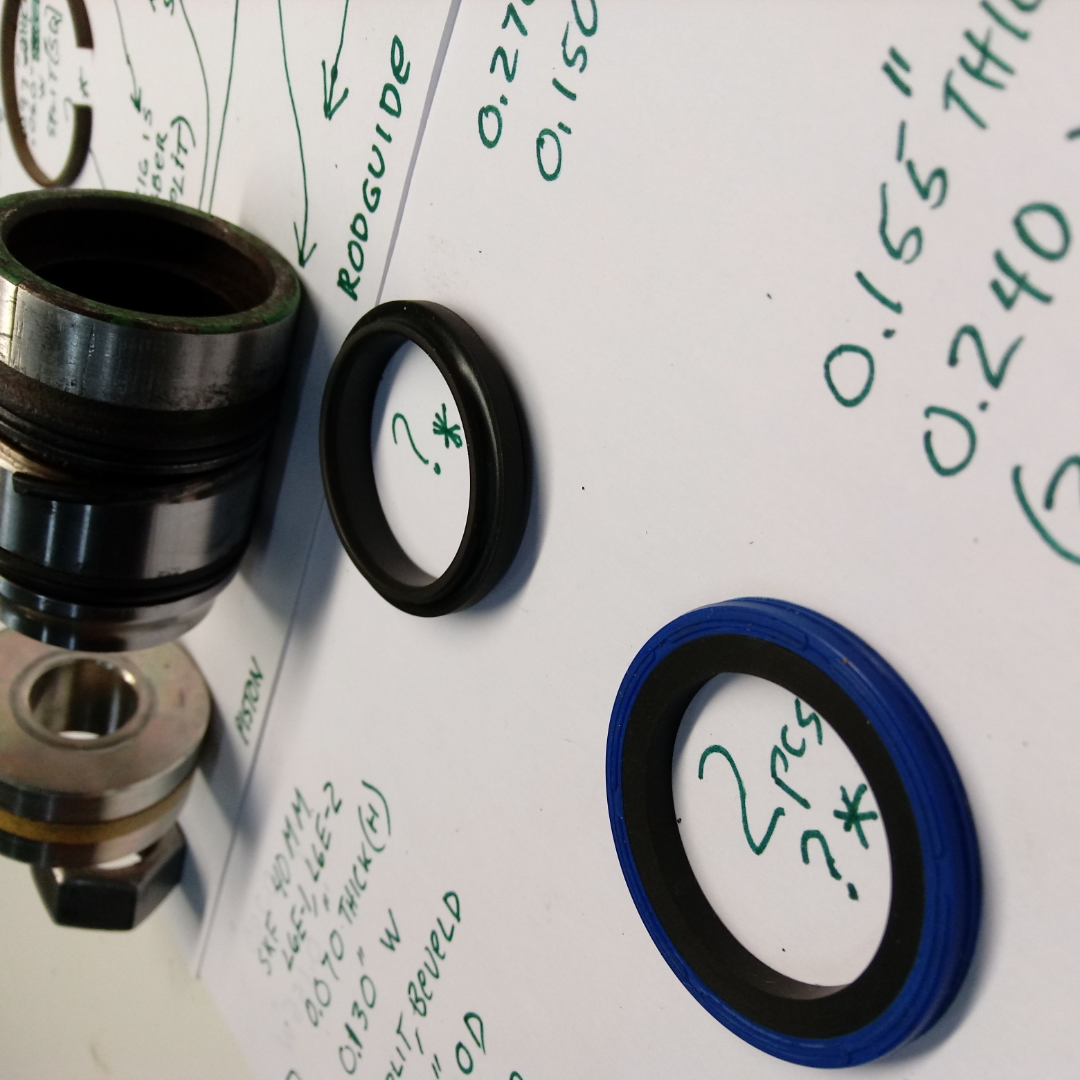

The 300 loader bucket cylinders on my 790 had some leaking going on for a while. One got much worse. I researched rebuilding myself. I've done steering racks before so I opted to tackle this one myself.
My JD dealer about a hour drive away told me the AH176655 seal kit has been superseded to AHC17687. I went there the other day and bought 4 kits, 2 for now, 2 for spares when the boom cylinders act up.
I got the cylinder apart and removed the rod guide inner seal and outer seal. The AHC17687 kit does not have those 2 seals, but several others that don't match any of the seals on either the Bore or the Rod. Earlier today I discovered that the AHC17687 is only for the Bore, and AHC16981 is for the Rod. I ordered 4 of those kits today from HW. hopefully get them by Weds or Thurs.
However, can you help me identify what the "?*" seals are in the following diagram? JD Parts website is no help. Maybe they're for other cylinders.
These are plastic, split. Unsure where they fit.
Where would these go?
Thanks,
Rich

Back to the details.... I've learned a lot about how the parts system works at JD. It appears that the Bore Cyl rebuild kit(bought 4) covers other cylinder applications also. Now I see why the original seal kit got superseded. More money for JD. Of the 11 pieces in the kit, it looks like 4 or 5 are used for my 300 cylinders. 3 o-rings, the piston seal, and some form of replacement split square profile ring for the rubber NON-split square profile ring on the rod guide. Crazy thing about this part is I think it's just a side spacer for a very thin o-ring. Maybe even a fix for a design or machining error on thousands of guides. Another oddity is that this replacement split ring piece isn't as tall as the original so it has no sealing functionality at all.
So....what great parts value. $60.34 for the kit, mind you times 4, and 3 of 5 parts I likely could've gotten at ACE Hardware for about 3 bucks. If I knew then what I know now, I should've just ordered a handful of orange removal rings from HW, 4 piston seals, and reused those funky rubber NON-split square profile rings. Would've probably saved about $200. Hmmm, I may just return the 3 kits I haven't opened yet and do just that! And on TOP of all of this, there's a separate kit for the Rod with the 2 pieces I lost brain cells over at the beginning of this entire fiasco, trying to find which new pieces in front of me replaced them. Well, they were never there as I found out yesterday.

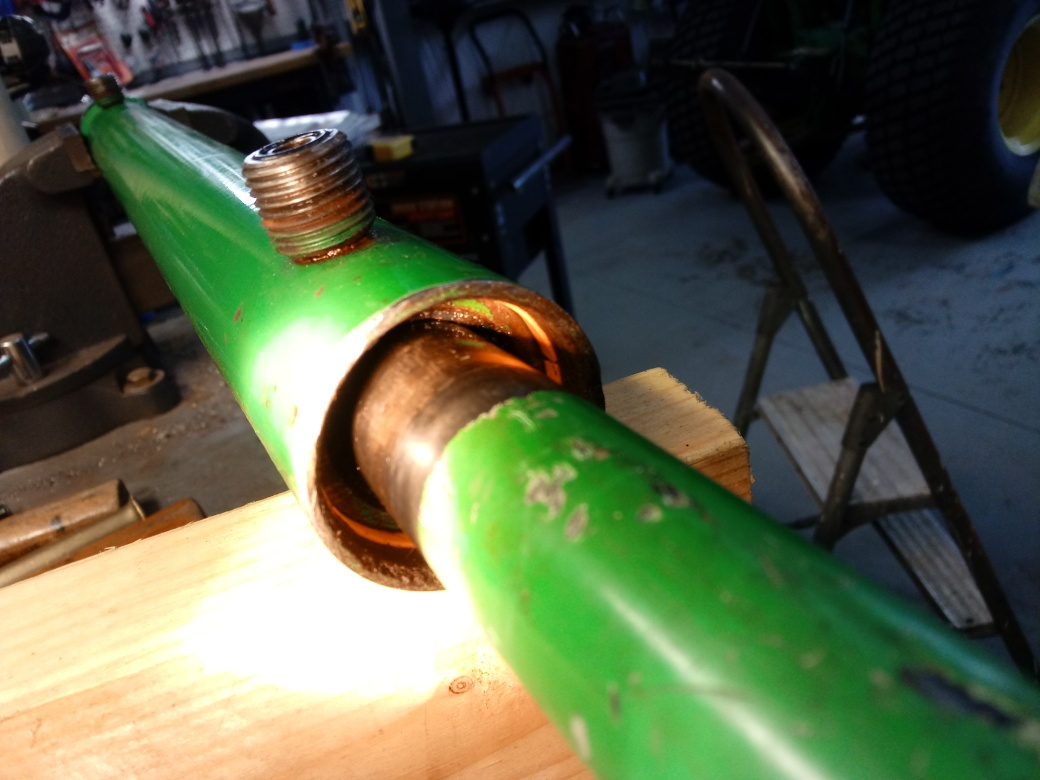

After removing the outer C-Clip, The gland could not be driven inward, even after soaking with penetrant. I had to use a large pipe wrench to get it to turn slightly. Then I had to file the outer gland where the wrench marred it so it could get past the cylinder opening.
Using a brass drift, alternating around the gland, I was able to finally drive it inside the cylinder. I cleaned the area and added more penetrant to help removal. Then I was able to install the removal sleeve. Note the thicker edge must be outward. I acquired some extras that had to be cut. Try to cut them so they are edge to edge tight in the inner circumference of the ring groove.
Now I tried to pull on the rod but the gland was now blocking the fluid port and it couldn't be pulled as air pressure was now built up inside.
I rigged up a makeshift air hose to the opposite port. After some hammering on the knuckle end with air applied, it fianlly came out.

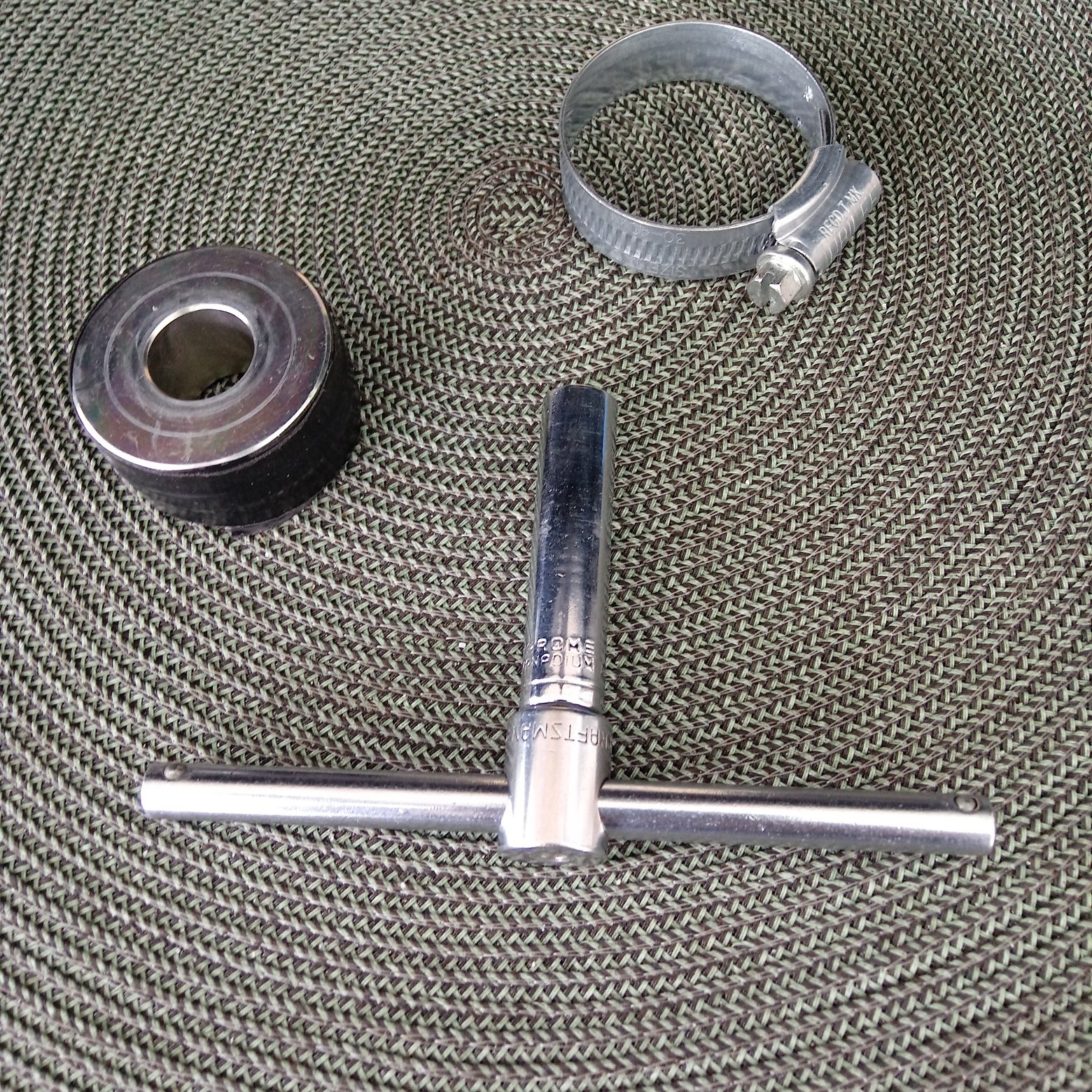

For the pistons, installing the new seals was a bit tricky. I used a full circle smooth surface hose clamp to hold them compressed overnight to aid reinstallation later. I wrapped some tape around them to protect from the clamp.

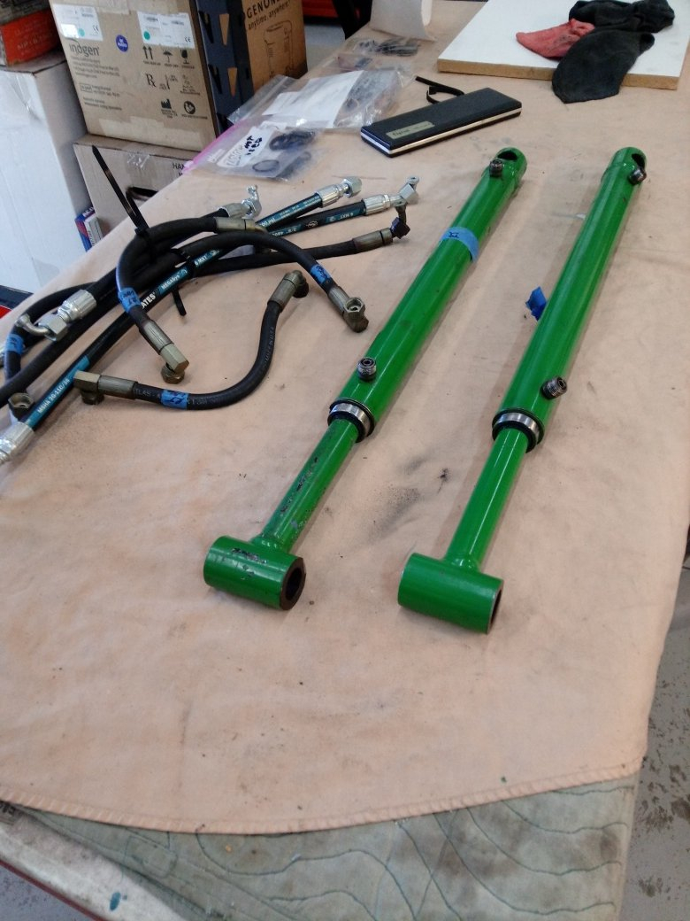

Both done. I also had new hoses made. I added some JD Green to the bare gland ends to keep rust away.
Both are back on and functioning properly.
