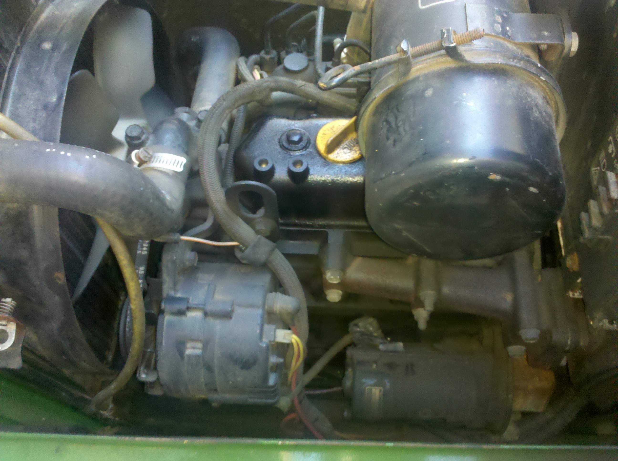

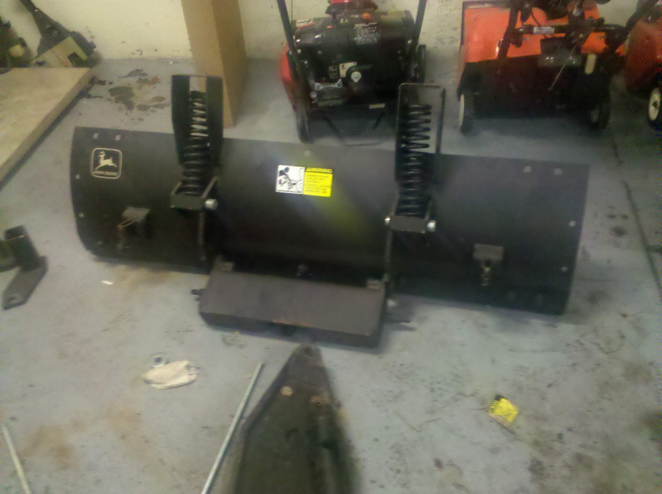

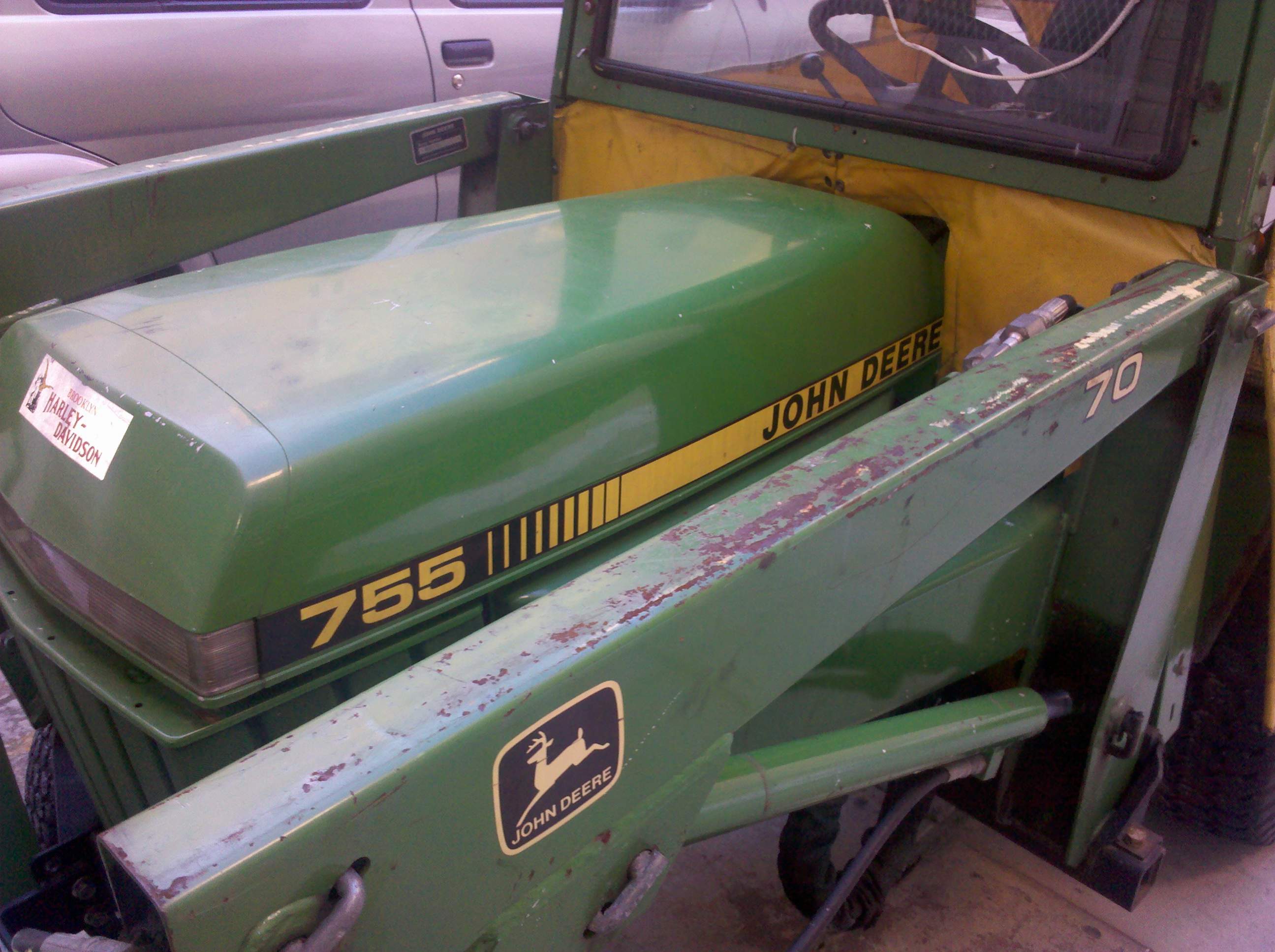

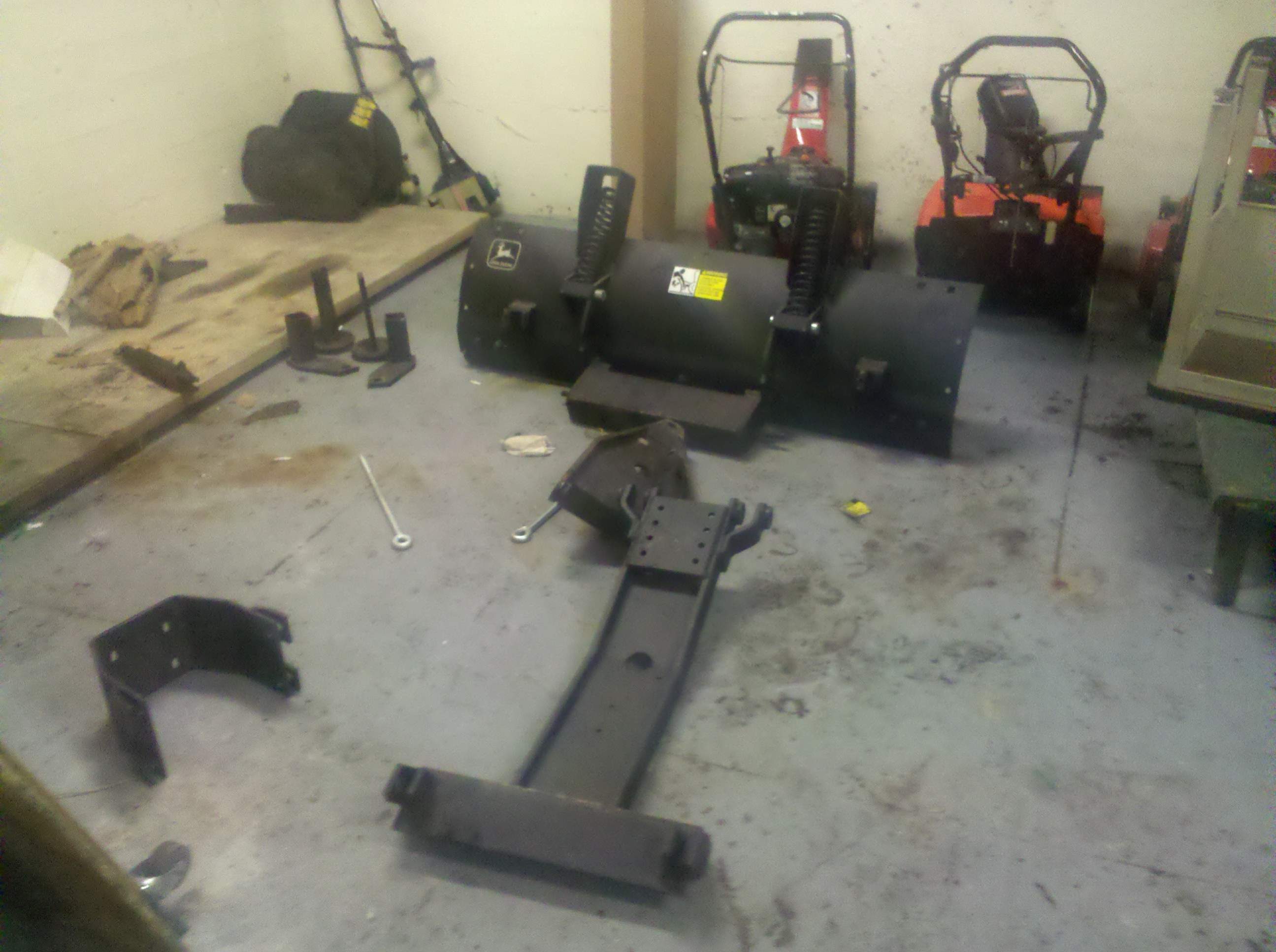

Hey guys I'm stuck. I work as a fireman for the Board Of education and stationed at a school here in queens, NY. We have a john deere 755 diesel tractor. We currently have the bucket on...(its been on since it came with the new constructed field many many years ago)....well upon inspection of our store room i found this John Deere plow. It doesn't have a model number or any type of paper work....everything is brand new...everything was in a box/wrapped. I need to know by you guys expertise if this plow is compatible with my tractor. Or if anybody knows where i can get a parts/work Manuel. I took some pic's of the pieces of the plow....please any help is greatly appreciated...i heard we mite get some more snow this week and i need to make sure our fire hydrants are clear for the FDNY.
thanx guys for your help
-tony
sorry for the mixup guys its a john deere 755 here are more pic's of tractor

here are more pic's
and also here is the id. m00755d6300l3 can anybody tell me when and where it was build and delivered? Thanx in advance!

   / john deere 775 #3

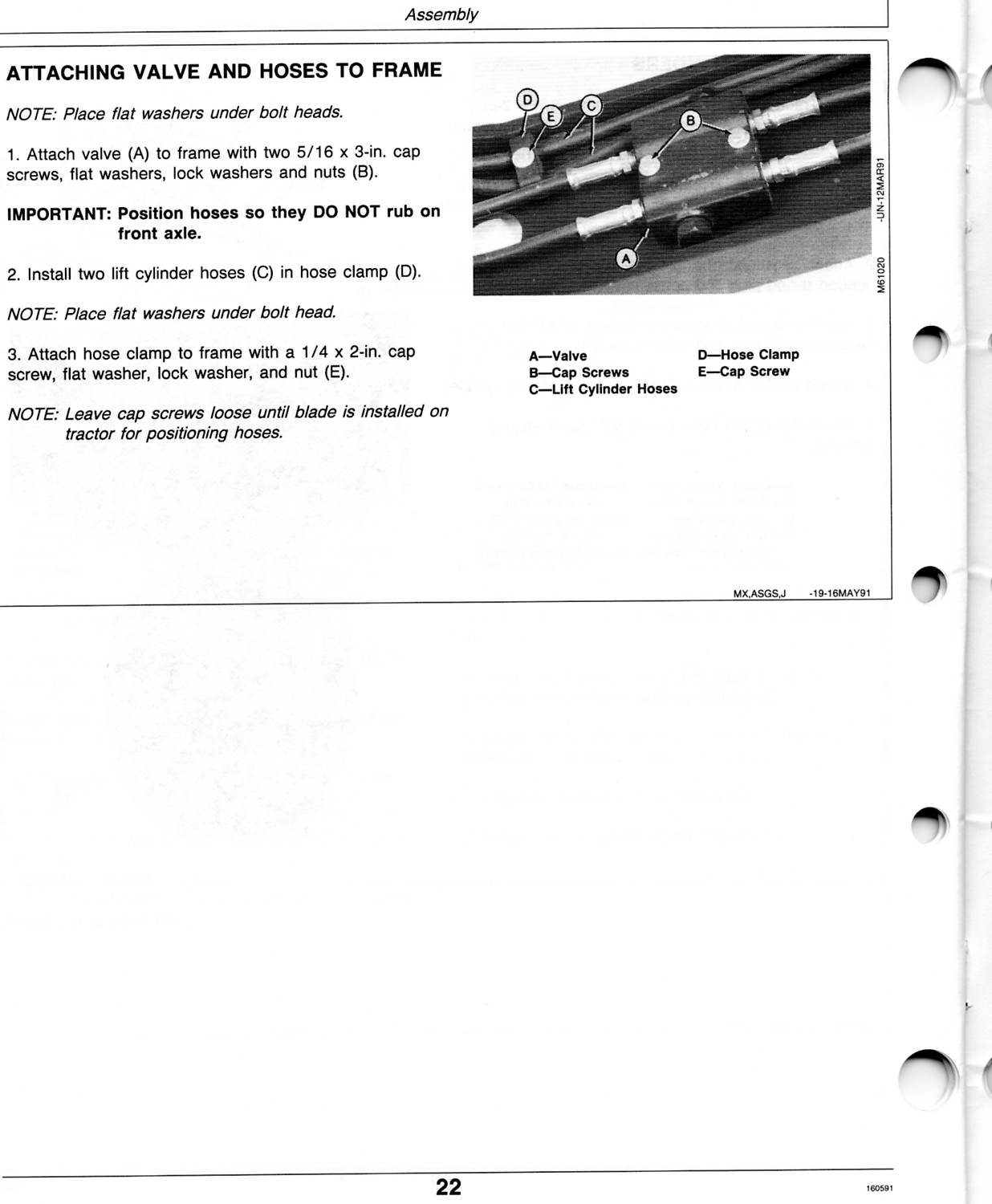

Some quick answers. The tractor is a 1989 model. The blade is a model 380. It is for the 755 tractor, but will require removal of all the mounting brackets for your loader. They are then replaced with different brackets for the blade. This is a common complaint of users and is the reason I sold mine. The 380 is a very nice blade but I would rather have the availability of the loader. I can attach information and some pictures from the 380 manual if you need them.

Thank you for that information. I would love more information on the 380...looks like i am missing alot of bolts and 1 more piston...if u dont mind shareing some of the information ill love it...give me foot in the right direction.

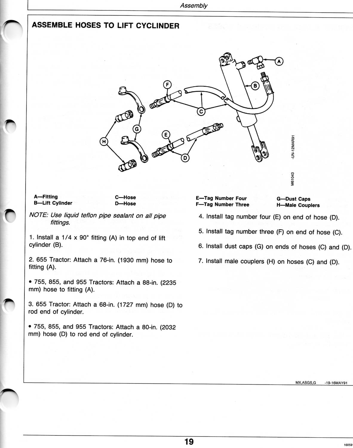

   / john deere 775 #5

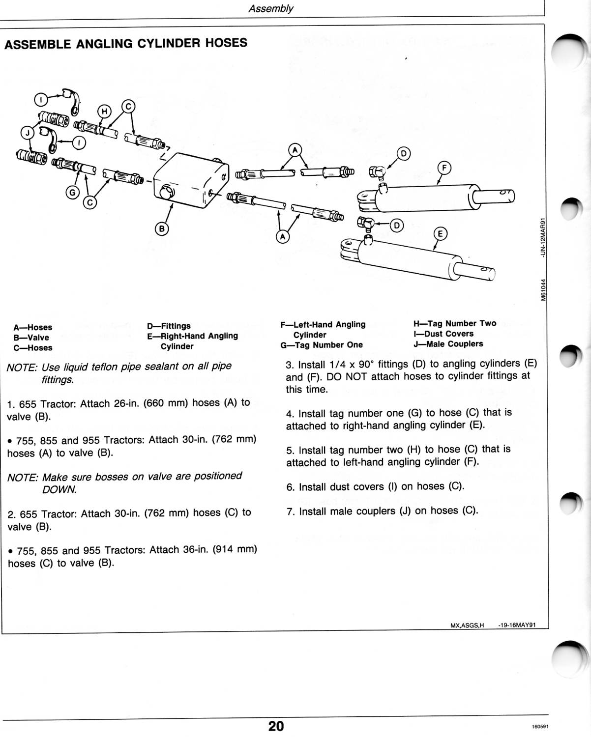

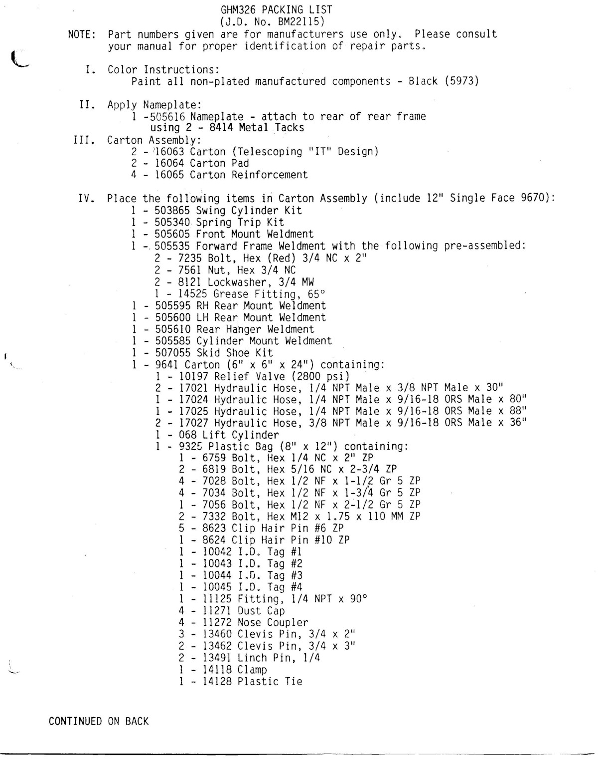

Attaching some pics to get you started. Normally assembly at this level would have been done by the dealer.

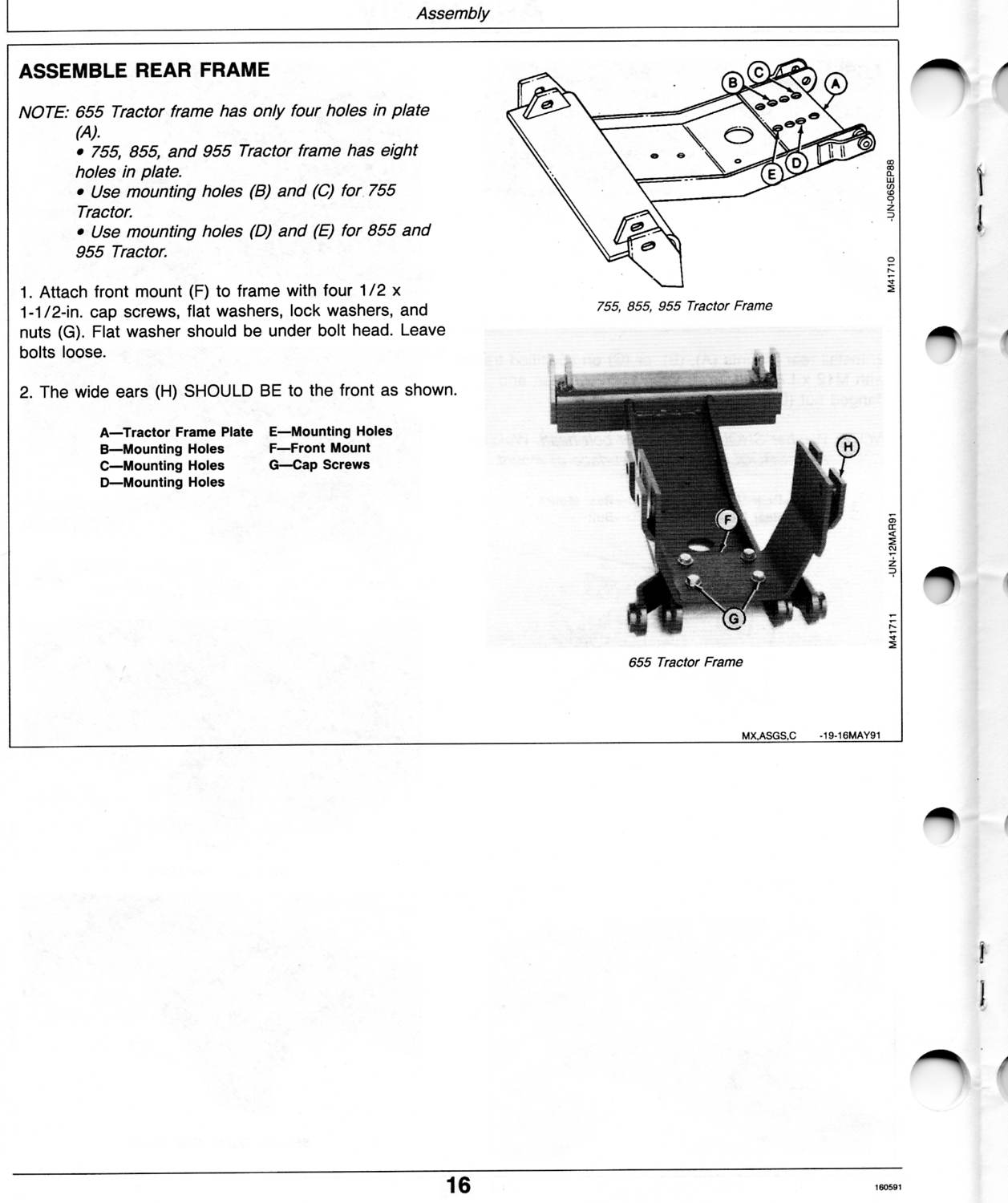

   / john deere 775 #6
More pics.
   / john deere 775
JD thank you very much!!! u just made my day! Its perfect!
