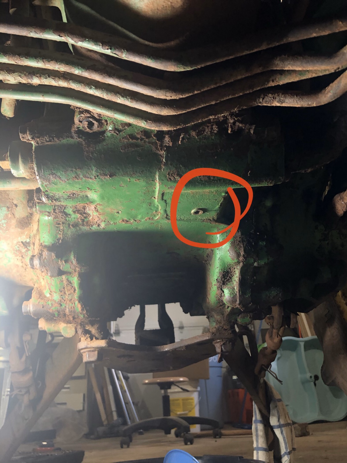

Hi guys, new to the forum. I’ve owned several John Deere lawn and garden tractors but recently purchased a John Deere 770 2wd w/power steering. It’s my first diesel ag tractor. I dont think the previous owner did much maintenance on it. So I decided to do do an all around change. Got everything done but the hydraulic fluid done and it may be a dumb question but I see the (I think plug) with the 3 bolts that you remove to pull the screen... but is that the main drain plug? Or is there another one? I know some ag tractors have several drains but does this one? I have a service manual on order but figured I’d check here. 60192009925__26696AE4-6864-4C72-B55D-22B2710DEFB5.JPG

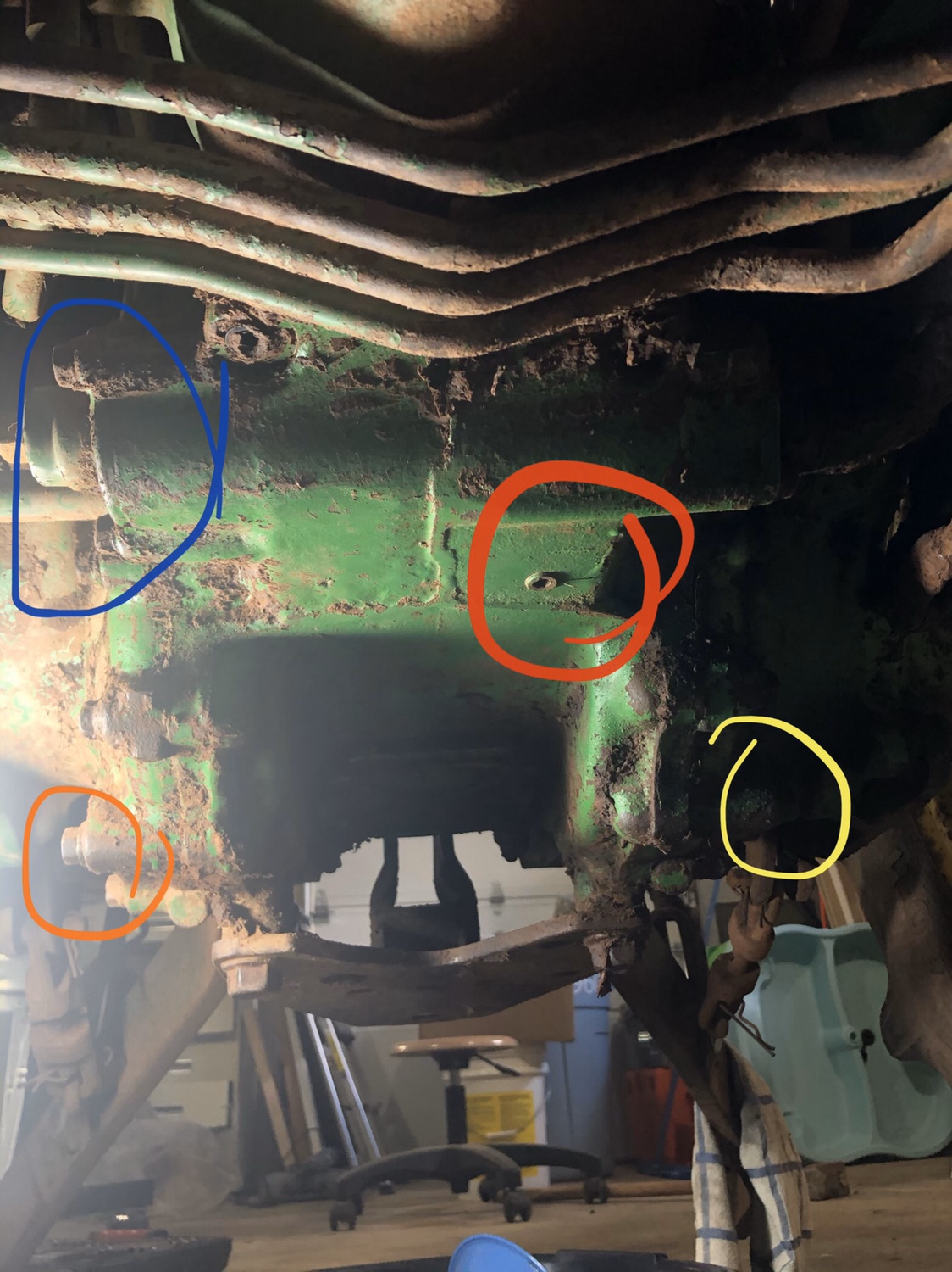

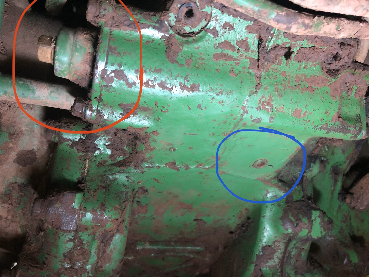

I apologize I reposted some pictures to show what I’m looking at. Picture 1, Circled in red is the hydraulic screen and the center bolt is the main drain plug? Picture 1, circled in blue is that 1/4 set plug.. is that a secondary drain?
Picture 2, circled in blue is a close up of the screen cover (3 bolts) and the square plug (center of cover)
Is that plug on the screen cover plate the main drain for the hydraulic system or am I supposed to be looking for a different plug?

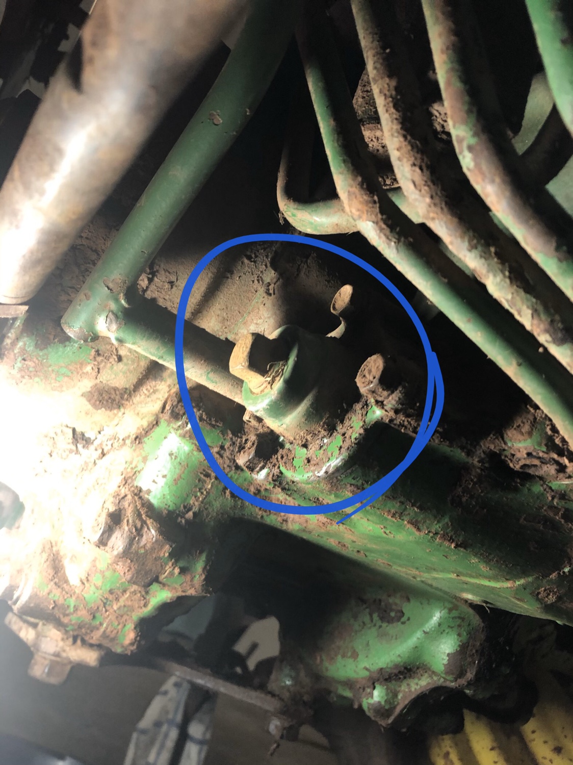

Picture 3, circled in red is a close up of the 1/4” set plug.

From looking at that topic you sent me about the JD 670 (similar to mine) there is 4 plugs? The screen plug, that 1/4” plug, and two on either side. Would that be the general consensus?
Yes, think you have it.. thanks for the extra pics and the circled parts. I'd suggest the "either side" plugs will drain the tranny the best.. appears they are lower in the system. But removal of all of them to be sure they will drain should give you a good idea how much sludge is there, if any.
