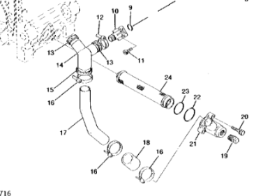

I am suspecting you may have a suction leak allowing air to be drawn into the system. Check the rubber Manifold at the rear of the tractor #14. I have seen some crack as they have gotten older. Also check hose and hose clamps at lower end of suction tube. Hose #18 and clamps #16. You might also take a look at the hydraulic oil since it has been sitting idle so much. Could have collected condensation from sitting and gummed up sump screen.

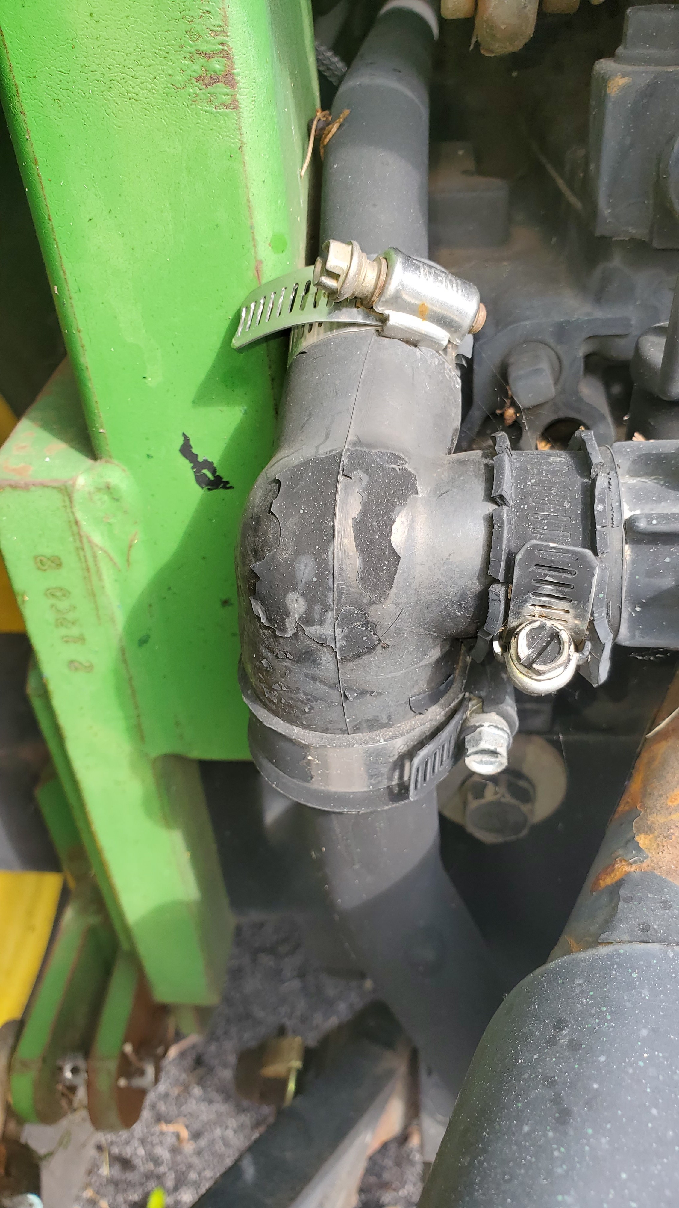

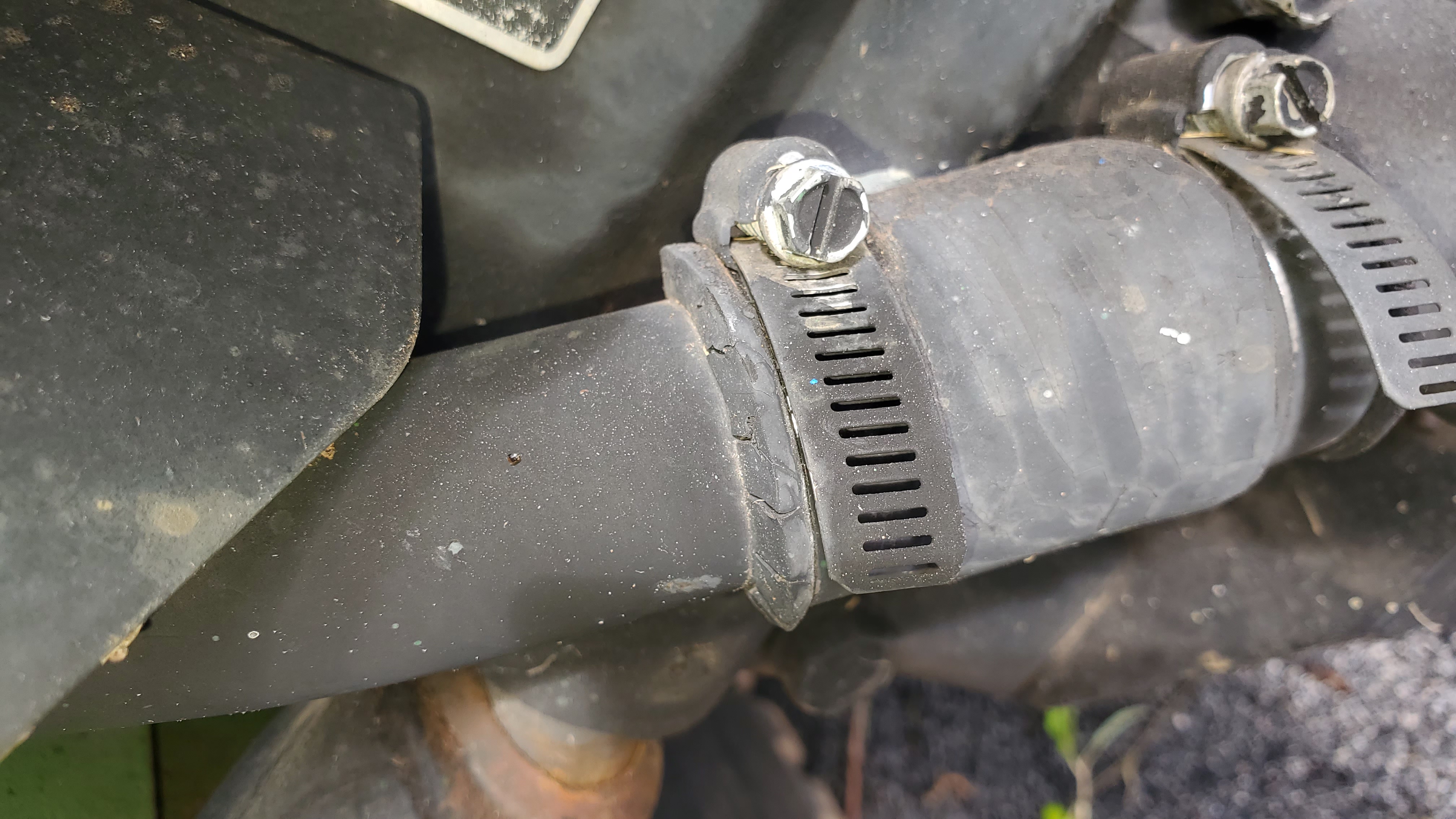

Thanks for the info and parts break out. That really helps. I'd really like to find a good theory of operation on this hydraulic transmission and the configuration. It helps to understand how something works. Here are a couple of photos of the #14 rubber type manifold on my tractor and the lower #18. As you can see they have seen wear. Is it obvious to you that they are a likely source of a vacuum leak? Looks likely to me. I have tightened up the clamps. I had tightened clamps earlier and it didn't make difference.
