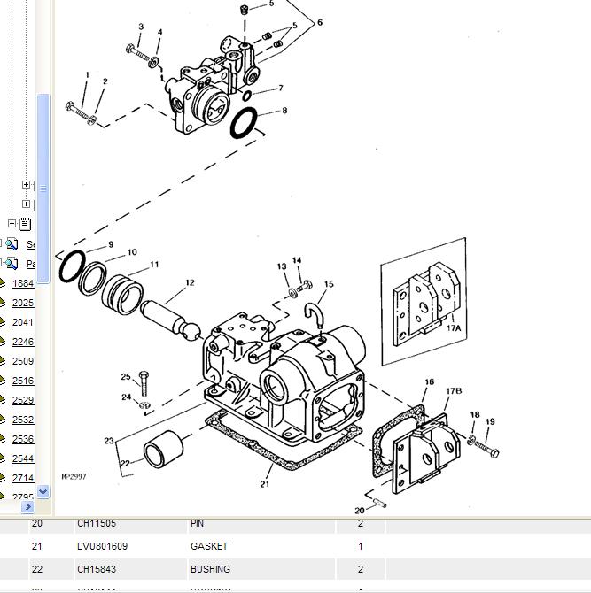

Hey does any one know has much it cost to get the hydrolic seal right under the seat replaced. Has anyone ever replaced one themselfs if so how hard is it to do
   / John Deere 750 #2
Not sure what "seal" you are talking about under the seat. There is a gasket (item #21 in pic) or packing (item #7, 8, or 9).
Either/or? or neither?

Yes that is the gasket I'm talking about
   / John Deere 750
#21 that's the gasket

If you plan on doing repairs on the 750, I highly recommend the JD manual for this tractor. I just sold my 750 after 18 years of ownership and the shop manual was very detailed and well worth the purchase price. It covers everything with many photographs (not sketches) and some of the wiring and hydraulic schematics are color coded.
JD痴 web site has parts drawing available (similar to the one in the earlier post) and prices can be looked up on line.
Are you certain the gasket is bad? Many times hydrualic fluid will leak from above and wick around a gasketed joint making it look like it is leaking.... Just something to be aware of.
Have fun with the tractor.
   / John Deere 750 #6
I think you will need to have a hoist available to lift the casting off the gasket.
But also recommend getting the tech manual for that tractor and am sure you can do the job.
