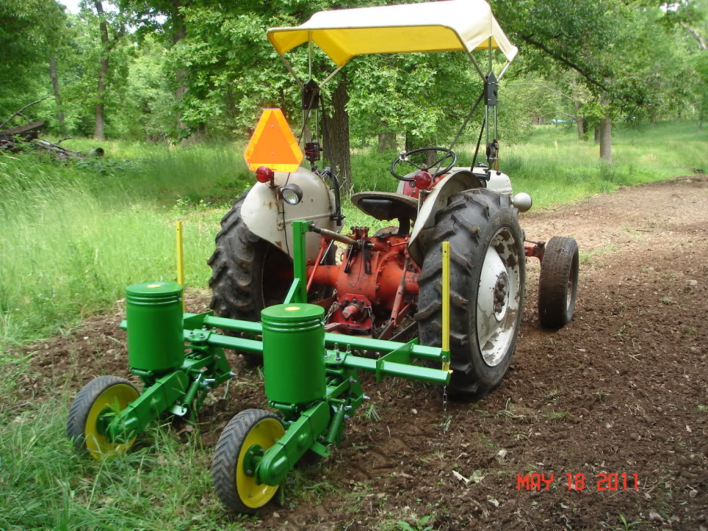

I'm trying to figure this one out, too, for my 2 row 70 Flexi. When I built the toolbar, I built it a little heavy to add it on later. Either liquid, or granular fertilizer. I believe the liquid is pumped by a "squeeze pump" ground driven off the planter drive. Similar to the ebay listing. John Blue squeeze pump | eBay I see them on there from time to time. My 70s have the adaptor on the left side that will drive an insecticide box, one of my ideas was adapt it to turn a 2 row fertilizer hopper like this ebay listing. John Deere large fertilizer boxes | eBay . I see these tanks for the liquid pop up on ebay from time to time, too. John Deere liquid fertilizer tanks for 7000 / 7200 corn planter. | eBay.

I put a Cole side dresser on my JD two row 71 toolbar. I attached a pair of JD double disc openers for dry fertilizer and ran the hoses from the side dresser into the drop tubes on the openers. Looks insane but works good! I'l be taking it out of the shed once the snow is gone for good and can take a picture of my setup then. The Cole side dresser has it own drive wheel to power the distributor.
I was going to use liquid but it is more expensive and harder to find around here in small quantities.
Here is a picture of the openers. In this picture they are locked with a bolt. One the bolt is removed the springs on the openers will push the discs down to make contact with the soil.
