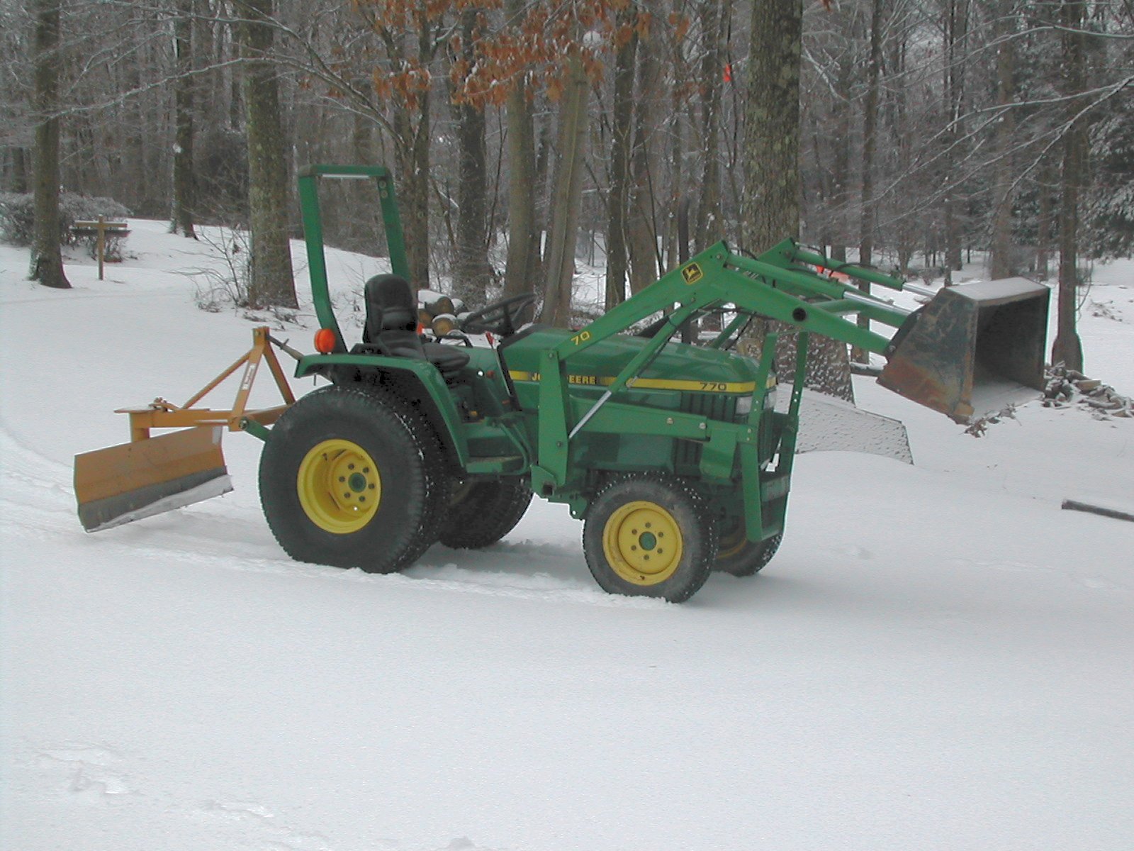

OK....I have come to to the conclusion that I cannot replace my trusty old 770 for what I have in her so I am going to keep her. With that said has anyone ever changed their model 70 FEL bucket to another style?:confused: If so how did it go? I really do not have an issue with the amount that it will pick up it is just the shape. Also.....can anyone confirm if the 419 FEL is a close comparison? If so maybe a bucket switch. Finally, what should I be careful of if I do this?

You'll have to replace the loader mounts and front weight bracket as well...at least those.
I'm not sure about anything else.
Does your loader work OK? Is it just a cosmetic switch? If that's the case, I'd spend the money on getting your 70 refurbished.

It works just fine Roy.......the shape of the bucket is what I don't like. It is OK for picking up gravel in a pile but not for removing material on a flat surface. I also have a project going with barn stone and the large flat ones are tough to get in and pick up. I have been looking at the newer style buckets and they are a lot more efficient in design than my old squarish bucket.

A bucket like this? I would like to have a heavier version of this (have a heavy duty tooth bar on it now, now shown) and a higher-volume one sometimes. But overall, this bucket works just fine for this tractor.

Yep, that's the buck I have. I thought about teeth but just didn't do it. If you look at the latest bucket designs the are sweeping with a curved under belly. Not squarish in design. Maybe it is a materials bucket only. My quest is to find a bucket like a new one and attach it without breaching the load maximums. I am in the process of building a barn stone wall and patio and I have to chain or strap the larger stones because they don't fit.

Depends on your ability & tool inventory...BUT..I'd just pick the bucket you like and cut/weld/grind/fabricate mounts for your new bucket to fit your FEL......
