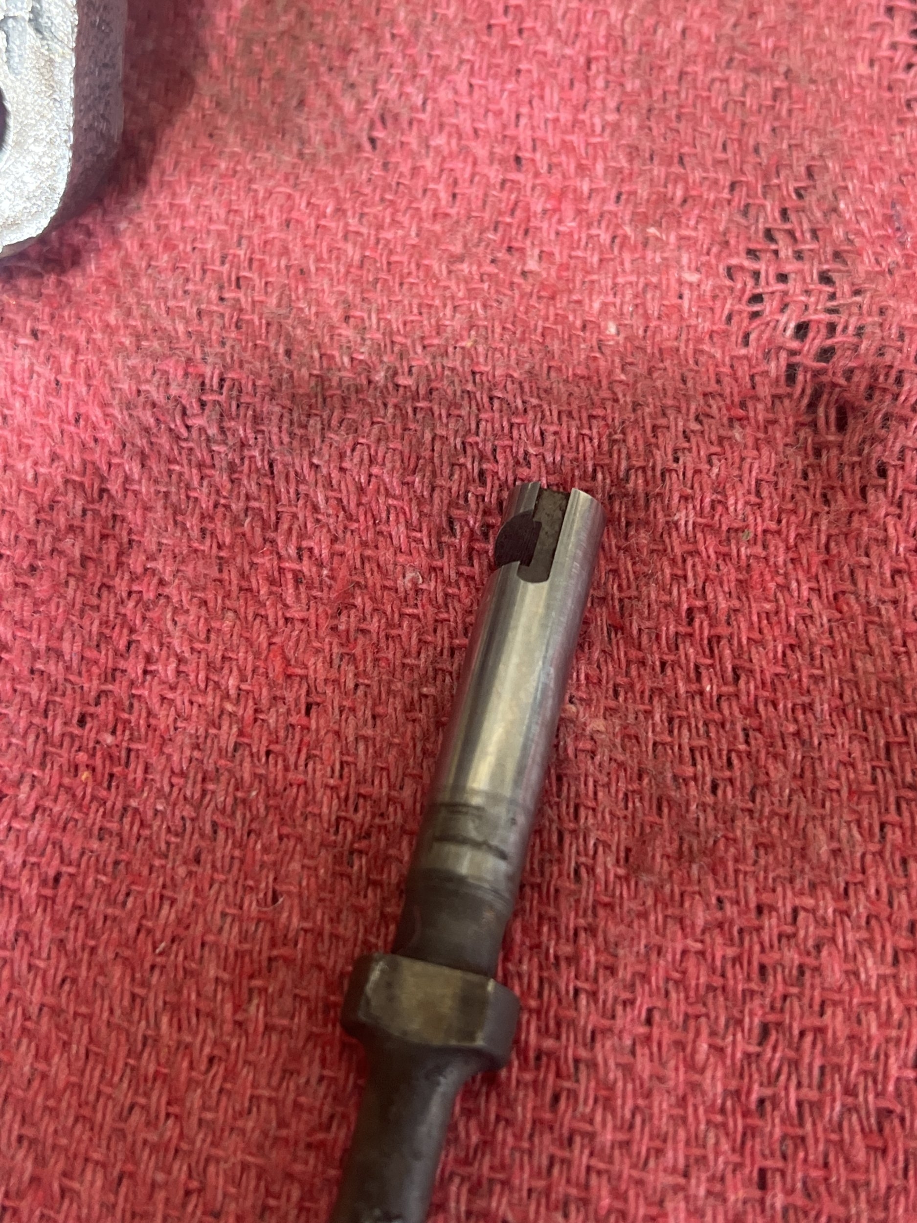

I have a John Deere 650 tractor that I was in the process of cleaning up a rusted injector pump and one of the small pins that hold the rollers in flew across the shop. Does anyone know where I can get the pin and wire that hold the pins in place ?
Items 39,40,41 and 42 in attached photo.

I can help u.. gimme a few minutes to look up the p#..
   / John Deere 650 injector pump parts
Awesome thank you!!! That narrows the search down tremendously!!!
   / John Deere 650 injector pump parts #5
I don’t think I have a 2 cyl core inorder to get a wire but the pins cross from several cyl pumps.
U might be able to snip a wire from a 3 cyl.??
Lemme know thru prvt msg. if u get stuck..
Thanks you I believe I found the correct parts at Toad Marine. Question…. When the timing notches are all in line, is the notch in the plunger suppose to be up or down? I assume notch down and sold side of the plunger is up but we all know what can happen when assuming.
