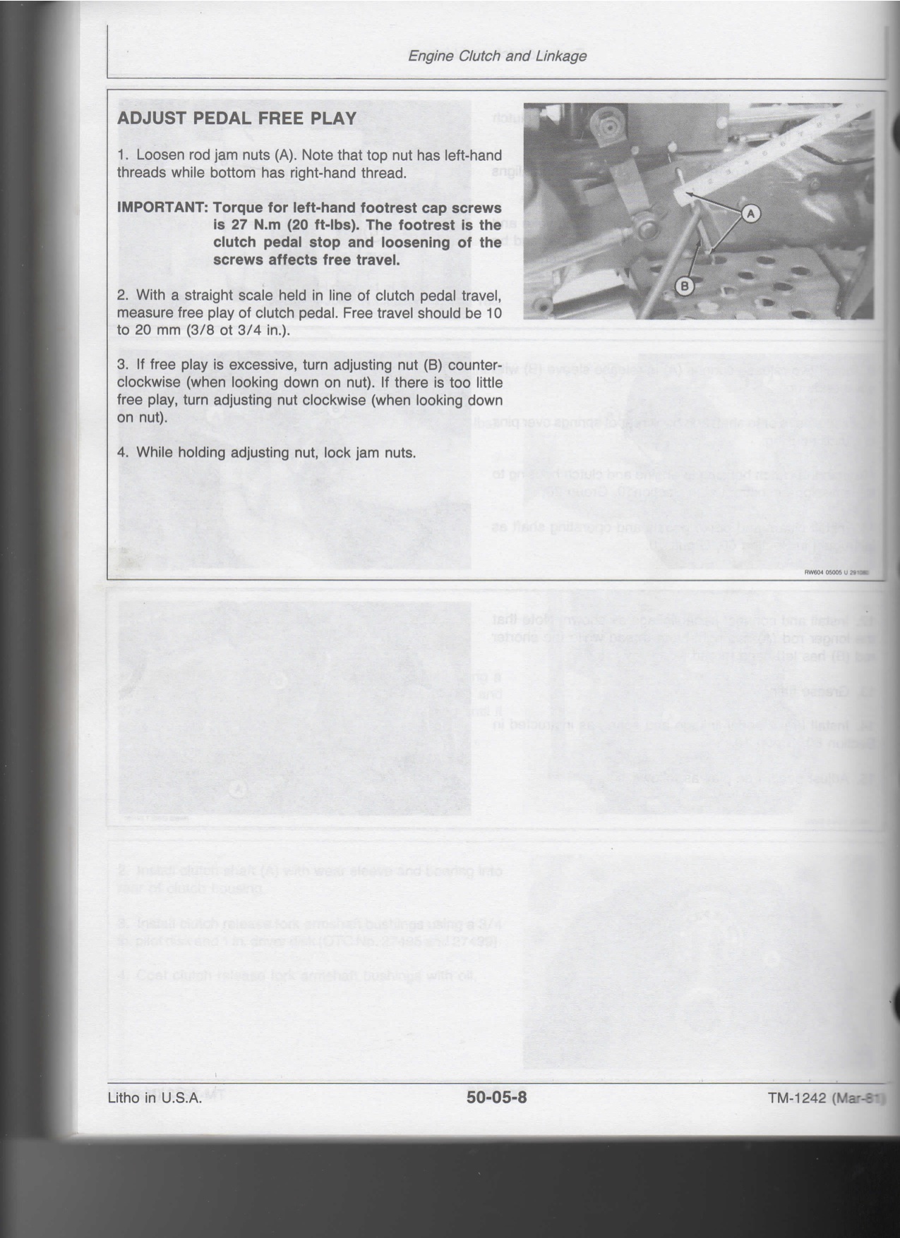

You should have about an inch of free play in the pedal before you feel resistance.
   / John Deere 650- hard to get into gear
Thanks Barry. I don't think I have any free play in that clutch pedal. It was worse when I bought the tractor to start. I adjusted the pedal out, it made shifting better, so I think it needs to be adjusted out even more so I get additional throw?
Regards
Joe

Yes. You should be able to push the pedal down about an inch with one finger.If it has no free play,the clutch will slip,and the throw out bearing will wear out.
You might end up having to replace the clutch.If it is adjusted right,and it still won't stop spinning when you push it in,then about the only other thing it could be,would be a damaged clutch or pressure plate.
   / John Deere 650- hard to get into gear #9
Thanks guys. I adjusted the clutch to the factory specs and still can't get that shaft to stop. If I leave the PTO engaged. it slows down to make this manageable. I've done many clutches on cars and trucks. Is this something that can be done in about a day?
