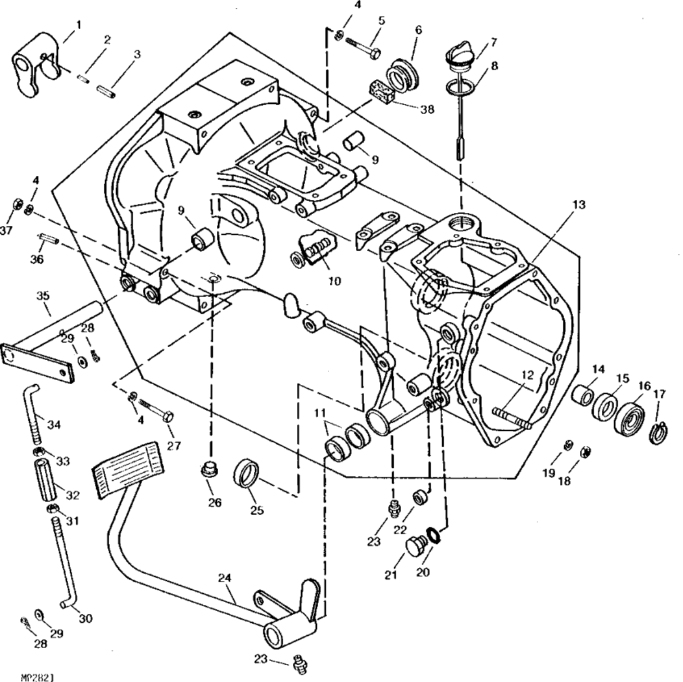

I have a John Deere 650 I believe a 1988 2WD.
I am having trouble finding some part numbers for some clutch parts I found an IPB showing the parts I need but there isn't a reference for the part numbers themselves.
I need part numbers for these index numbers in the attached photo.
The initial issue was that the clutch pedal froze in place on me while I was operating it. The linkage snapped when I tried to stop the tractor. I cracked the tractor in half and found that the bronze bushings had rust welded themselves to the rod assembly that goes through the case. I removed all the parts and discovered they are rusted almost beyond repair. The bushings are scored internally so they are trash now.
#1
#35
#9
#30,31,32,33, and 34.
Thanks in advance.

You can go to www.jdparts.deere.com and look up the part numbers,but it won't do you much good. Number 1,35,34 are no longer available. # 9,32,30 still are.

The rod (parts key #34)part CH14776 is no longer available. Yoke parts key #1 The part CH14773 is no longer available. Contact your local John Deere dealer for other options.
parts key #32 CH11452 Turnbuckle ADD 4.34 USD
parts key #33 14M7145 Nut ADD 1.00 USD
parts key #31 14M7273 Nut ADD 0.33 USD
parts key #9 CH10889 Bushing ADD 10.57 USD
parts key #30 CH14777 Rod ADD 8.63 USD

Just found this thread...have you tried Yanmar? The 650/750's were made entirely by Yanmar for JD, and a lot of the same parts were used on YM branded tractors... You can find a "JD" parts catalog cross referenced to YM numbers here:
John Deere - Fredricks Equipment
(I didn't go look, but might be a lead...)
