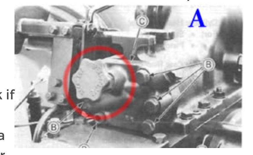

Since I bought the tractor, my 1983 John Deere 650 has issues with the hydraulic stop valve. I have tried everything, but I can not get it to turn in either direction. There is some rust on the visible threads. From the best I can tell, it is in the fully open position. When I try to lift any attachments, it's quite fast and choppy.
Has anyone else had this issue of the valve being seized? And if so, any remedies to free it up? I'm out of ideas.

The valve controls only 3PT hitch drop speed or it can be closed to hold the 3PT.

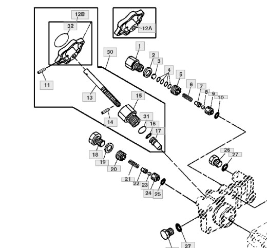

The valve is similar to a faucet valve in that it has a stem shaft in a gland nut sealed by orings. With the tractor off and the hitch all the way down, you can unscrew the gland nut and take the assembly out to better work on it to free it up.

That JD 650 was built by Yanmar and shares that part with YM2000/YM240 etc from similar years, early 80's. TractorTech's instructions are great for disassembling that valve.
The valve is only to lock the 3-point in the 'up' position for safely working under an implement. If you don't need to do that then the valve is irrelevant.
There is a separate drop-rate valve as Jims described above, a tiny T-handle on the side of the transmission.

I ended up doing what you suggested. Despite lots of penetrating oil, some heat, and letting it soak in Evaporust for a solid 12 hours, it just won't free up for anything. I'm just going to leave it before I end up breaking it. Thanks for the feedback.

Luckily I don't have any need to lock it up at this point. I did what TractorTech suggested to make it easier to work on. However, I just can't get it to free up despite copious amounts of penetrating oil, heat, and a 12-hour soak in Evaporust. The holding power of rust is quite impressive in this case. At this point, should I ever find myself need it to function, I'll have to pony up and buy a replacement one. Thanks for the feedback.
