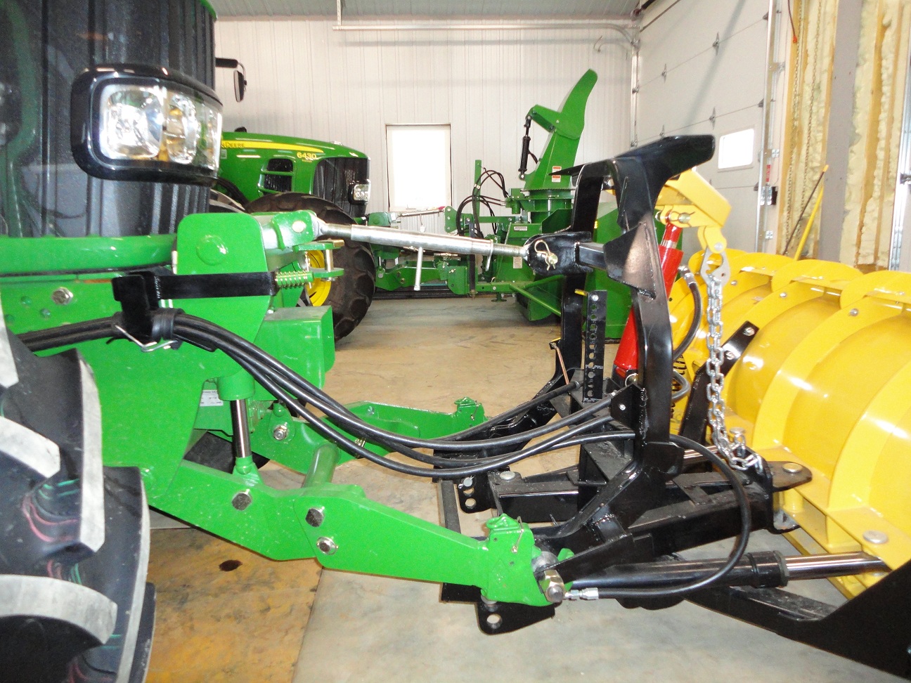

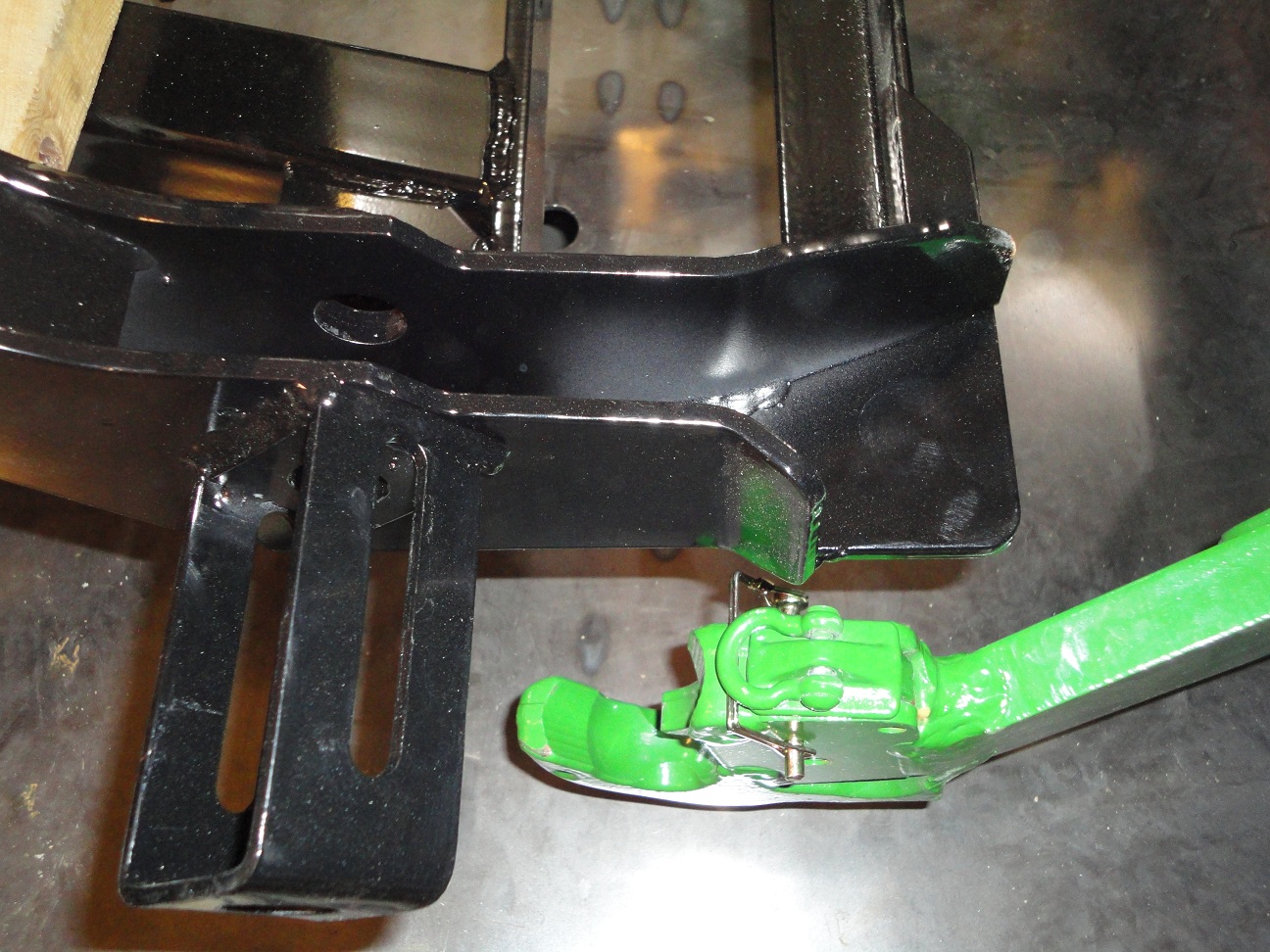

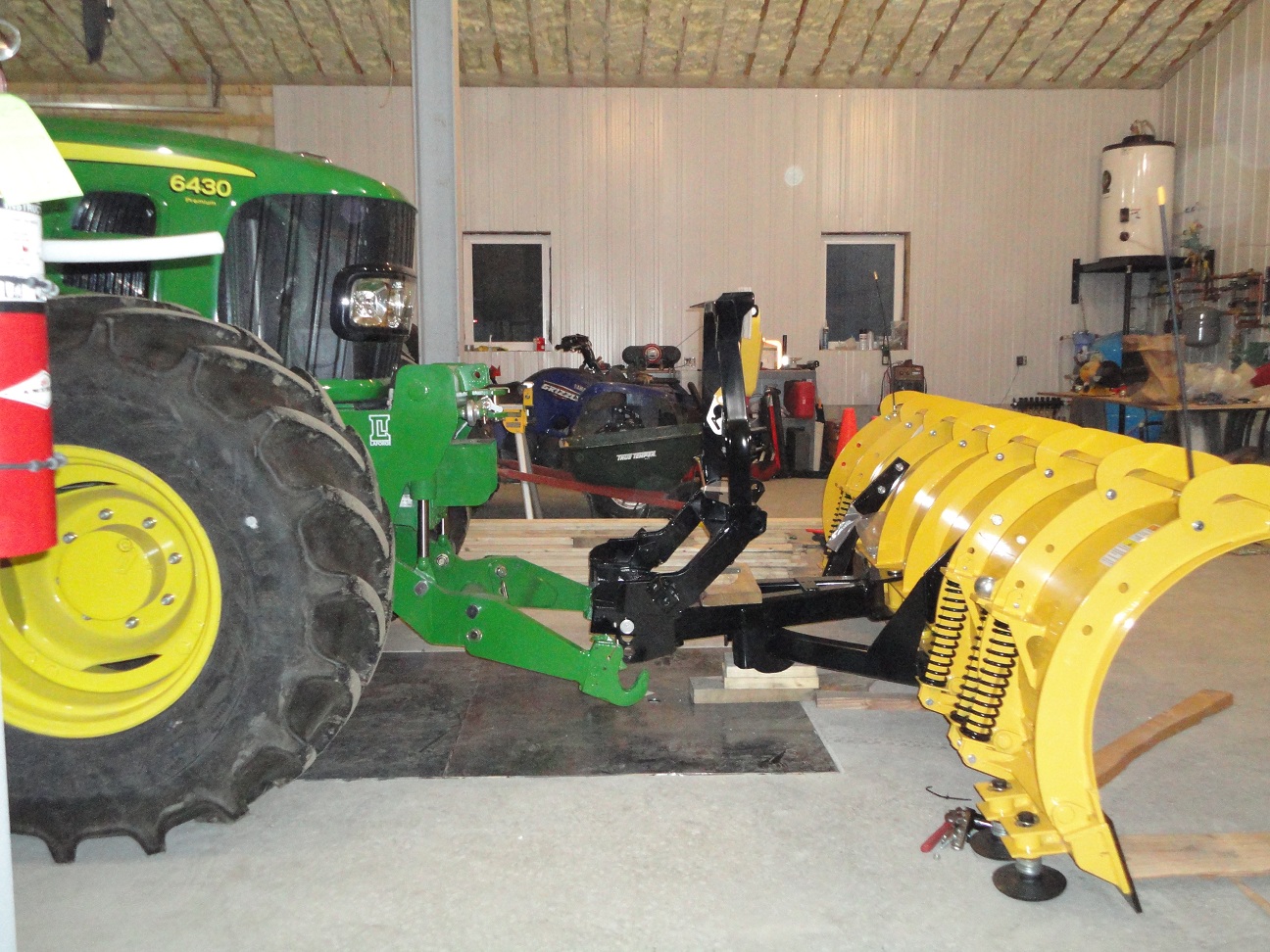

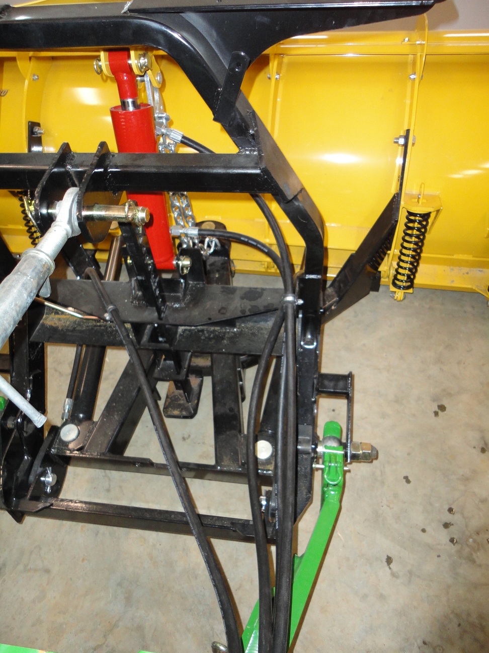

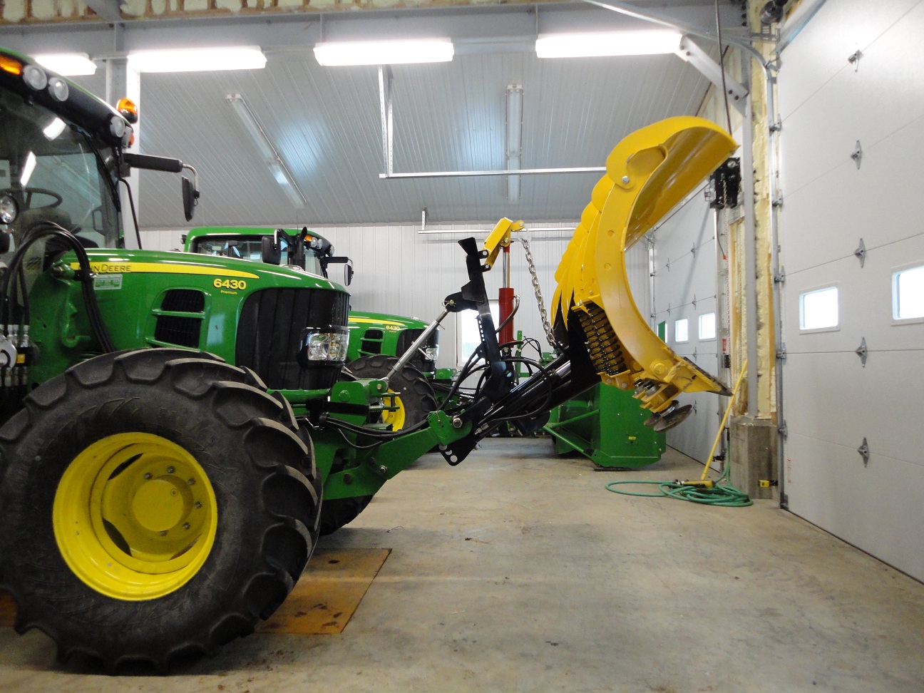

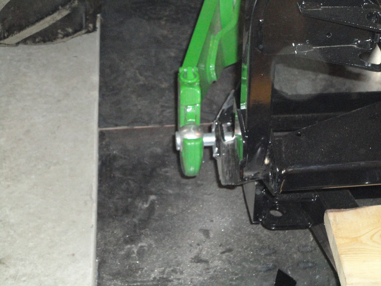

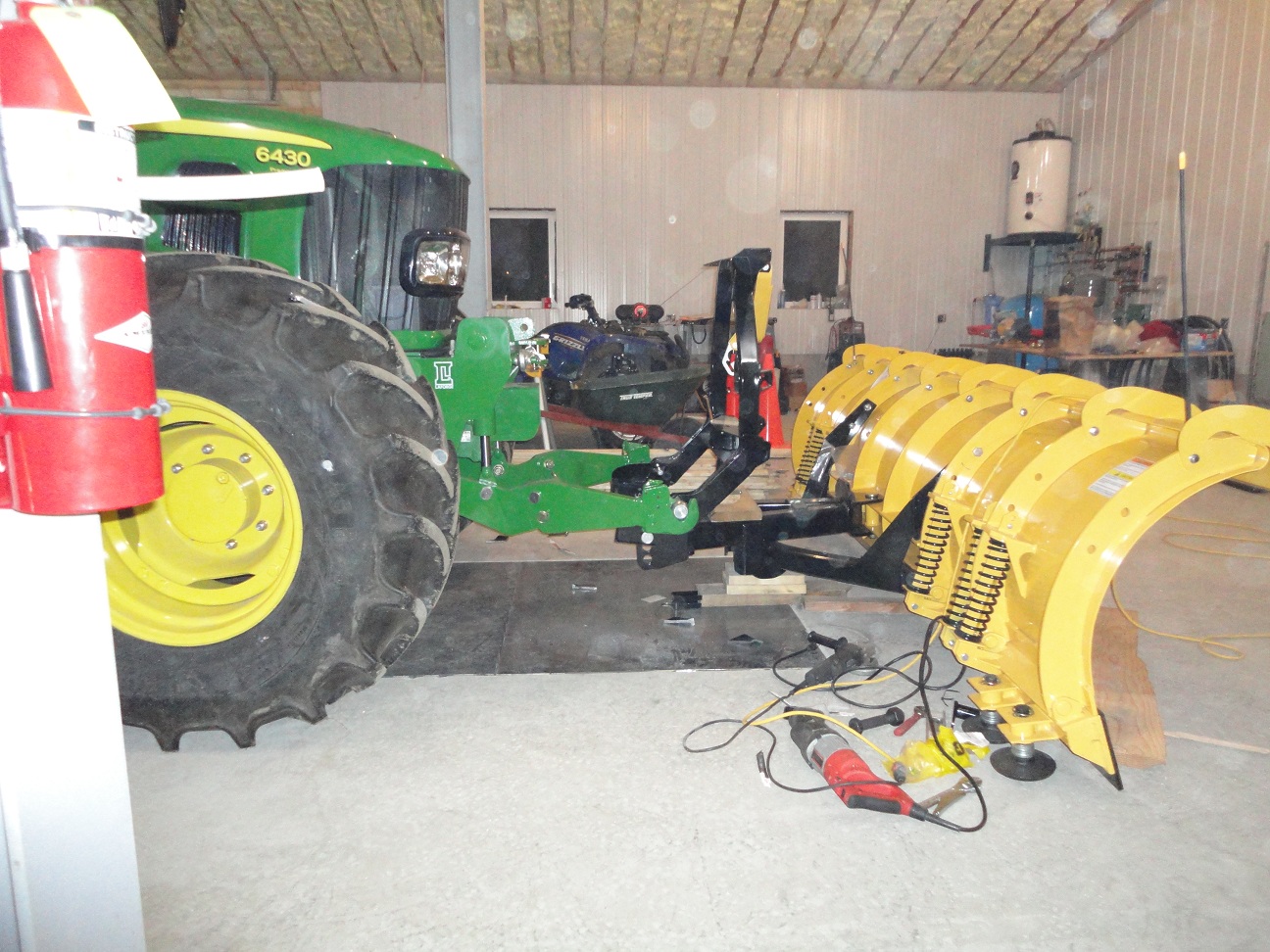

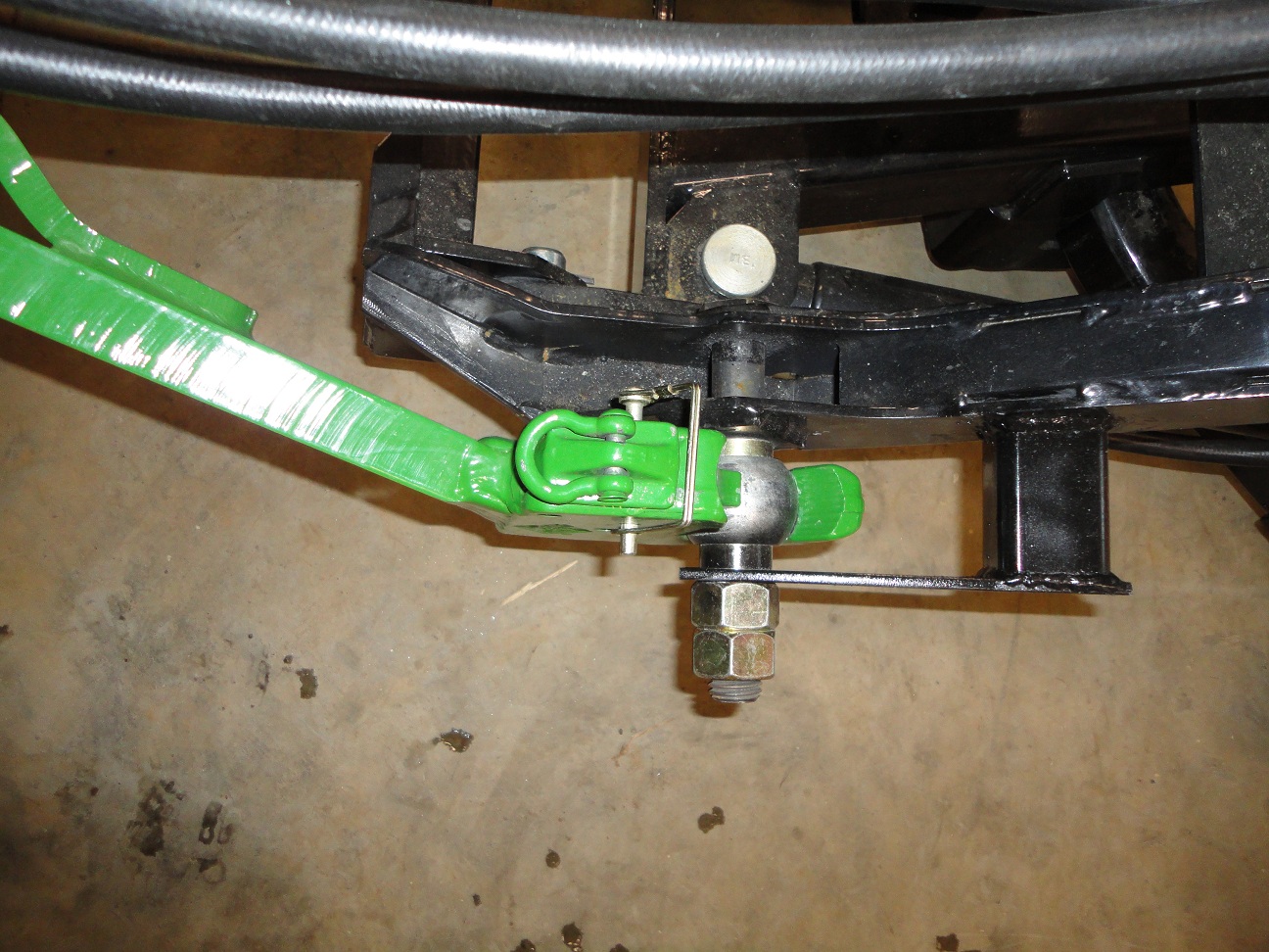

John Deere 6430

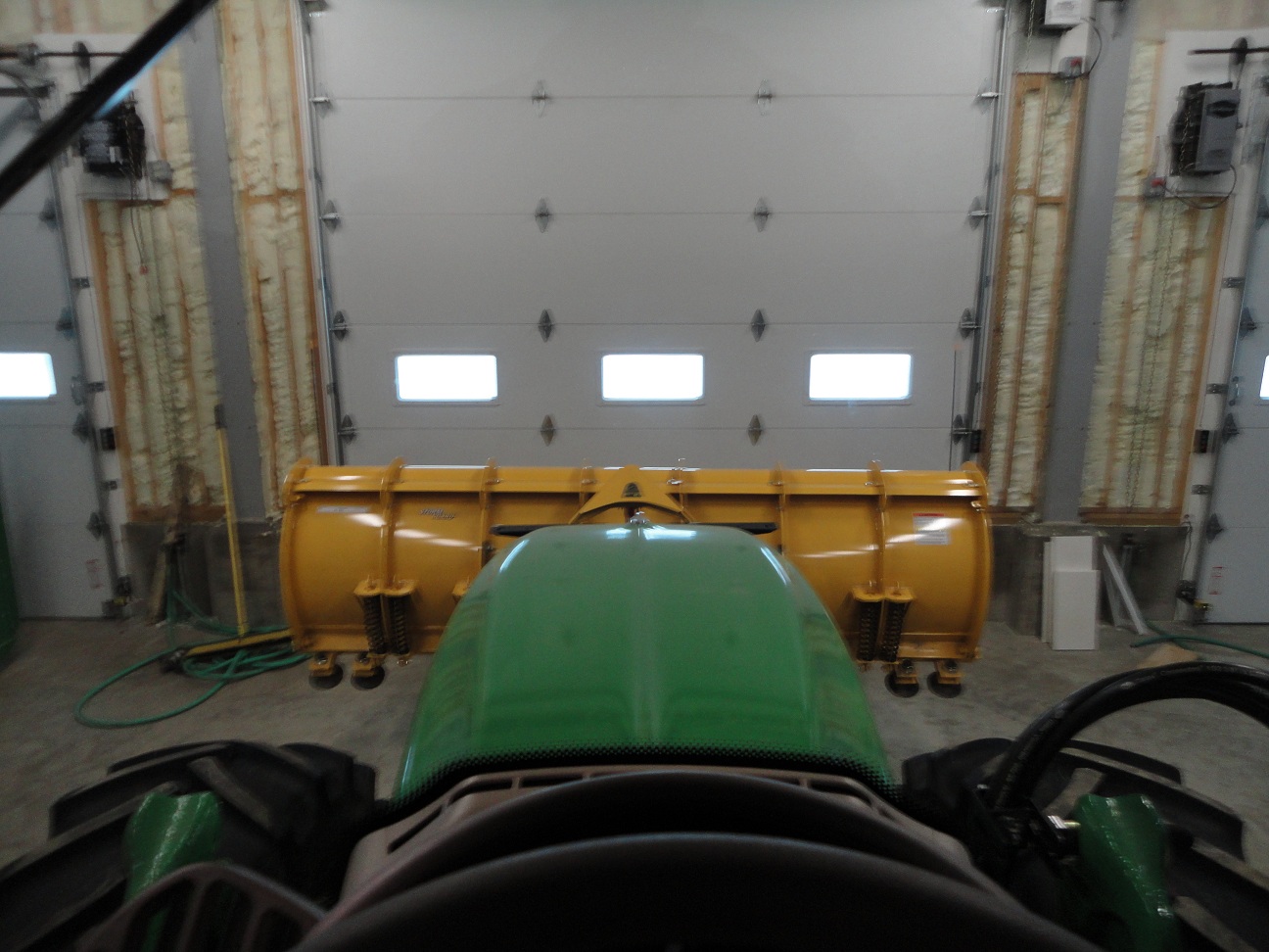

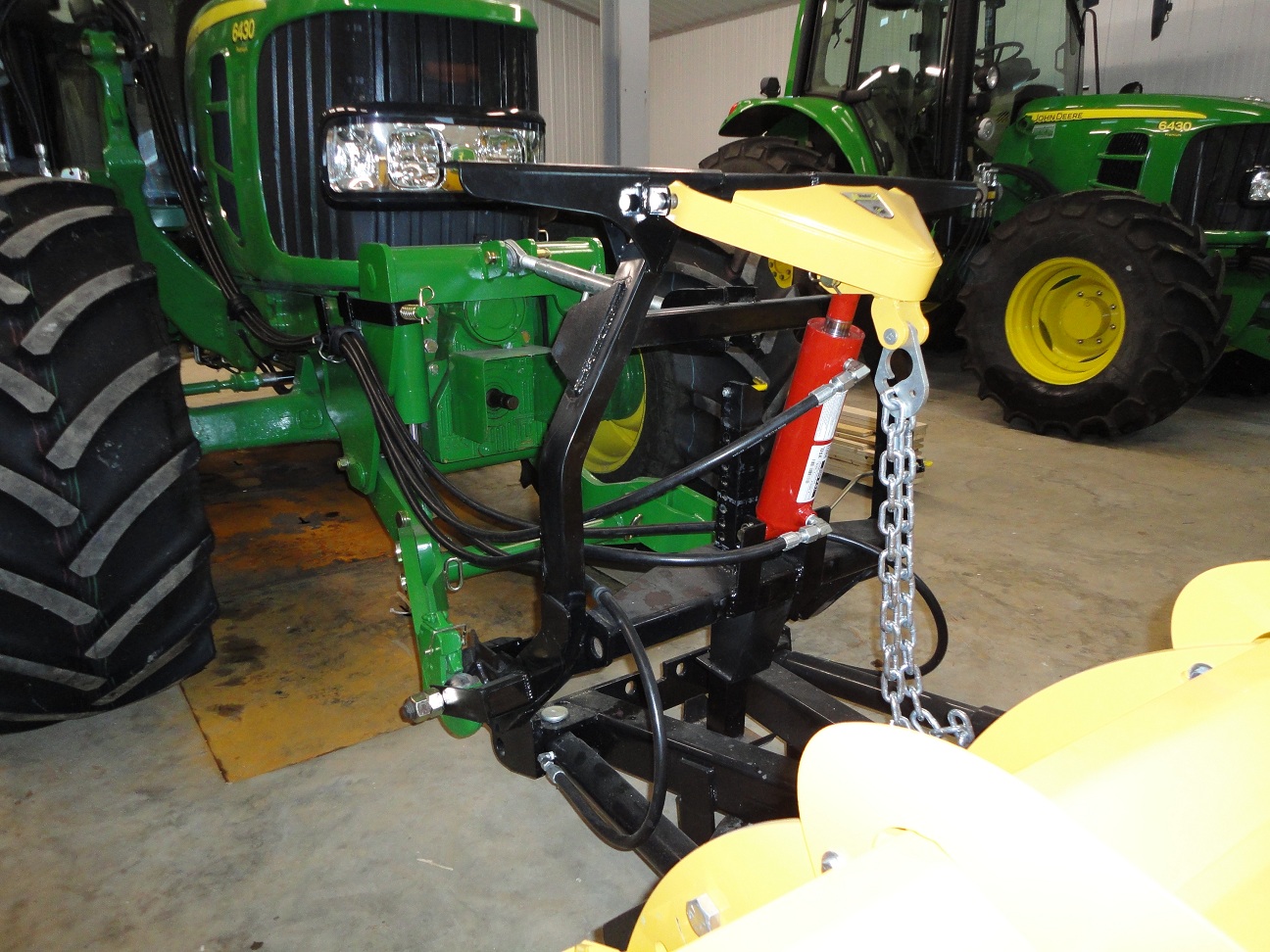

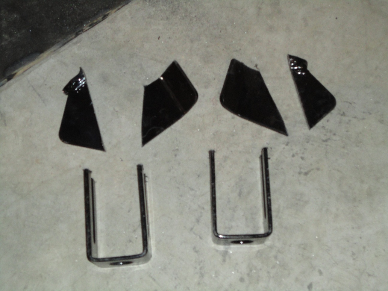

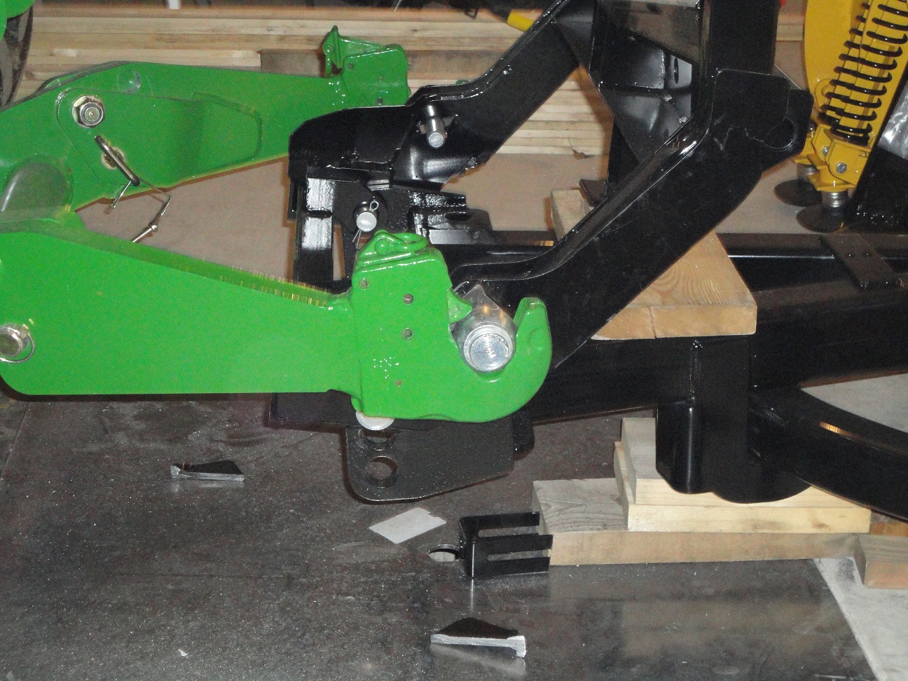

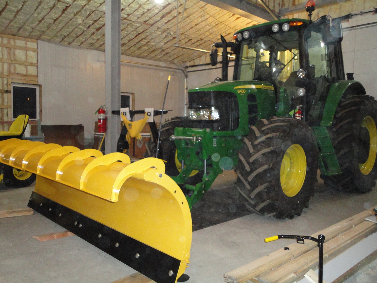

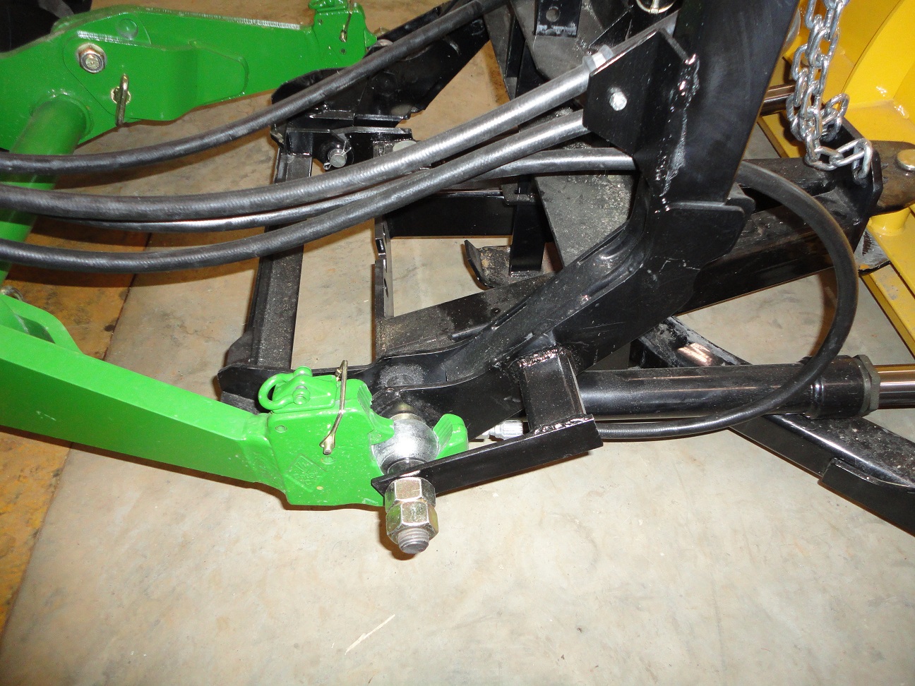

First winter with the new John Deere 6430s one got an 8ft Frontier snowblower (rear mount on the front hitch). The second I wanted a snow plow. Not easy to find what I wanted, so I got a new Fisher 10 ft commercial snow plow (no pump or lift cylinder) and started cuting it up to make it fit my front hitch. Couldnt have gone better. I only had to remove the original minute mount hitch pins and trim the corners of the frame. My new hitch pins use the same holes I only had to move the pins to the outside of the frame to be wide enuf to hook into the front hitch. Added some new reinforcement to the out side of the new pins. All hydraulis run to my loader control, angle side to side and with an aftermarket lift cylinder I have power up and down.
Pictures of the finished jod coming soon. Took it out for its first try today and couldnt be more happy.

I'm not seeing a lift cylinder. Not shown?
I see where the Deere hitch lifts, but not how that would lift the plow.

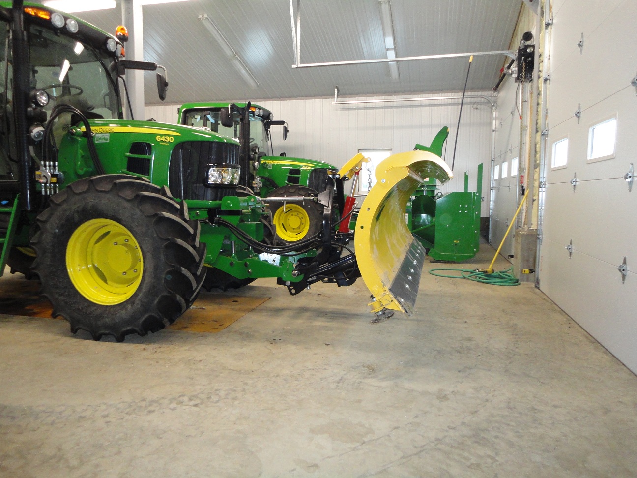

The final shot of the finished plow.

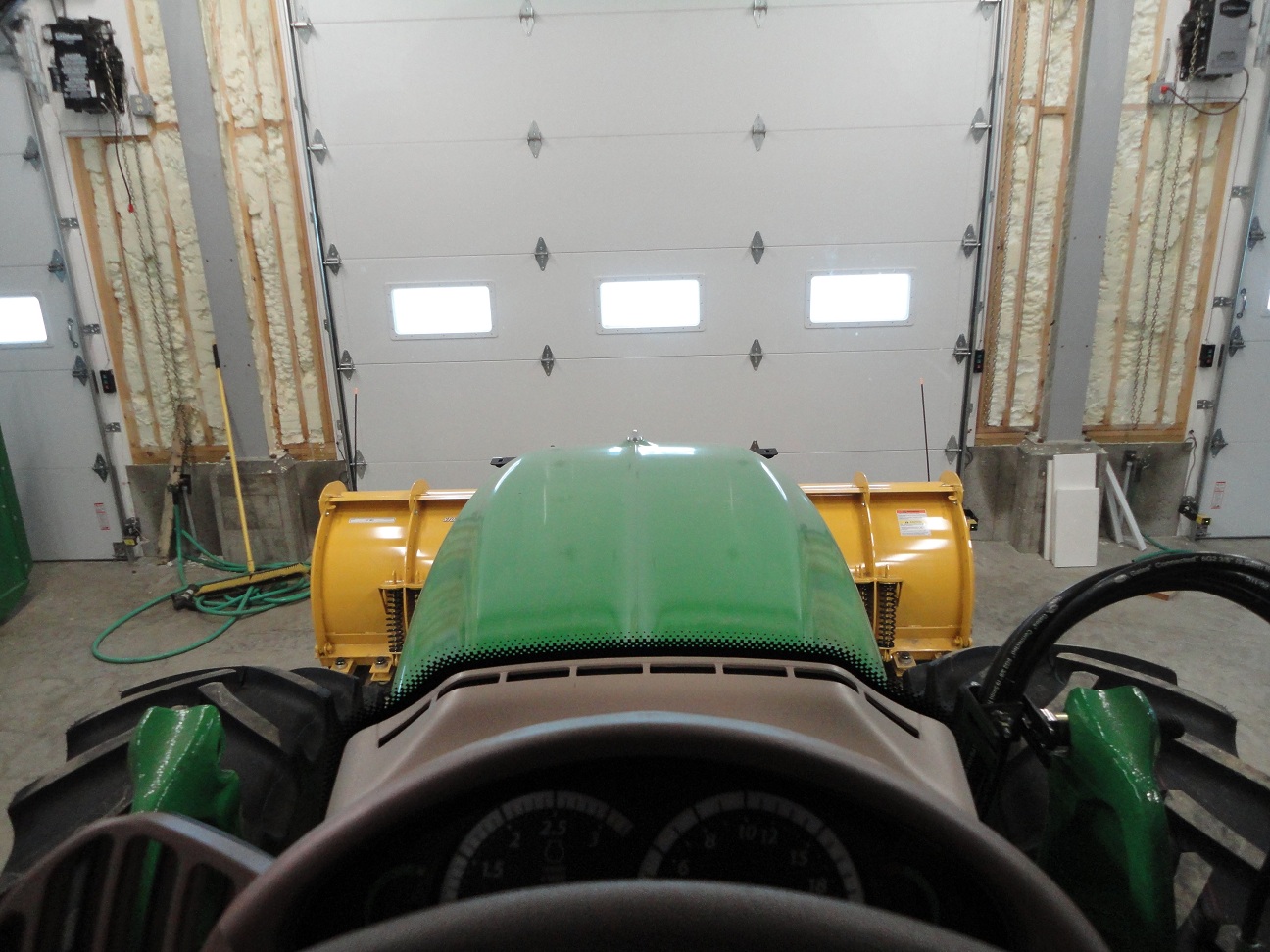

Lift cylinder is in hydraulic lines are run, up graded push pins from 1 inch to 1 1/8 bolts. Some pictures show working height plus max height.
The three point hitch stays at working level and the plow is lifted the same as it would on a pick-up unless I want it maxed out, fully rasied its over 4 feet high

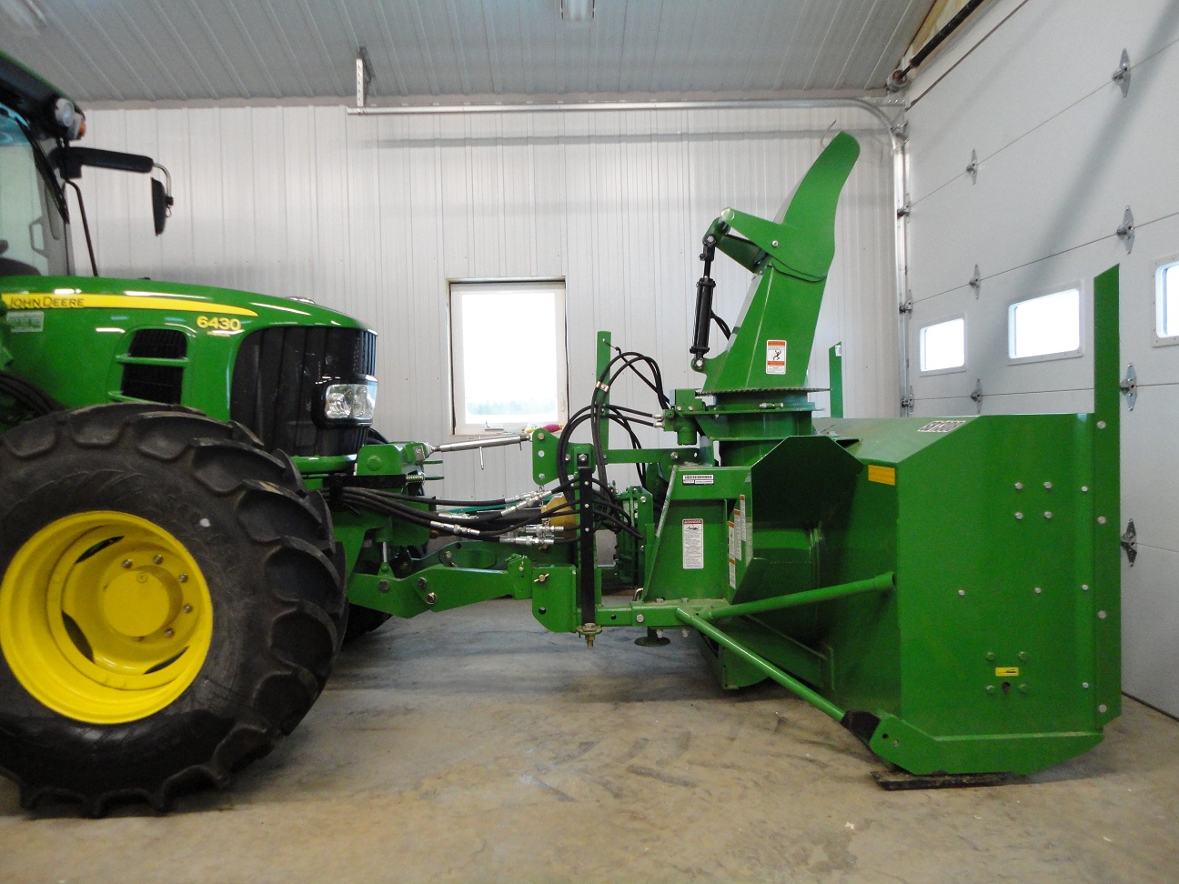

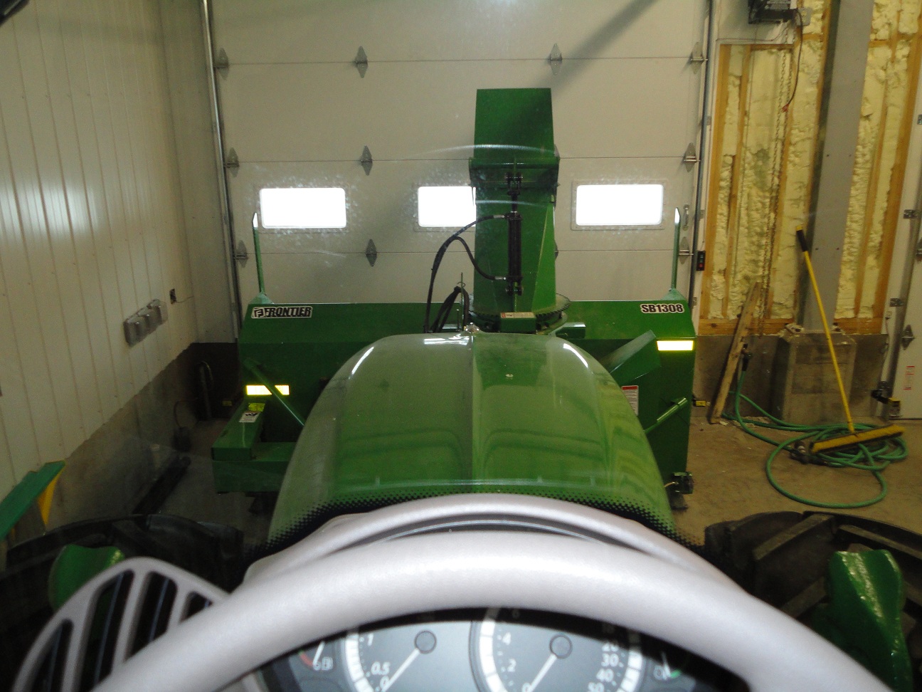

Few shots of the rear mount Frontier SB1308 snowblower on the front of the second tractor. It was a 540 rpm pto up graded to a 1000 rpm pto. All three functions work through my loader control as well. Raised useing the three pint hitch.

Thanks for the rest of the pics. Makes more sense now, and answered my wonderment about the light-weight pins.
