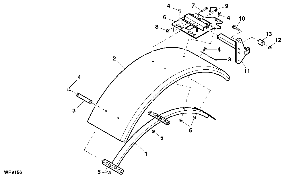

I have a 5055e with a 553 loader and have recently order part no. BW15741 (stationary fenders) to fit. The problem is the bracket that was supplied is way too short and doesn't seem to line up with any holes on or near the loader. The local JD dealer has come and also stated " that doesn't fit or line up " and has not been any assistance since. The JD picture of BW15741 states it is designed for 553 and 563 loader but is shown on a 410 or 460 loader.
Does anyone have stationary fenders on a 553 loader on a 5E series tractor that I can get a picture of or part no.s please.

Does what you have look like this parts drawing?
   / John Deere 553 loader stationary fenders
Hi Zebrafive
Yes it does, the complete guard comes assembled and ready ot fit to item no.11. Item no. 11 is the mounting bracket which is too short.
