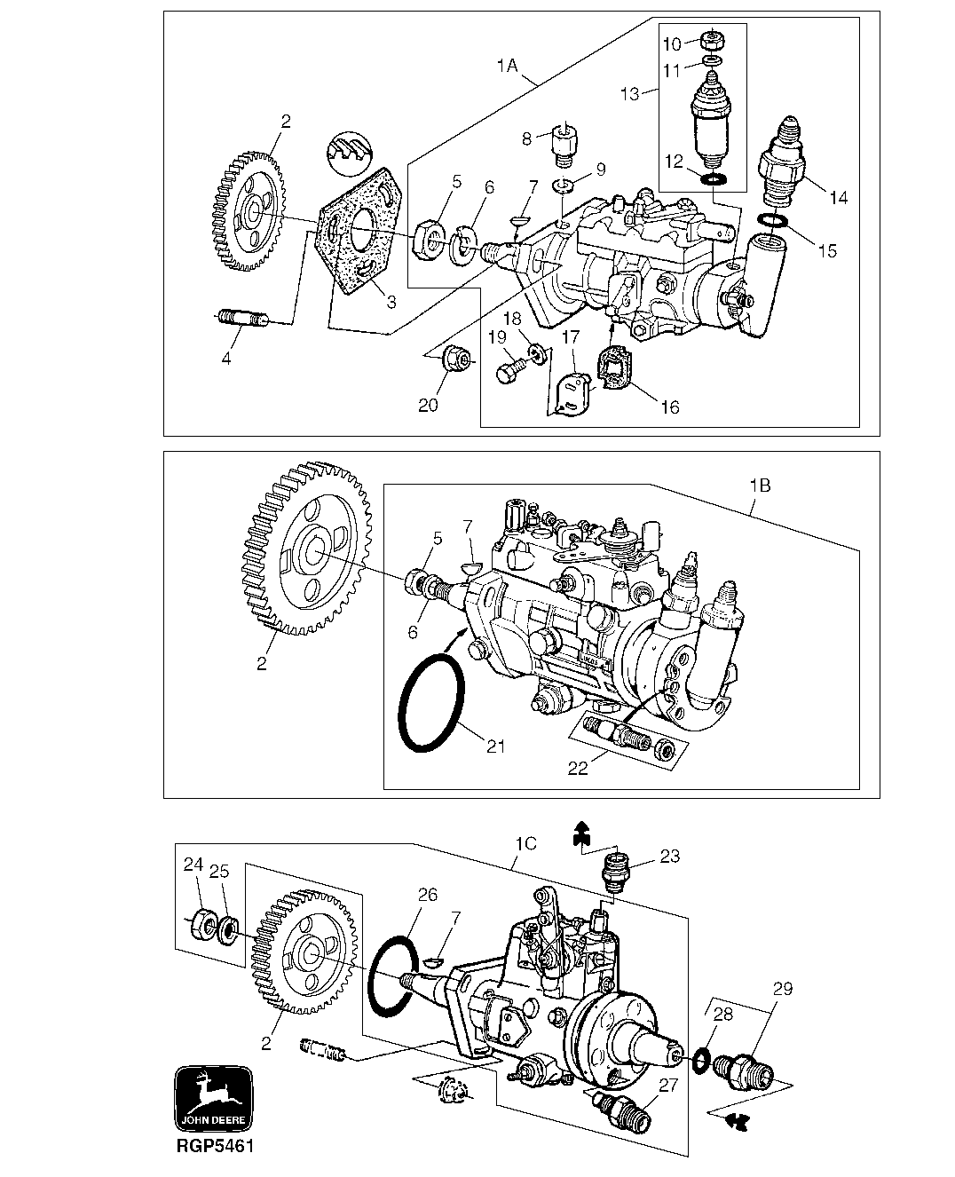

If after fuel filter change and it still won't run correctly then it's possible fuel inj pump fitting(parts key 8) which is a valve is plugged. Engine dying then starting running a short while then dying then starting is a typical symptom/
