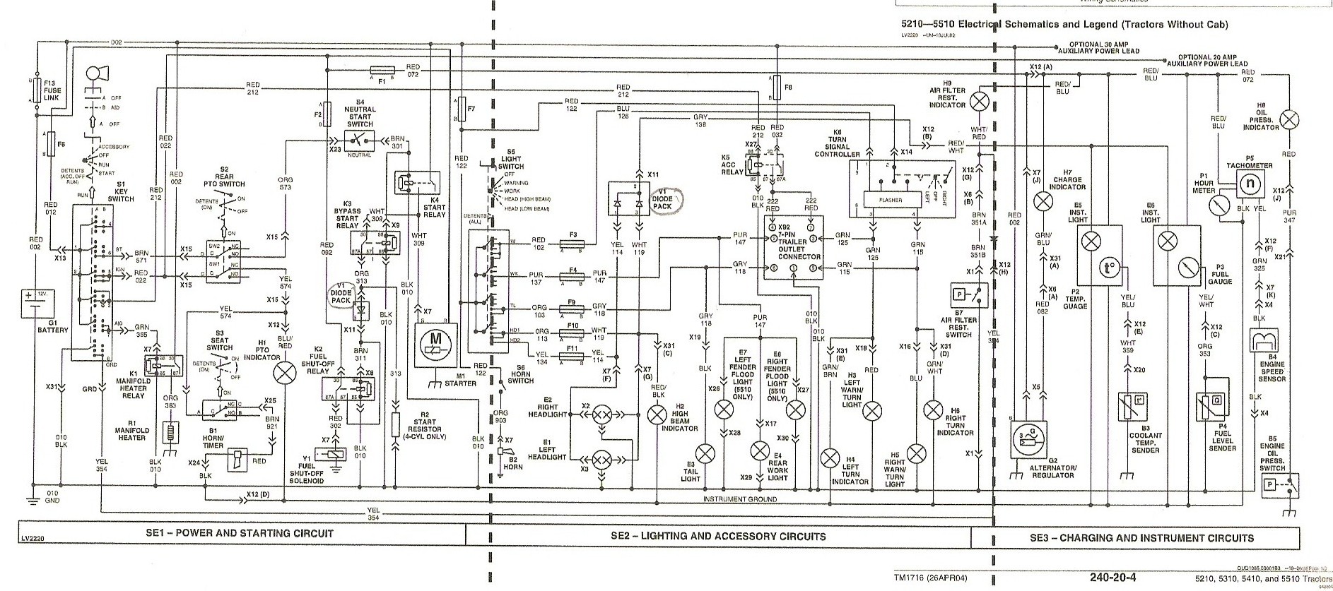

I recently bought a '97 John Deere 5400. It is equipped with what I call the "A-B-C" transmission. There are very few issues with the machine, but the dash light for "P" or Park won't light. I don't see a true brake lock on the tractor and believe it is suppose to light when the transmission is in the "P" position. Also, the PTO dash light won't light when the PTO is engaged, I assume that is what it is for. Also, when the headlights are turned to high beam, the high beam indicator on the dash lights, but the headlights are dark. A great tractor overall, but I always want everything to work, so I need to track these things down. I did notice that the seat safety switch is unhooked, wonder if that could affect the "P" park dash light?
   / John Deere 5400 #2
I take you did not get an operators manual with your tractor. I own a 5210 and I believe on the 5X00 tractors as the 5X10 tractors, the Park indicator is there just for show ie it is none functional. I attached the page from my operators manual on this, note the last line.
Please note you MUST be stopped before putting the gear shift level in the park position.
On the PTO light, I would guess the bulb is bad. If the tractor will not start with the PTO on, then the switch is good. If you take off the left cowl, you should be able to reach the bulb.
Oh high beams a few things to check, the fuses, light switch or diode (part number RE170320).
All the switch under the seat does on my 5210 is sound an alarm, when you get off the seat and the PTO is turned on.

JD5210 is right, the Park Light does not turn on. Even in the Park range.
