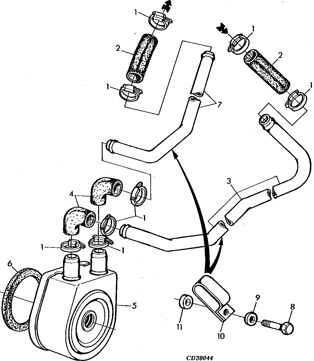

I have a John Deere 5320 tractor and there is oil in the radiator , has anybody had this problem with there tractor. Thanks and Merry Christmas!!!!
   / John Deere 5320 #2
Doesn't sound good. Can you give out some history of the 5320.. Things that have been done, and that have not been done for maintenance.
Also hours on the engine, location in your profile helps, any change in engine power over time?
All can help to advise you what may be happening.
   / John Deere 5320 #3
First guess would be intake manifold gasket or head gasket leaking. Not sure if the intake has water going Through it on that model or not.
   / John Deere 5320 #4
CD39044________UN01JAN94.gifMy first guess would be possible engine oil cooler leak. Could be a head gasket or cylinder liner also. Is there any sign of coolant in the oil? I would recommend removing the oil cooler and having it pressure tested.
