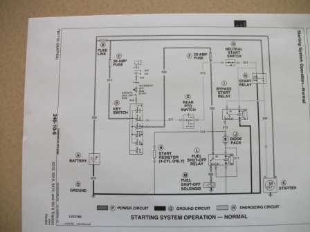

I replaced the fuel shut off selnoid, then the fuel shut off relay, then the small square relays in front of the steering column, and still not working! The crazy thing is that it will start out of the blue and run fine,then go through 5 or 6 start cycles perfect, walk away and come back and its back to same old story. Also replaced the key switch. thanks for the help

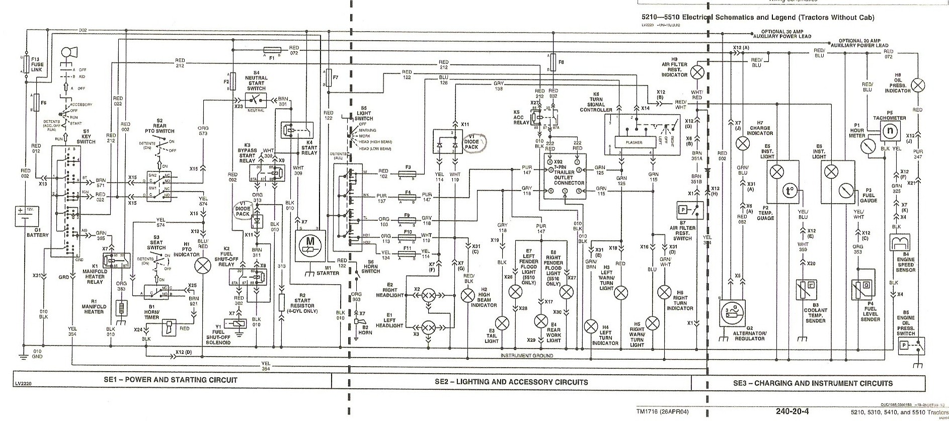

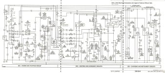

I have attached the wiring diagram and the starting system hopefully this helps.
How I would address this. It is most likely not the problem, but disconnect the cold start advance just to take it out of the picture. When it happens do not touch the key. Then work backwards starting at the fuel solenoid to determine where you do not have power. As already suggested test the 20 amp fuse that is for the fuel solenoid or just replace it.
Write-up from the tech manual.
When key switch (D) is turned to START position, current flows through 30-amp fuse (C), through contacts of key switch and out circuit 571. Current then flows through rear PTO switch (E), circuit 573, and through neutral start switch (G). Current leaving the neutral start switch travels on circuit 301 to both the start (H) and bypass start (I) relays.
Current passing through start relay windings creates a magnetic field, which closes relay contacts. This
connects circuit 002 to 309, providing a current path to the starter S terminal. The starter (K) then cranks the
engine.
At the same time, current travels to the bypass start relay on circuits 301 and 309. Current through circuit
301 creates a magnetic field in the windings of the bypass start relay which pulls its relay blade into contact with terminal 87. Current flow then stops on circuit 309 because of an open circuit between relay terminals 30 and 87A. During normal operation, fuel shut-off relay (L) remains inactive. However, circuits 302 and 092 are connected through normally-closed relay contacts between terminals 30 and 87A. This energizes the fuel shut-off solenoid (M) and allows fuel flow through the fuel injection pump.

I note in the full wiring diagram provided by JD5210, the presence of Diode packs in various locations throughout the wiring harness.
JD more than any other brand I know, goes to great lengths to protect their tractors from their owners :)
My experience in the JD line started with helping the owner of a JD5055D so keep in mind I am not a multi year JD expert.
The diode packs are present, to protect circuits from say a reverse battery jumping.... wrong cable on wrong battery terminal. A charging mistake in the same vein.
This illustration of a relay panel on a similar JD will get you looking for the right thing. i.e. where these diode packs are located.
This is the test procedure:
In the end the problems in the 5055D were related to a temperature sensor of some type. Unplugging the sensor lead removed the problem in the short term.
