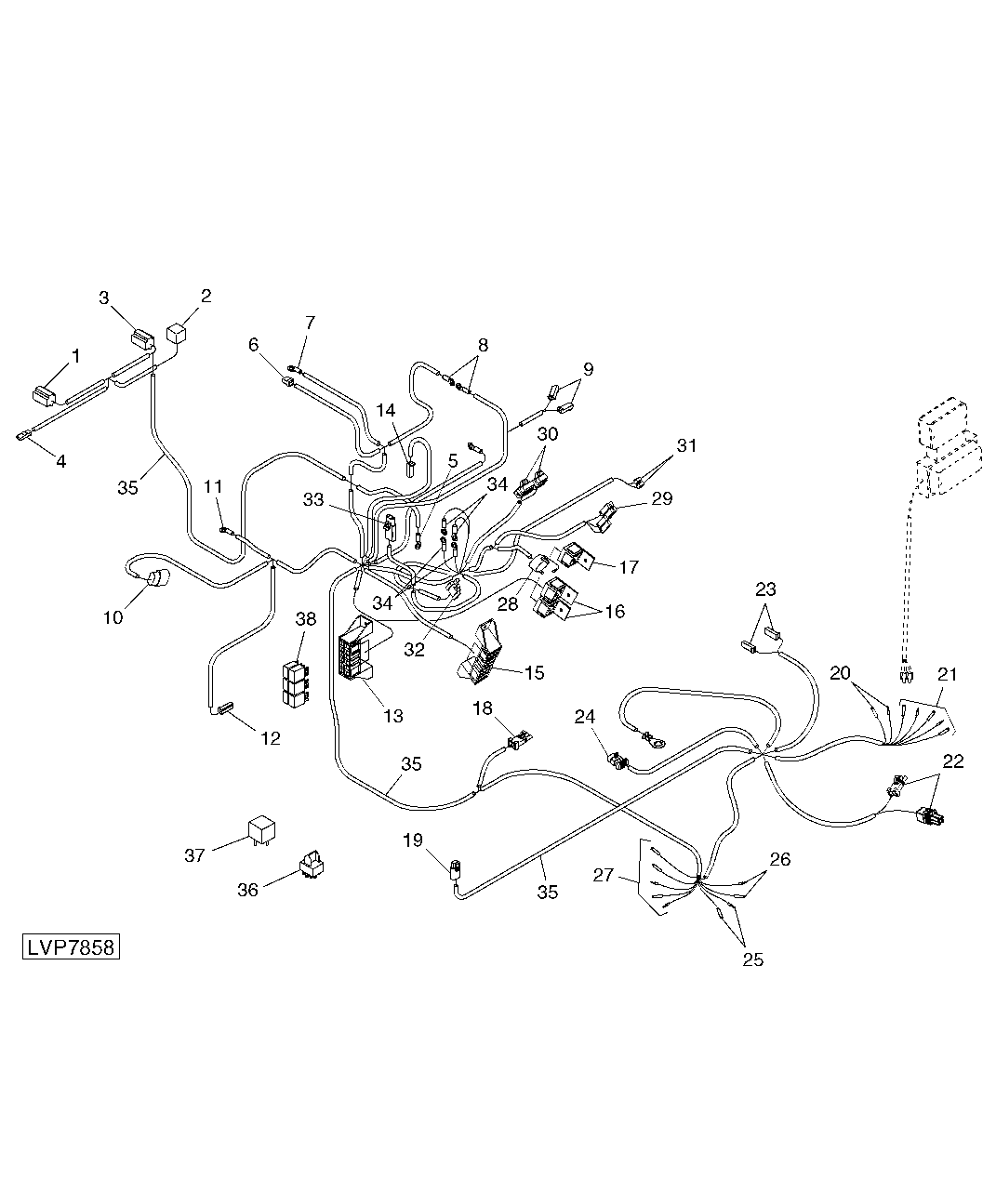

Check the battery ground cable where it attaches to tractor frame. I don't see a chassis connection on wiring harness(parts key 35)
