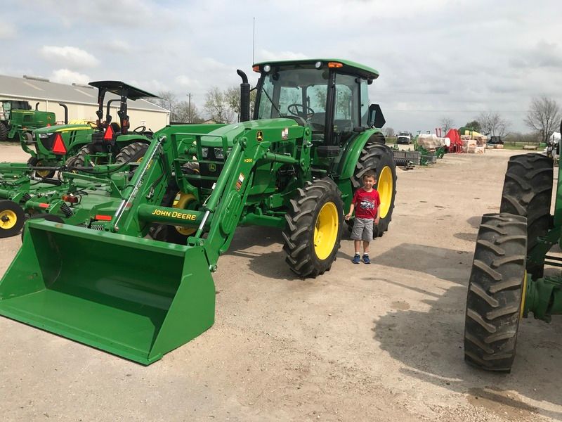

I have a brand new 5100e, ordered in oct '16, came in February. I shopped around between kubota, Deere and case. Case is the best bang for the buck but to me was flashy and that felt cheap. It has a big tractor feel but there was just something about it I didn't trust. I was looking at the 120 too. For the kubota, it was the m5.115 I think. Hated it. Drove it around the yard and was beat to death, and ergonomics was off for me. Really didn't care for it...lots do, but it wasn't for me. Then it was the Deere. Love the fit and finish. Air ride seat was comfortable and all the controls are right at my hands. No reaching behind for a remote or 3pt. Was conveniently layed out and the Deere just looks good to me. So far, it only has 13 hrs on it but it's awesome. For sure get the 24/12 trans. Great for running a batwing and I'm sure it'll be good for plowing.
Good luck in your decision
Brett
