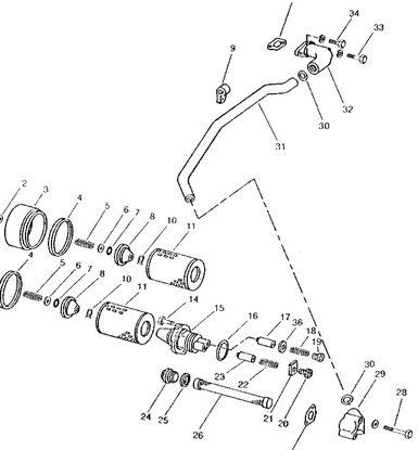

need help i have a john deere 510 . the hydraulics for the back hoe are very weak and the front end loader will barely move at all.
   / john deere 510 #2
have you checked to see what condition the hydraulic fluid is in? do you know if any of the filters have been changed? From memory these filters are kind of buried up under the floor boards and somewhat difficult to access.
   / john deere 510 #3
st thing to do is check hyd level then change hyd filters which are cheap from JD and check/clean sump screen(key 26). Then check hyd stand-by pressure. 2 ea-AR75603 Filter Element - ELEMENT,OIL FILTER ADD 8.31 USD 16.62 USD
   / john deere 510
New fluid but haven't changed filters will do that this weekend
   / john deere 510 #5
Did you check pressure and change the filter?
