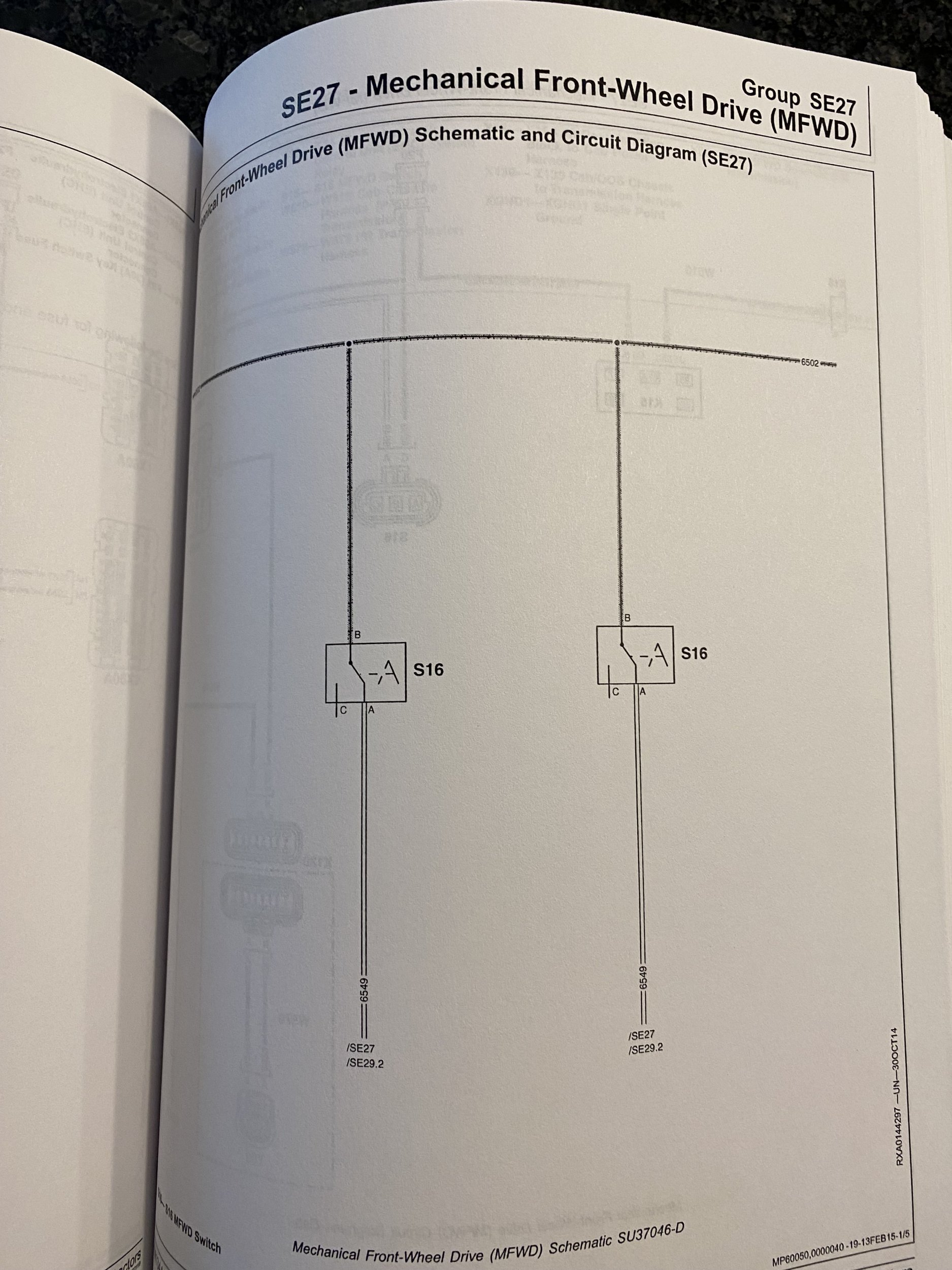

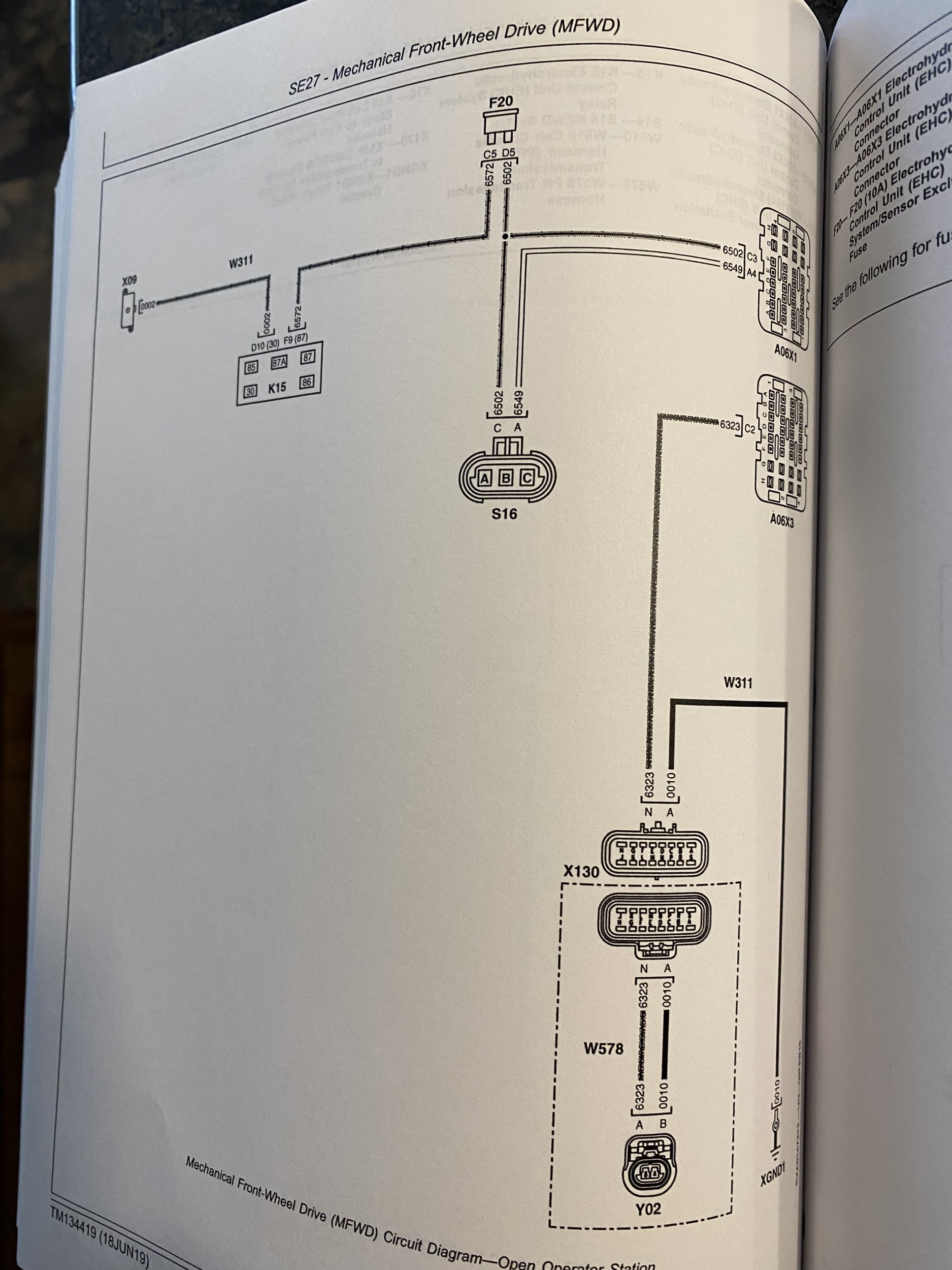

I have a 2017 John Deere 5085E. The 4wd light on the dash, is on constantly. (Was like this when I purchased it). Regardless of where I position the switch, it will not disengage. I realize that 4wd is the default for these tractors, and that the solenoid requires power to keep the tractor in 2wd. I've checked the obvious - no blown fuses. I have power at the 4wd switch on the console, and tested the switch (its good). I have however no power to the solenoid. The plug to the solenoid is 2 wires. I've tested continuity on the ground side of the plug, and its fine. However I cant seem to trace the hot side once it goes into the cab. Also read where there is a controller for the dash light..?
I've had no luck on a wiring diagram/schematic. Curious if anyone else has fought this same thing? Assuming the wiring is probably the same for the 5085/5090E/5100E?

I'm betting there's more than just "a relay". I suspect there's a computer somewhere as well, brake pedal switches, the 2/4 WD switch, and possibly even more. Just because you turn the switch off and on doesn't mean you're actually sending signal to the solenoid valve.

This is from a newer model 5090 or 5100. It looks like the signals are inputs into and out of the EHC unit. K15 is the relay for the EHC so that could be an issue but probably something is going on with the EHC.
