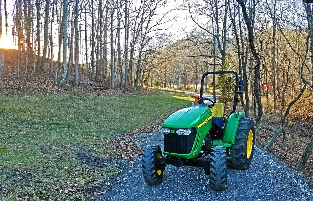

They're still selling the 4105 here. When did JD drop them? (sorry to thread-jack)
It is "on" deere.com,, but, when you try to "build" it,, the 4105 can not be found.
There are plenty of new ones on dealer lots,,,
here is my obsolete antique,,, a 2013 model year.
Well, to be honest there's not a lot to 'build' with the 4105. It always was a bare-bones, nothing 'pretty' or luxurious tractor. About the only option you can add is the 300CX FEL, but that was/is the point of it.
Oh yeah, where's your LH Indicator? You haven't broken it already! :shocked:
