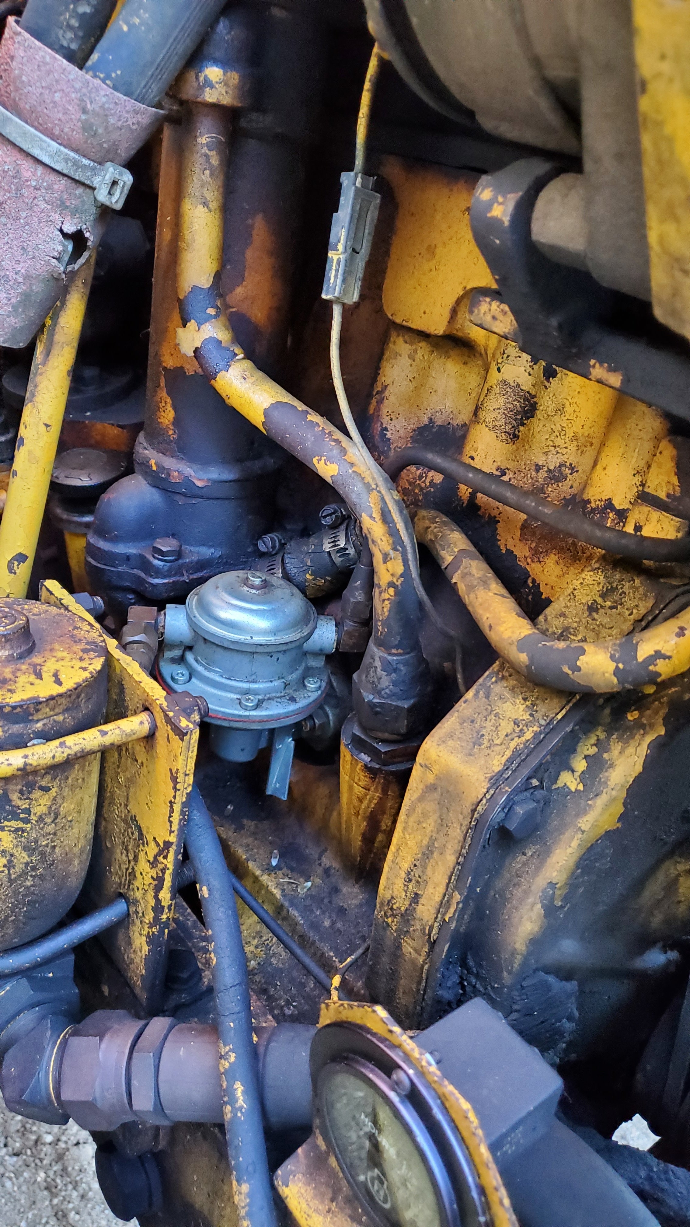

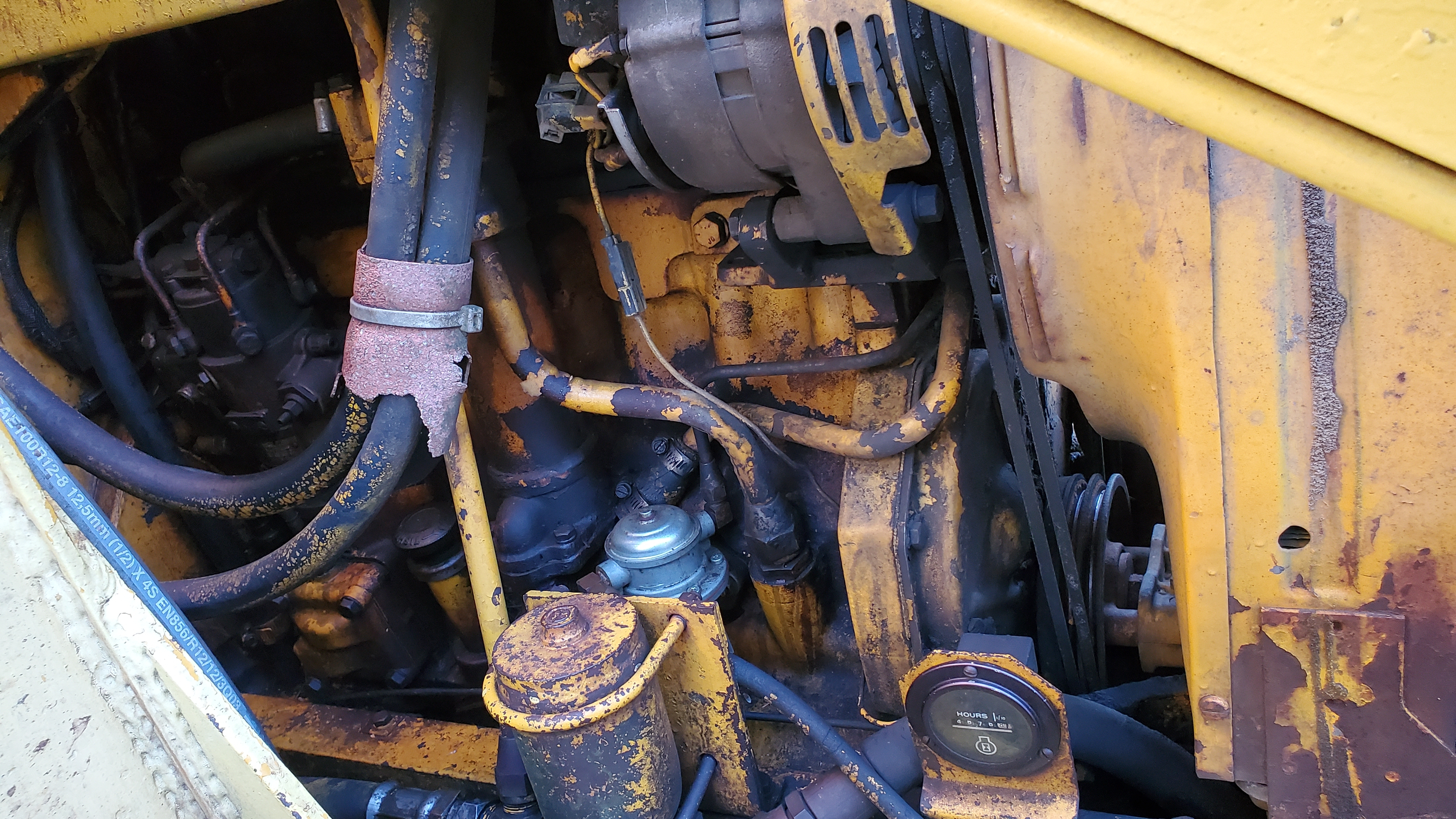

The fuel transfer pump was replaced by pervious owner one year ago. Not sure the reason why, or what happened to old one. It's the silver piece in this pic that he replaced.
Or like I said to Thepumpguysc, maybe Install better petcock and perhaps the rest wouldn't matter. Well, only if fuel is bypassing plastic valve while engine is off. If it is making oil while running will certainly have to dig further into lift pump or injection pump. I haven't wanted to run it to find out with diesel in oil.

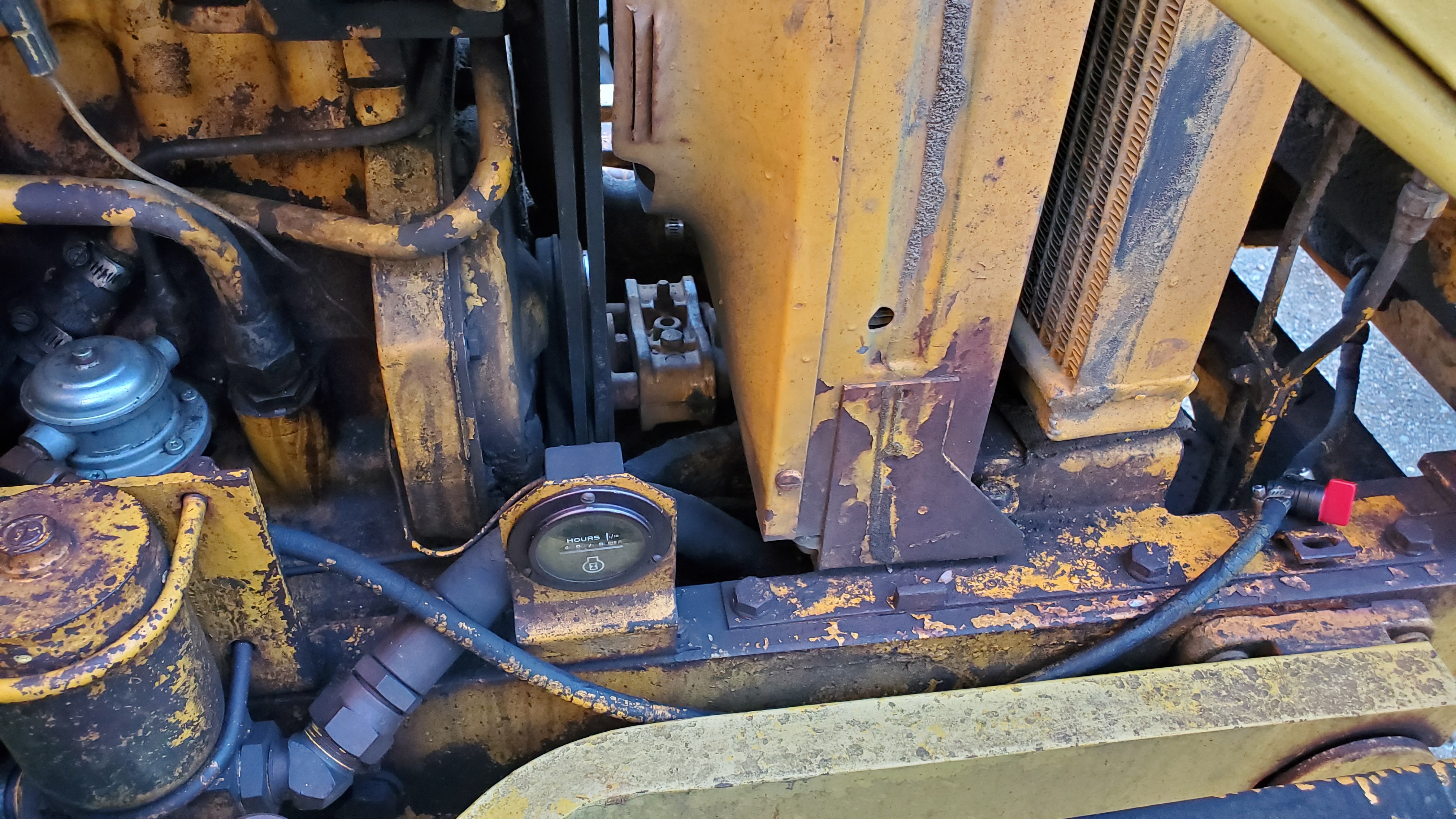

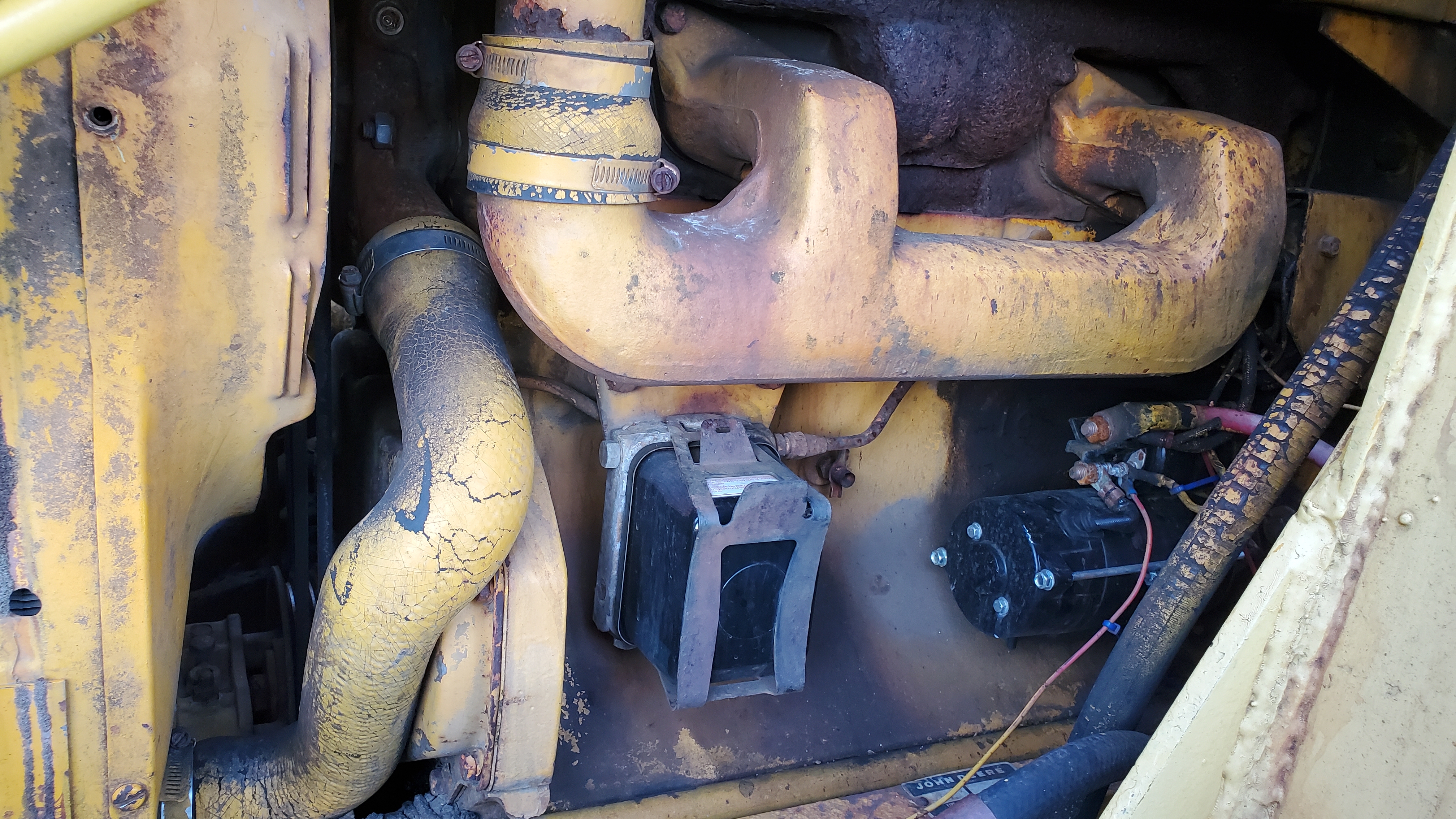

A couple more pics for reference..

Fuel line shut-off valve if operating correctly should stop fuel from entering engine crankcase while engine is setting idle IE not operating BUT valve will have no affect on the problem while engine is operating. In today's world of "almost right parts" I would be checking transfer pump to determine if it was the cause of fuel in crankcase. Another option is just disconnecting fuel transfer pump & installing an electric fuel in it's place. If it wasn't the cause then R&R umbrella seals on inj pump shaft. You definitely don't want engine oil thinned by diesel destroying your engines crankshaft bearings!!!!!!!!!
