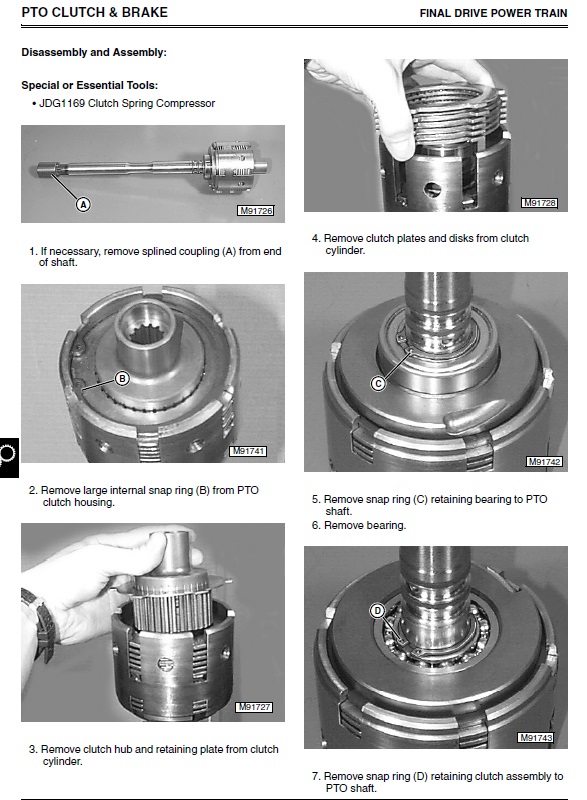

Best I can offer is a page out of the service tech manual.. suggest would be good manual for you to have, based on what you have said and what you expect you will do next.
Have also added the first of six pages outlining the disassembly for an idea what you may be in for... could add the other five if interested.

Thanks for the reply and the pages... I have ordered the technical manual I believe is the correct one for it TM1679. Sounds like I may have my work cut out for me splitting the tractor but the rebuild of the clutch itself doesn't seem to bad. Any info on parts from a third party source Vs. JD? I have done some research but can only drum up good resources for older tractors.

I would be interested in seeing the pages for splitting the tractor

I have split a few 4 series but hydro its pretty easy - my only words of wisdom take the loader off ,and 2 floor jacks - get some long bolts and cut the heads off for easier lining up , don't force anything it should roll back together
   / John Deere 4700 PTO spins but slips under load #8
My dad and I have split several, it isn't the easiest job in the world but it isn't as difficult as one might think. Taking the loader off will help though we have never done one that had a loader on it.
First step is to put wedges between the front axle/axle housings and the axle support so the engine portion won't rock to one side. Start with a clean floor so floor jacks will roll, do not get in a hurry and take your time.
What we have done is to stack wood blocks and boards under the engine portion and we just leave it static, we do not roll it. The rear portion we place a floor jack under it and roll it backwards once everything is unhooked. The long bolt idea is a good one but we've never done it, I think a piece of threaded rod would work to as well as maybe just a steel rod. To be honest we've always been successful rolling it back into place.
