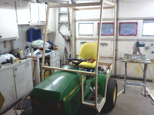

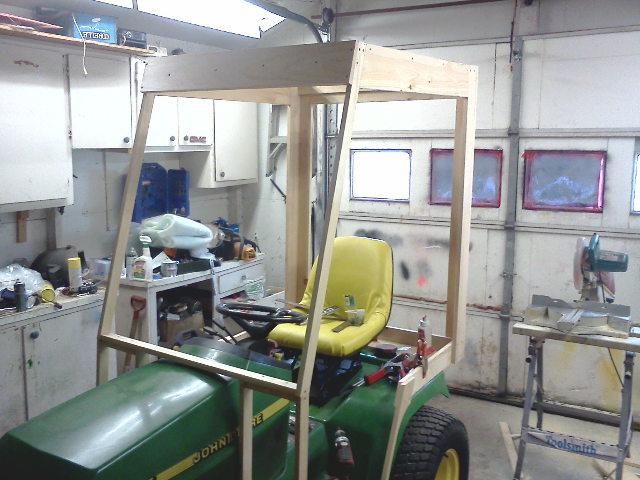

This is my John Deere 455 cab build. I built this cab to keep out the cold and keep me nice and warm. I just started building this November 1 2014. I built it out of 1 inch pine and covered it with truck bed liner. I got the glass out of the junk yard off some old storm doors for the front and back glass. I not sure what the side glass was out of but I made it work. Hope it help's other's to build there cabs.

Good looking build.
How will you open the hood to service the engine?

/ John Deere 455 Cab Build
I can lift the front glass up to get full access to the engine. The cab is not done yet I still have some little things to do heater, door latch, over head lights, and flashing lights.

/ John Deere 455 Cab Build #8
Appears there is a piece of wood across the top of the hood, but you say that lifts with the front glass so that should work. Nice build.
