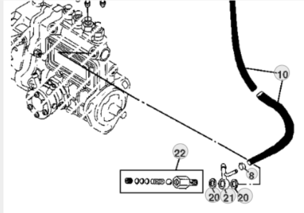

I'm not sure this applies to a 4500 with a Yanmar engine but I know it applies to older JD engines that the fuel return line has a valve(key 22) that can get stopped up with debris that cause engine to only run for short periods of time. It would be easy to check by just removing hose from valve & leave hose open to see if engine will run longer

Ah! Well, I just think it would be nice to have a gas gauge that WORKS (and she would like that, too, instead of guessing how much diesel she has to do HER stuff all the time). I figure, while we are cleaning the tank, why not change the float out... But... maybe it is too much trouble? She is not thrilled with the thing getting run dry, is all.
Thank you for the pictures! There are some others earlier in the thread where I can check for clogs, too. I'm with you on the clean fuel throughout the system idea...
