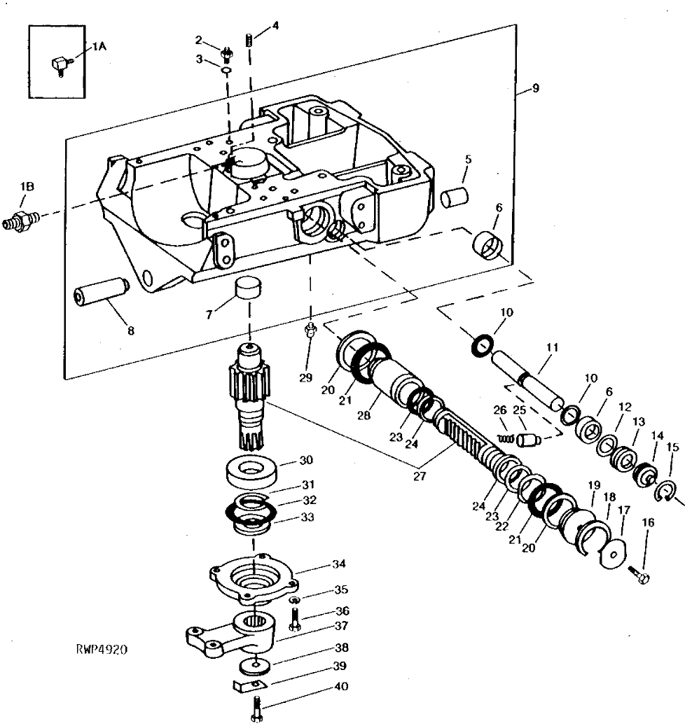

tracter steers fine to left but can hardly turn right
   / john deere 4430 steering #2
SN of tractor below or above 027635??? There were 2 different type steering valves on a 4430. Possibly has a blown o-ring in steering motor in photo at the front
