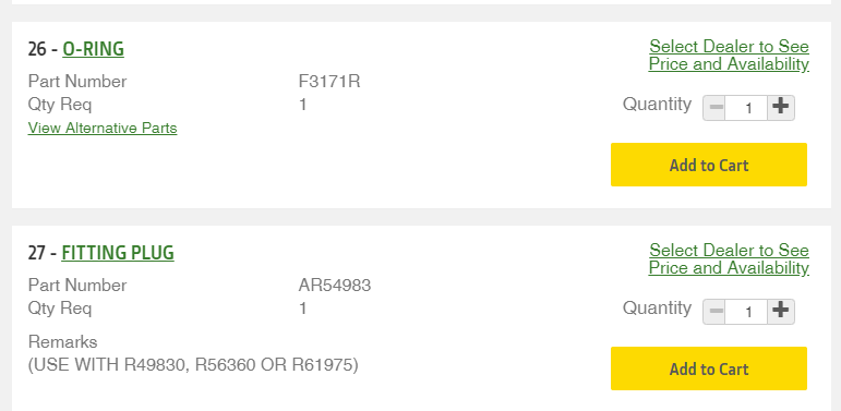

Hello, i have a John Deere 4430 with perma clutch. All hydraulic functions, steering, transmission, three point hitch are inoperative. My mechanic replaced the front hydraulic pump- i don't think he tested the pressure to this pump. Replacing this pump did not fix the problem. My mechanic says the next step is to check the shaft (#25 in the drawing) to see if it is driving the transmission pump. In reading the service manual, the manual says to remove the center link attaching bracket, and pull the shaft through the pump. My question is, if you pull this shaft out, is there a fitting on the end where the shaft engages the crankshaft? i am worried that by removing the shaft to inspect it, that i will not be able to get the shaft back into the fitting that engages with the crankshaft. Are part numbers 26, and 27 attached to the crankshaft housing? Thanks, Carr

There is a hex slug drove into the crankshaft on the front. The slug will not come out by removing the pump drive shaft. Items #26 & #27 are at the back of the tractor under the 3 point top link mounting base. After removing the plug, pull the driveshaft out of the rear of the tractor. It is a 3/8" diameter hex shaft. Inspect the front of the shaft (drive area) and the middle of the shaft (pump drive) for wear. You will be able to reinstall the oil pump drive shaft with a needle nose vice grips rotating the shaft during installation. The shaft will stop rotating once installed into the crankshaft drive slug. Then reinstall the plug into the back of the transmission case to retain the driveshaft.

I suggest checking the hyd filter relief valve to be sure it's seating & not stuck open. Slimy looking oil indicates presence of water in hyd reservoir. Check to be sure hyd filler cap breather isn't clogged. After removing centerlink attachment & hex cap/o-rlng(ITEMS 26 & 27 in op's photo) briefly spin engine crankshaft by engaging starter to determine if trans pump shaft turns with engine CS. It's difficult for me to comprehend that I sold JD 4430's when they were brand NEW.

the hex shaft was found to broken right where the shaft goes into the pump. My mechanic was able to get all or the shaft out luckily. So now we have to replace the pump and the shaft. thanks for all of the advice.
