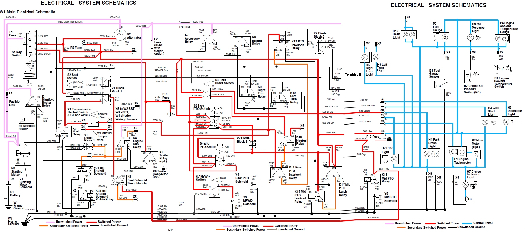

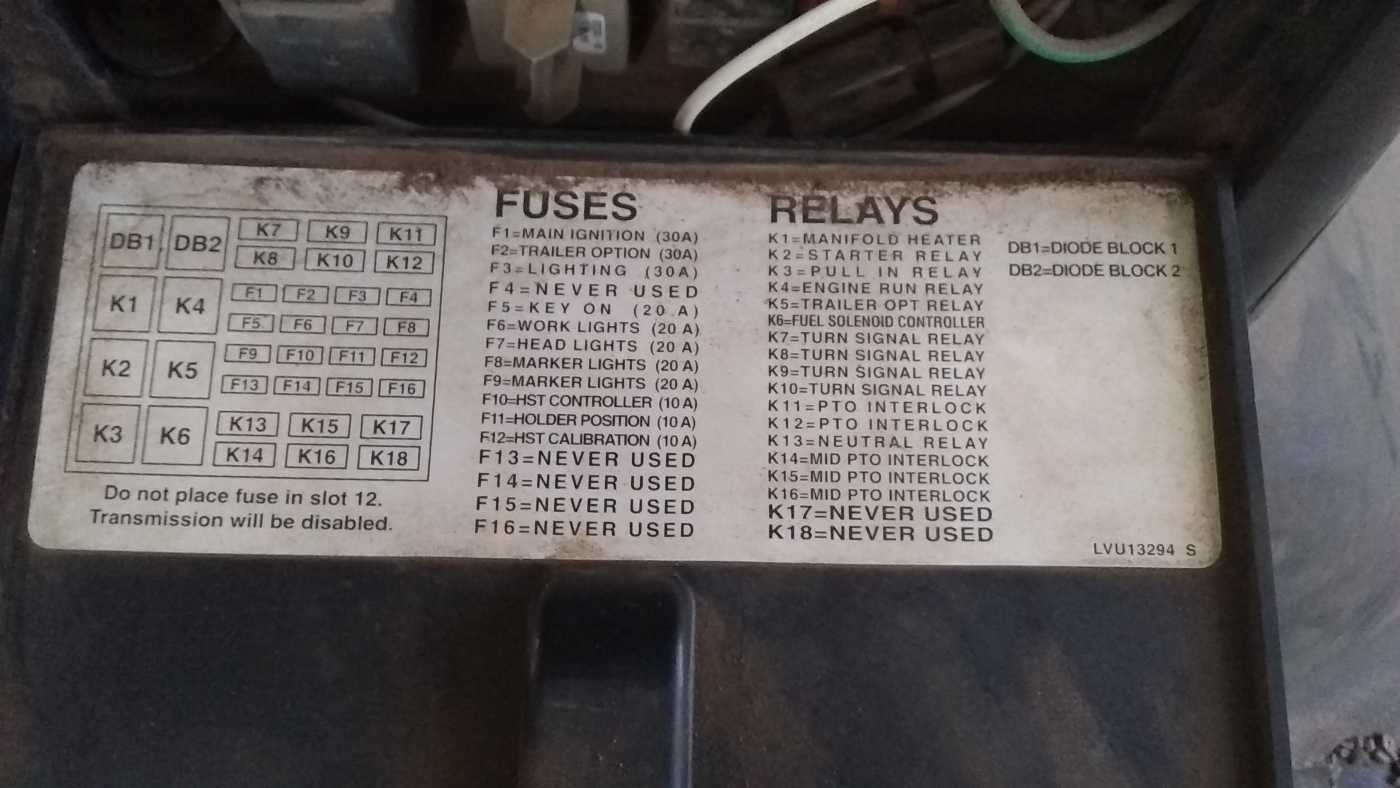

I have a John Deere 4310 tractor, it keeps shutting off in the middle of cutting grass. Fuse 5 keeps blowing. Have replaced water pump and thermostat without any changes in the way it runs. Any ideas what could be causing this?

F5 might be a buggar to trace. Here is a list of all the connections to it. If it is only blowing when you are mowing my guess would be something the PTO circuit. Do you have a mid mount mower or just using the rear PTO?

Here is the wiring diagram. F5 is in the top left area near the alternator symbol. You can right click and save this to your computer to blow it up and scroll to the different connections.

All of the K7 through K16 relays are the same. Try swapping the turn signal relays with the PTO relays you are using. If you don't have mid PTO you won't have those relays in your panel.
Thank you sooooo much!! I will do my best to investigate this!
We do not have a mid PTO. Rear only. What would you recommend doing first? I am a novice!
   / John Deere 4310 electrical issue - I think....Please help if you can #8
Is the fuse only blowing when you mow?
Try swapping the turn signal relays with the PTO relays.

Thank you. Will the turn signal relays be in the spots you listed even with a rear PTO only?
