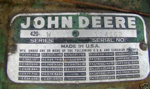

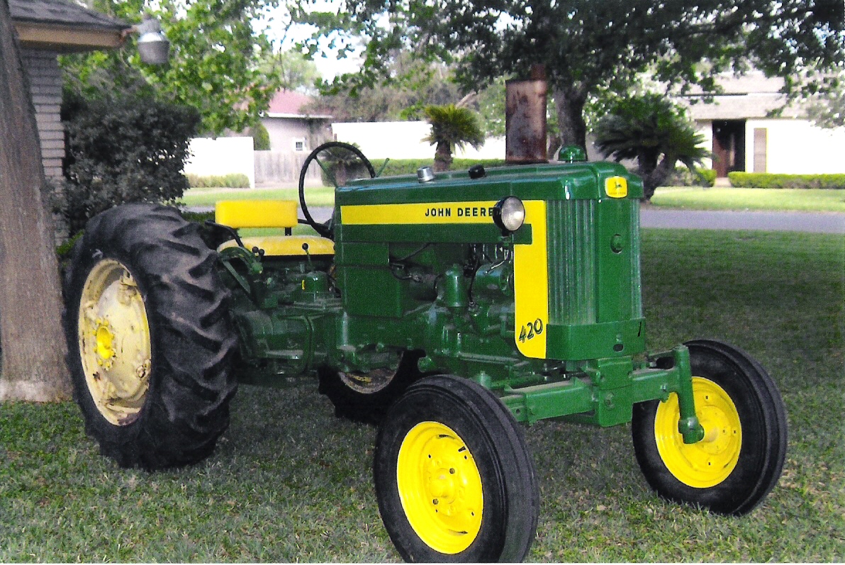

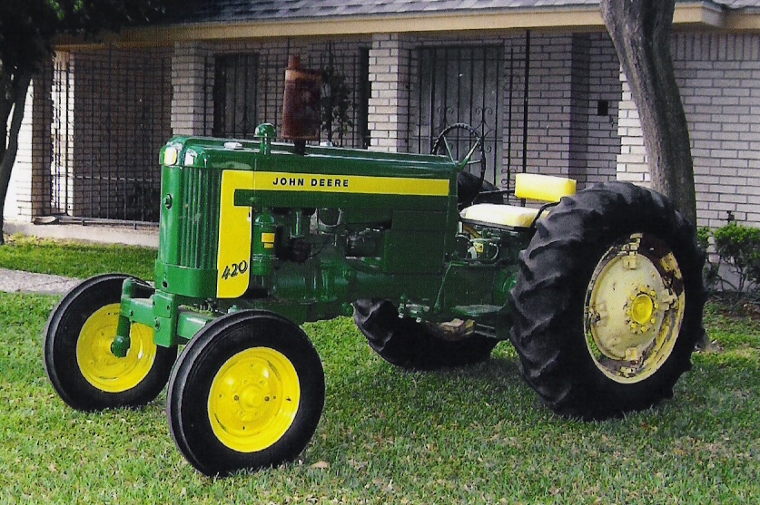

Just added this one to my collection, I do not have a service manual so I really other than adding fluid to the resivoir under the seat I am not sure where to begin as far as troubleshooting, It will not lift, it's dead, when engine is running clutch engaged or not engaged, driving or idling still, pulling black knobs #1 and #2 back and forth, hear no pump noise, cannot see fluid in the tank port as of yet, does this tank need to be filled to rim? the cap does not appear to seal tight so I was affraid to fill to rim.
