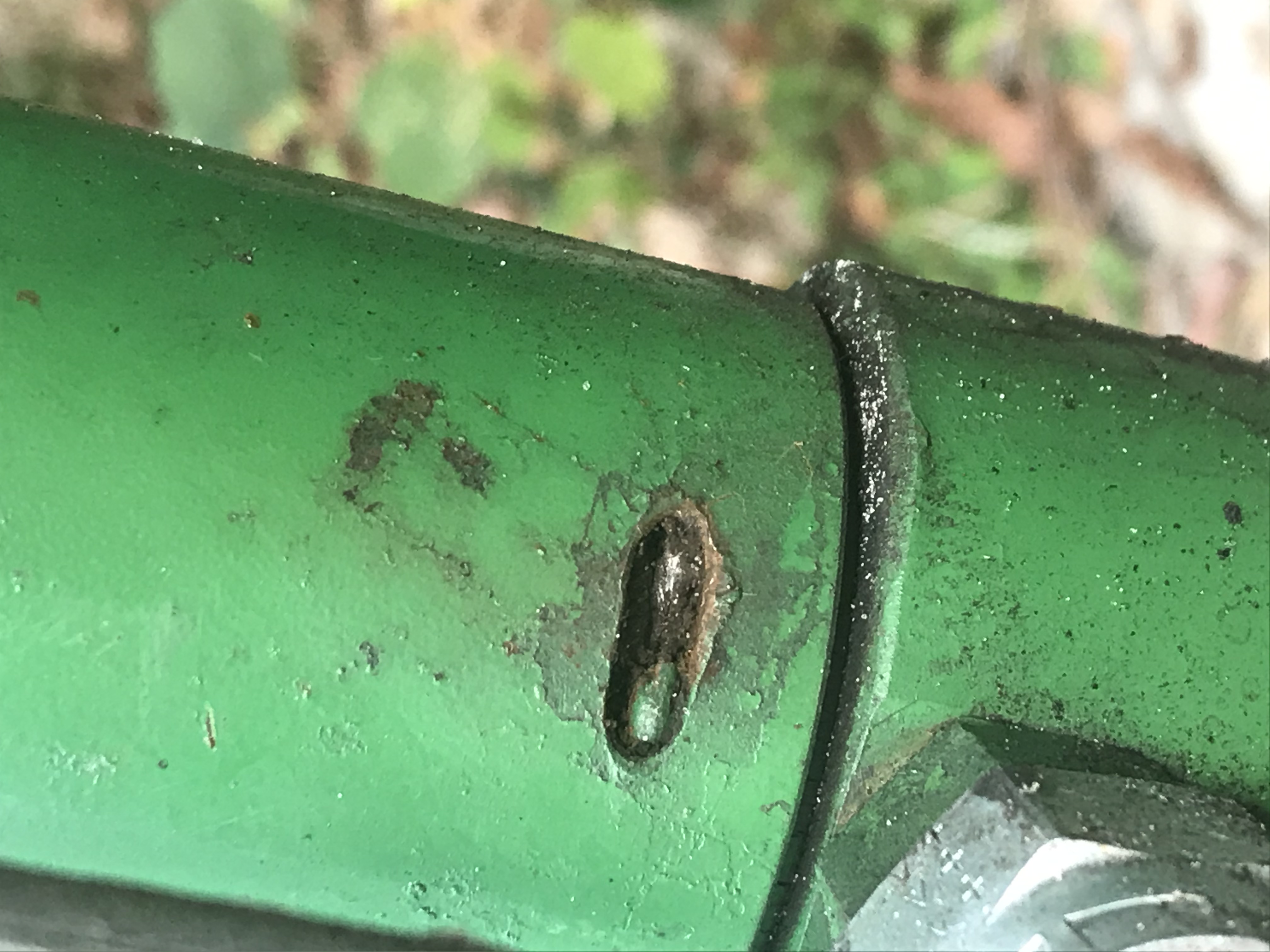

I have a 420 loader with serial number 9759 with a bucket cylinder that is leaking through the small hole in the side of the cylinder - see attached picture. Based on the parts diagram, it looks like this hole is where the Tie Band/Wire lock is inserted, but this is my first cylinder rebuild...
A couple questions:
1. Is it normal for a leaking cylinder to leak through the wire lock hole in the side? Is that an indication of larger problems, or just need a rebuild kit?
2. I found a lot of rebuild help for the spring clip-type cylinders, but struggling to find instructions on how to open up this one with the tie band/wire lock.
   / John Deere 420 loader cylinder rebuild question #2
I think you'll just need the rebuilt kit. Nothing major other than old seals that are starting to fail. The reason it's leaking there, is because the O-ring sealing the gland and the barrel failed.

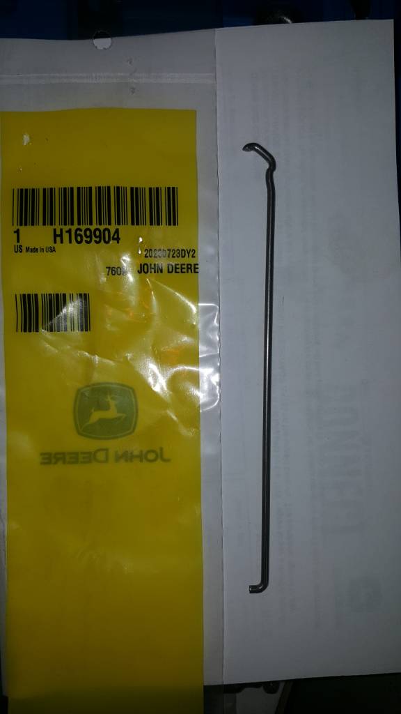

jthibodeau89 - curious, the new lock wire in your picture has both ends bent. Which end is the end you start with to feed in? I thought one end was bent, the other end should be straight?
The single 90 tang at the bottom of the photo is placed into the counterbore in the gland to feed in the wire. The rectangular section at the top of the photo is the lock that sets orientation. It's length matches the slot in the cylinder.
