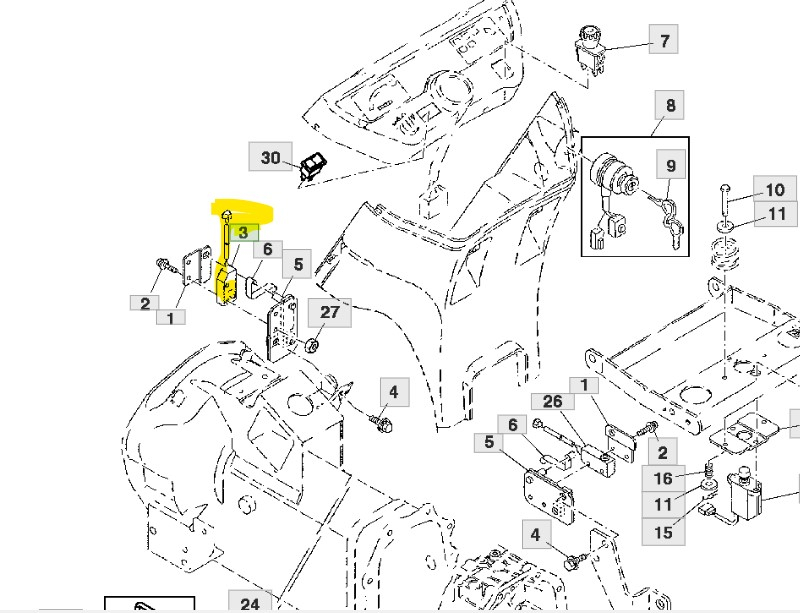

Good Afternoon
Can anyone please tell me where the parking brake switch is located on a John Deere 4110?
Either I need a new switch or an adjustment on the parking brake. The parking light on the dash continues to blink after I release the parking brake.
Thanks,
Eric
Louisa, Virginia
   / John Deere 4110 parking brake switch location #2
According to parts book, it is under the dash cowling. #3

You need to get your self a parts list so you can
find anything you need also shows how things go
together so you have an idea how to disassemble
and part number so you can get the part you need
